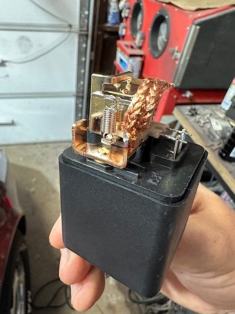

if it’s a true brushless PWM fan then no relay. One less thing to fail. The controller is the relay. I don’t believe the 6th gen are brushless right? That’s tough but whatever the max current is I would double it. For the price of a 120-200amp relay on Amazon idk why anyone would use anything less. If your building it for max amps the use the appropriate wire as well. I put a 120amp relay on my walbro 450lph in tank pump. The +20amps on switch spike creates an arc which burns out the contacts over time in standard 30-40amp relays. The big 120-200amp guys use much bigger contacts.

just be careful those 30-40 amp style relays are usually rated at a lower number for the normal closed setting. So a 30/40 amp style relay is 40 amp rated at normally open (not activated) activate the relay to close it and the rating drops to 30amp. Even then at 20-24amps your more than 50% of the rated load and I would expect a lower life rating due to arcing on the contacts on activation. I’ve seen some fancy relays on Amazon $30 or so for a 75 amp with tungsten contacts and dual contacts to reduce the arcing during activation. I would swap those smaller relays out to something with some meat in them. I have used the 120-200 amp relays off Amazon with good success and the contacts are much bigger than the smaller standard relays. They are like $15 for two and have big 6mm/ 1/4” brass or copper studs. I’ve even opened them up to take a peak and there is a lot of copper in them. Your wire is up to the task if you did 8gauge so don’t get stranded bc of the relay. I try to double the capacity for a working load, so 30amps is 60amp minimum but for the price stick a 120amp on it and call it a day keep a spare in the trunk or glove box for a rainy day.

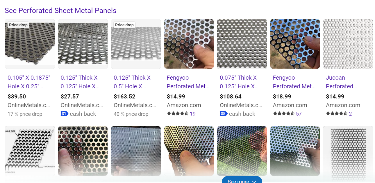

I'd look at installing some perforated sheet metal panels like the ones below, easy to bend up and mount with some sheet metal screws.
