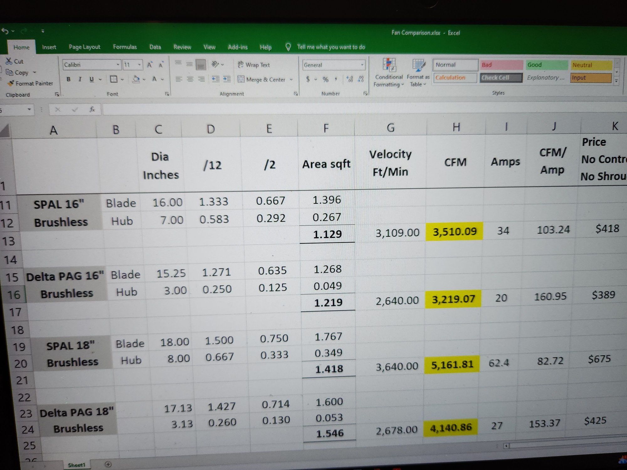

you gotta be the dumbest engineer I’ve ever seen… you work for ford?
first I post numbers, a video of your fan from you or a video of a fan from someone else is the same. Why is yours any different? You done mostly nothing but nut all over yourself. First your ft/min is 500ft/min slower than the spal at 16” and you’re so hyped about being 700ft/min faster than the proform why don’t u look at the numbers. You made your hub small and reduced fan air output to achieve a lower amp per CFM… congrats. And yet you still flow less even with a smaller hub? The spal will actually drop its amps as my tests are 12.6v but you’ve inspired me to test at running voltage I bet your amp difference shrinks. Spal also rates the fans at 13v and not typical 14-14.5v. spell it out for you in crayon…
16” spal 3109ft/min @ 3511cfm @ 34 amps at 12.6v
16” Pag 2640ft/min @ 3219cfm @ 20amps or is it 22amps? Do you even know what your website says?
here’s wat im gona do… I’ll take a video of the fans at the correct voltage 16” spal and the spal 18” with a shroud. That way you have nothing else to say. You must be really bad at your job (don’t worry we already know) as it’s taken me 30min to find all this.
here’s a sneak peak of the 18” at a low 11.3v and these go for $650 with a 6 gauge power harness. I paid $520 and no need for a controller as a Holley term x controls it or $60 widgetman controller if you don’t have an ecu that’s capable. Oh hey guess wat, 3 - 1/32” deep at the motor everything else is less deep than your fan. You couldnt get your fan that close to the core without a 1/4” deep shroud which is useles. So try again.
oh, would you look at that… the first thread on a search and the guy goes in deep on a spal brushless
https://dmctalk.org/showthread.php?1...-brushless-fan
This whole thread is spal and OEM- rock crawl/off road is the most demanding of a cooling system. You should
know it well bc you got no where with them. https://irate4x4.com/threads/cooling-fan-tech.24669/
oh look another site that has lots of info about spal and OEM brushless but NO info about yours. He even states he can’t find **** on your stuff. I actually spoke with him regarding your fans and his info is just hearsay as he’s never known anyone or seen anyone post info about your fans. https://www.240turbo.com/BrushlessFa...atingbrushless
heres a video
same guy tests the jeep brushless
12” spal brushless aux fan
Nothing here to prove but flow. Yours flow less given the same hole size, then you crank them up or trying to reach and that makes you look bad. If I bought your fan am I getting the 2800cfm or the sped up 3100cfm or the super sped up 3600cfm?
waiting on your wiring guys!? No wonder you take 4
weeks to ship anything. It should take 30min to run the wires judging from what I see in all the pics. Also since yours are all basically the same parts just in different fan blade and mount sizes.

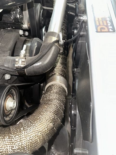

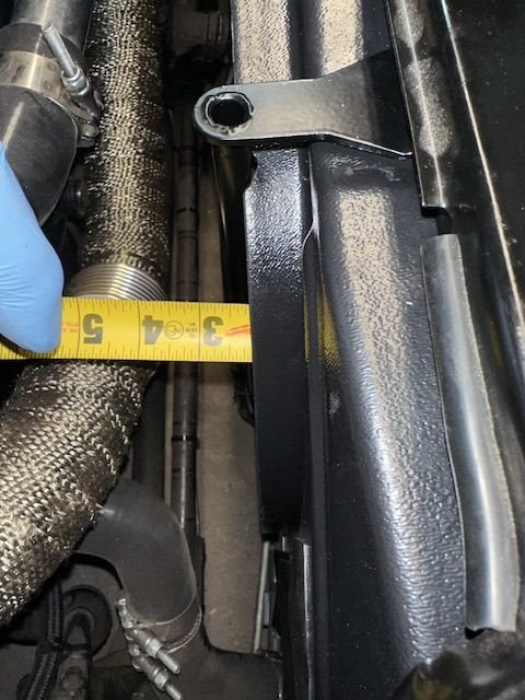

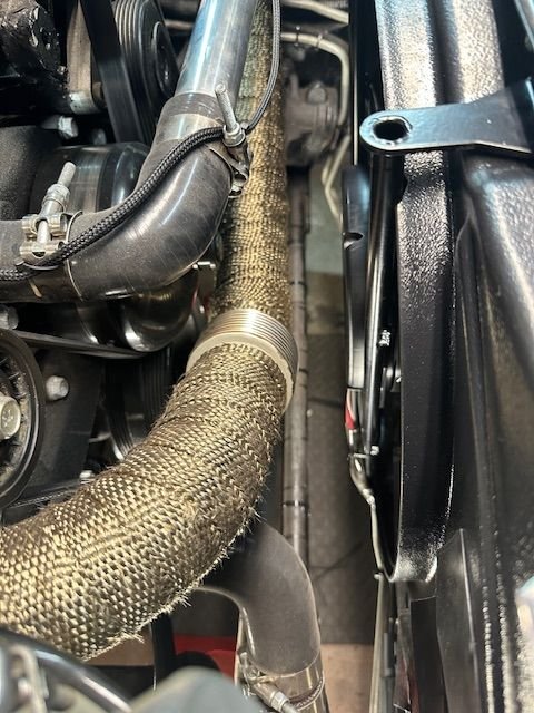

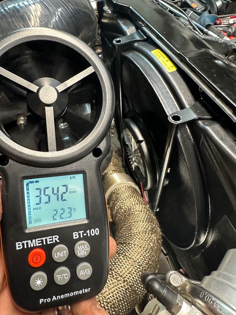

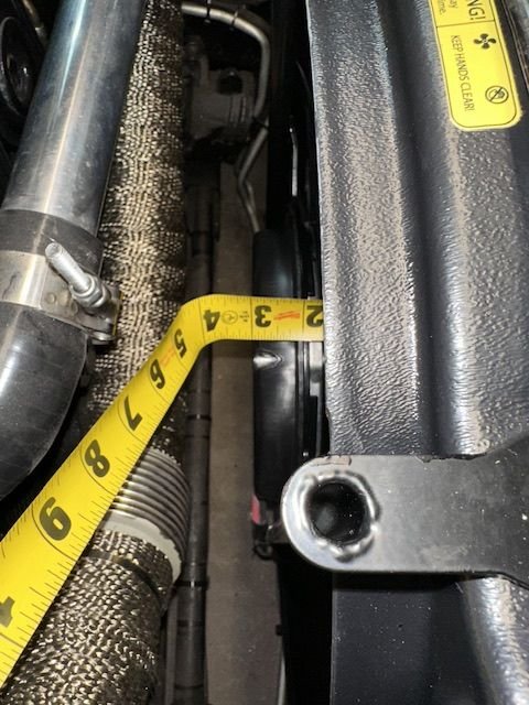

Well here you go. Spal 18” 850w on a shroud with the deepest part at 3”. Pulls 3640ft/min =5240cfm through a dual 1” rad core, a 1” trans cooler that covers the whole core and a 31x19x3” intercooler. with the engine running at 14.2v it pulls 62.4 amps at 100%.
with the spal 16” I wasn’t comfortable running the engine given the tight space and my chargers weren’t able to keep up so voltage dropped. I did manage to take a video. Pulling at 13.2v @ 2952 ft/min = 3332 CFM dual 1” core rad and 3/4” trans cooler at 35.5amps. Hard to get a good Reading while recording and saw a high of 3109 ft/min = 3510cfm right after when i had my other hand available.
Vintage air shroud 3” depth 28”x19core coverage tapers off towards the sides real good with high speed flaps. Very low profile I saved over an inch from the derale at the deepest point and more savings at the ends of the tanks.

post your flow numbers either way. I don’t think the PAG 18 will flow as much as the spal even with the restriction. I’m not removing to install on a traditional rad by itself. Flow numbers would be higher without as much restriction on the Spal but I am assuming your flow numbers match your claimed numbers. At least confirm that.
Only way for me to get 14+ volts would be to run the car up in the air but then I wouldn’t be able to see the other meters.
Be my guest on comparing 16” I just want data on the internet for people to find. A spal 16 brushed is pretty close as far as amps per CFM but it looses out on controllability and being able to adjust fan speed as the brushless. I also think the max CFM from a brushed spal 16” is low 2000s CFM which is not close to the 3300-3500 of the brushless fan.
the Chinese PWM controller is just for testing. I have full control over speed through the Holley ECM. Which is how I run it but for full speed testing the PWM generator is easier to use for full speed. If you don’t have a ECU there is a PWM controller for $60 from widgetman that will work with any temperature sensor including teeing into the one on the engine already. It offers full control with two presses of a button and controls most of all the PWM fans on the market. Just set the low and high point and it controls it from that.

We need to get accurate 16" fan voltage and amp measurements for the Spal 16 brushless. Cant you use jumper cables from the car to your test battery in that external setup you had?
Also, regarding your setup, you would have done much better with two 16" fans than the one 18". I really doubt you get much airflow from the rad corners or hub area based on how close the fan is to the core. Most likely alot of dead spots, ie low core utilization. Core utilization is equally as important as airflow, but I understand, you just don't have the room.
To do that cooling system properly would require a complete redesign. Hey if this works for you, at 65amps, there you go.
What's the retail price of the dewit fan and also the 16" fan? I'll modify my spreadsheet

2678 ft/min area 1.546 ft square = 4,140 cfm at 27amps

The 16" spal with shroud is $799 from dewitts which is more expensive than the vintage air 18". These 16" are popping up on FB marketplace for $250-300 with shrouds as I have seen 2 in the last 3 days. The best bang for your buck is the 18" tho no question. I didn't pay the $799 as I got the fan for $250 with a universal shroud/harness and the dewitts shroud for $180 which puts me at $430 for that combo which is controlled through 1 wire in my holley Term X so its super clean.

As promised here is the 16” spal 500w brushless on a Dewitt’s shroud on the dual 1” radiator with engine running. It’s tight and not really easy to get an airflow reading.

I wonder if the 16" brushed spal will be more efficient than the 16" brushless spal.
Also, to KFXguy's credit, let's add cost. With and without controls/shroud. Price is definitely a factor in a purchasers decision. A comprehensive cost analysis will be helpfull for everyone.
Cost of a DeltaPAG 16" without controller is $389, with digital controller & relay: $489, custom aluminum shroud adds $289. And no, the stupid Chinese pwm generator with **** is not a fan controller. What are you gunna do when the temp goes up or down? Run out in traffic, pop your hood to turn the ****? There are a ton of real fan controllers on the market, if they're good quality or not, that's for the consumer to decide. Let's use those for pricing
