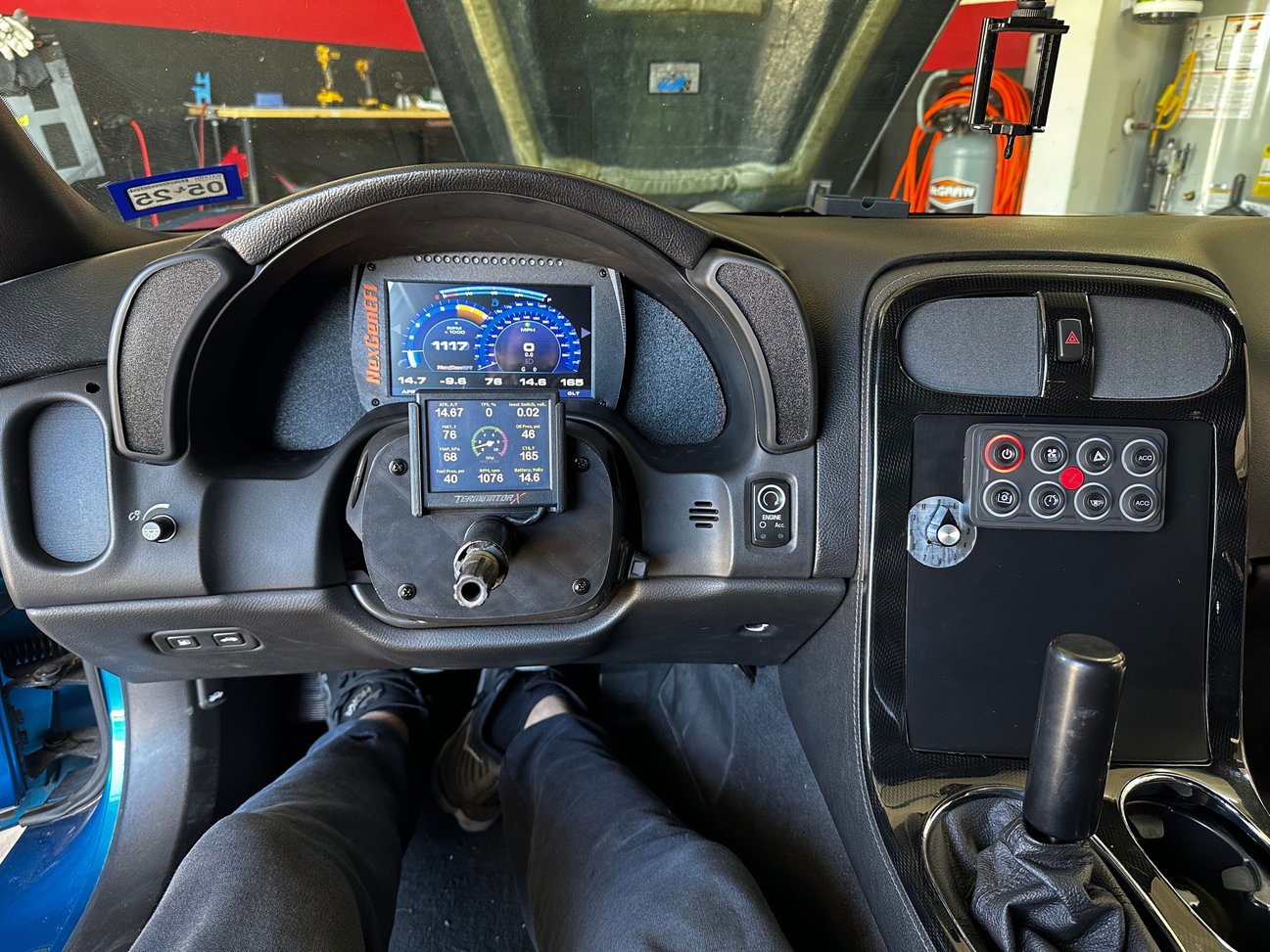

I've deleted the AC/Heater controls in mine and would like to fill the space with something but don't know what to pick.
Carbon Fiber looks cool, but I've never worked with it and that material you used looks great.

These pieces are 3D printed. Modeled and printed them myself. The material is PETG CF. It prints very easy and depending on the orientation, the finish comes out smooth. You do need a hardened steel nozzle to print it.
