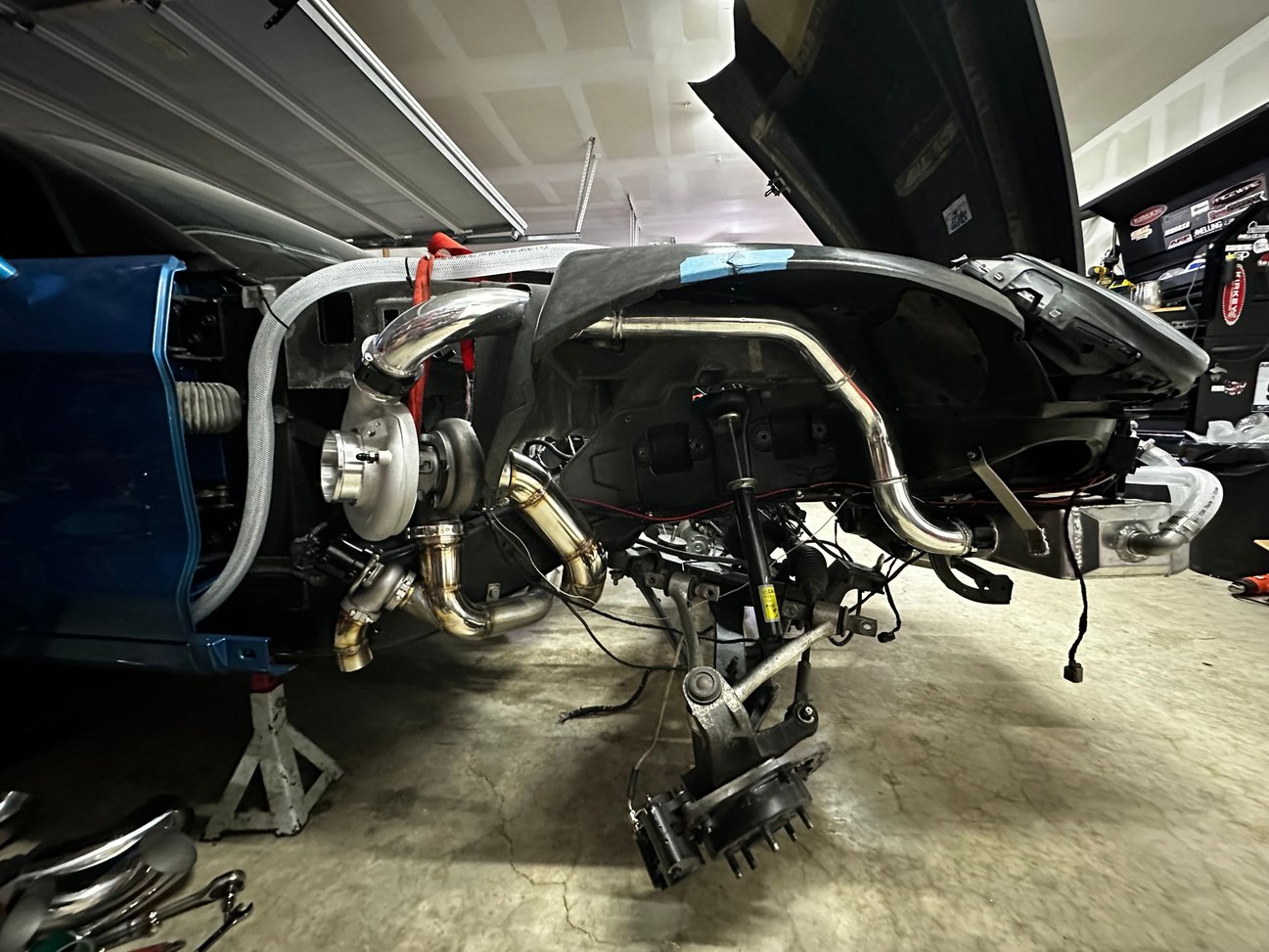

Here’s some more progress pics.
Driver side is pretty much done. Will just need the motor in to finish the hot side from the manifold.
Won’t have a lot of time to mess around with it for a little bit. Really just wanted to get one side wrapped up so I could see it.

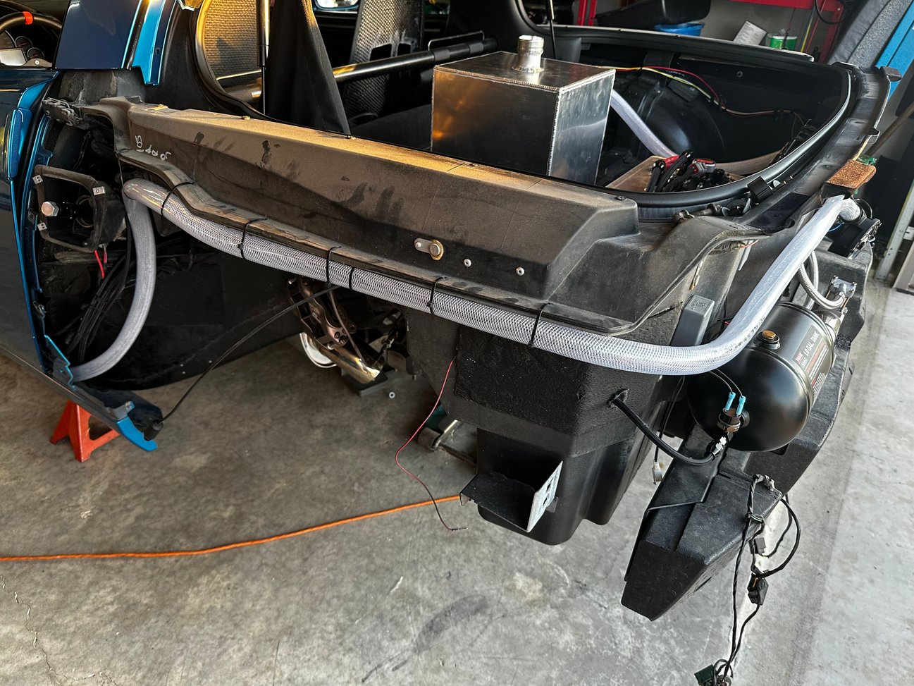

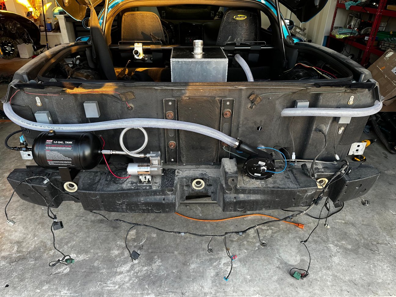

Did a bunch of wiring over the last few weeks. Mounted the 1gal air tank and compressor behind the rear bumper, fixed all the leaks that I found. Been holding pressure for over a week now. Haven't started on the other side of the turbo kit just yet. Just been knocking out some of the misc aluminum welding.

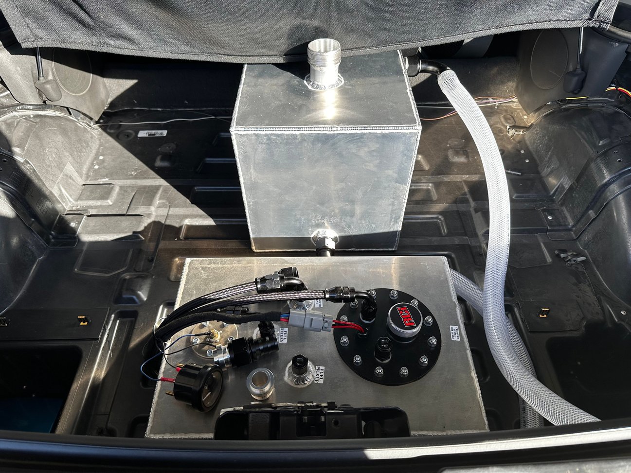

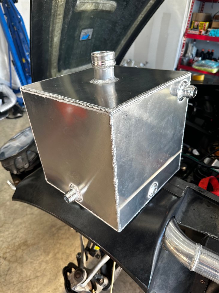

Opened up the water ports on the second IC and welded the vanjen pieces to it. Got the merge welded up to the TB. Built the water box. Don't plan to rely on ice so didn't add in a big opening and built it a little larger for some extra capacity (~7.5gallons). Made a little tunnel to direct feed air into the radiator, as well. I'll be mounting the oil cooler in there too.

I used that same line on my ATW and it dripped all the time. Your in a dryer climate than me but it Might be worth insulating since you have everything off especially if you’re gonna run ice.

Hmmm.. good to know. I don't plan to run ice. Only run the pump when I turn the boost controller on, etc.. I'll keep an eye on it and see if it needs attention. Thank you!

Yup, but as long as you aren't using ice you won't have any problems. Otherwise switch to a multilayer silicon hose like something from Vibrant, etc and you will be good to go.

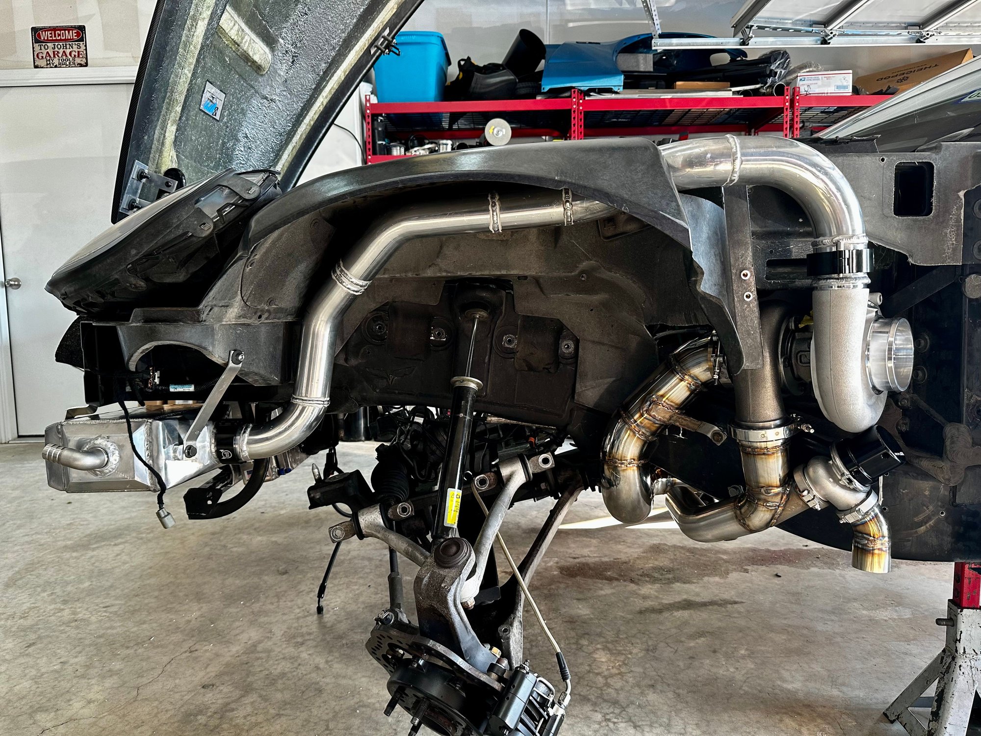

Got the passenger side pretty much almost done. Just need connect it to the exhaust. Also got the shortblock reassembled and put back into the car.

Got my tires mounted up and put the wheels on the car. Got a good amount of clearance at full lock. I was slightly worried I would have to redo some of the kit.
Also sent my heads off to get swapped out. Hoping to see the replacements soon.
