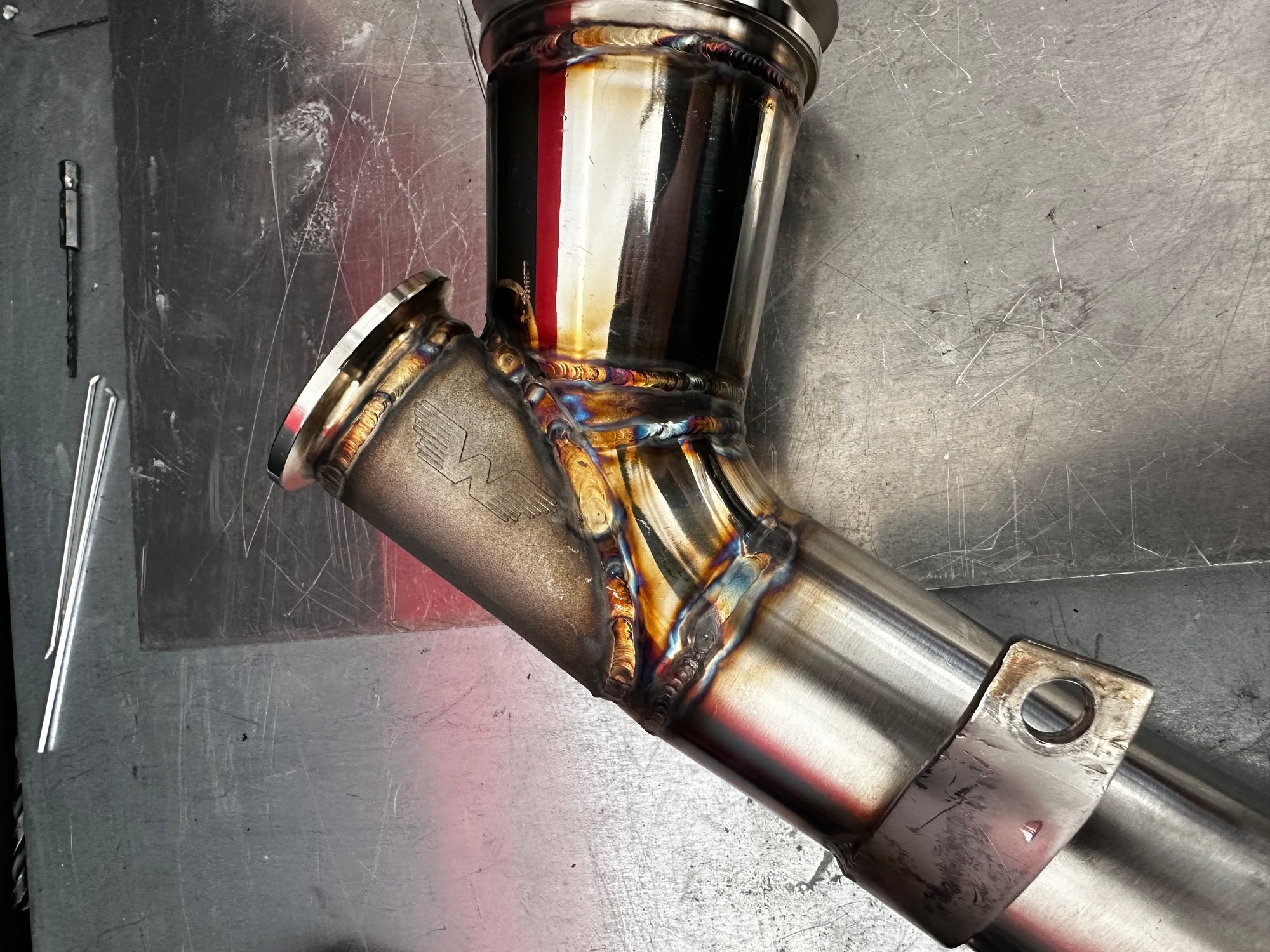

Gonna go with the Pulsar 73/75s, twins. Now to decide between front mount, fender mount, or mid-mount behind the drivers area (C6 vette where stock fuel tanks used to be).
About to start ordering everything to start mocking/building the turbo kit.

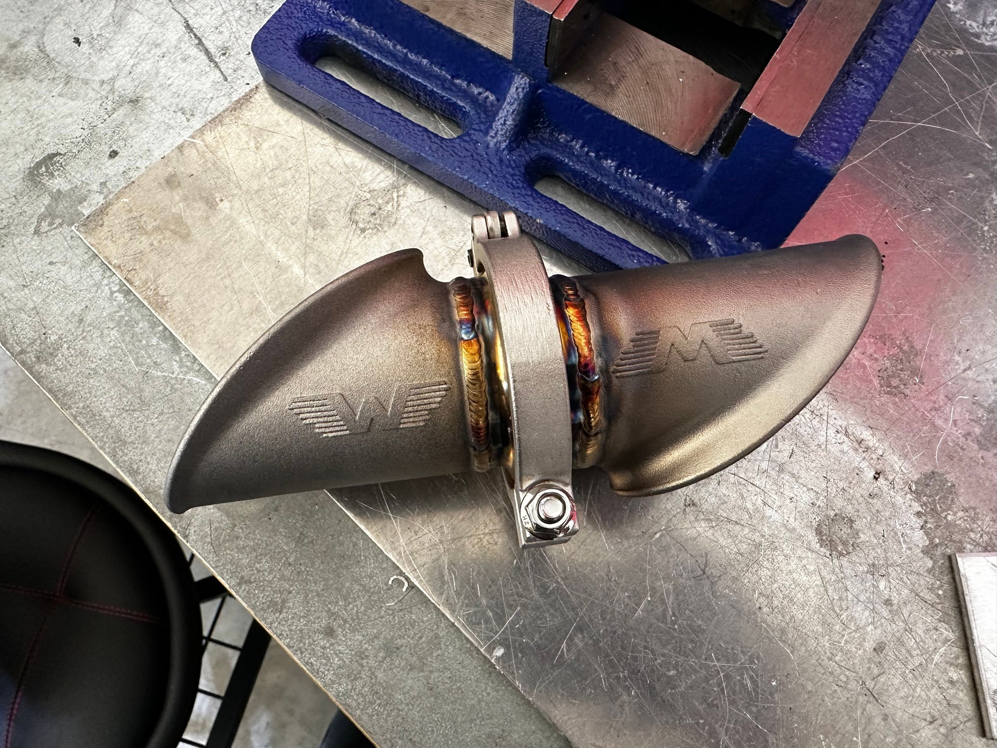

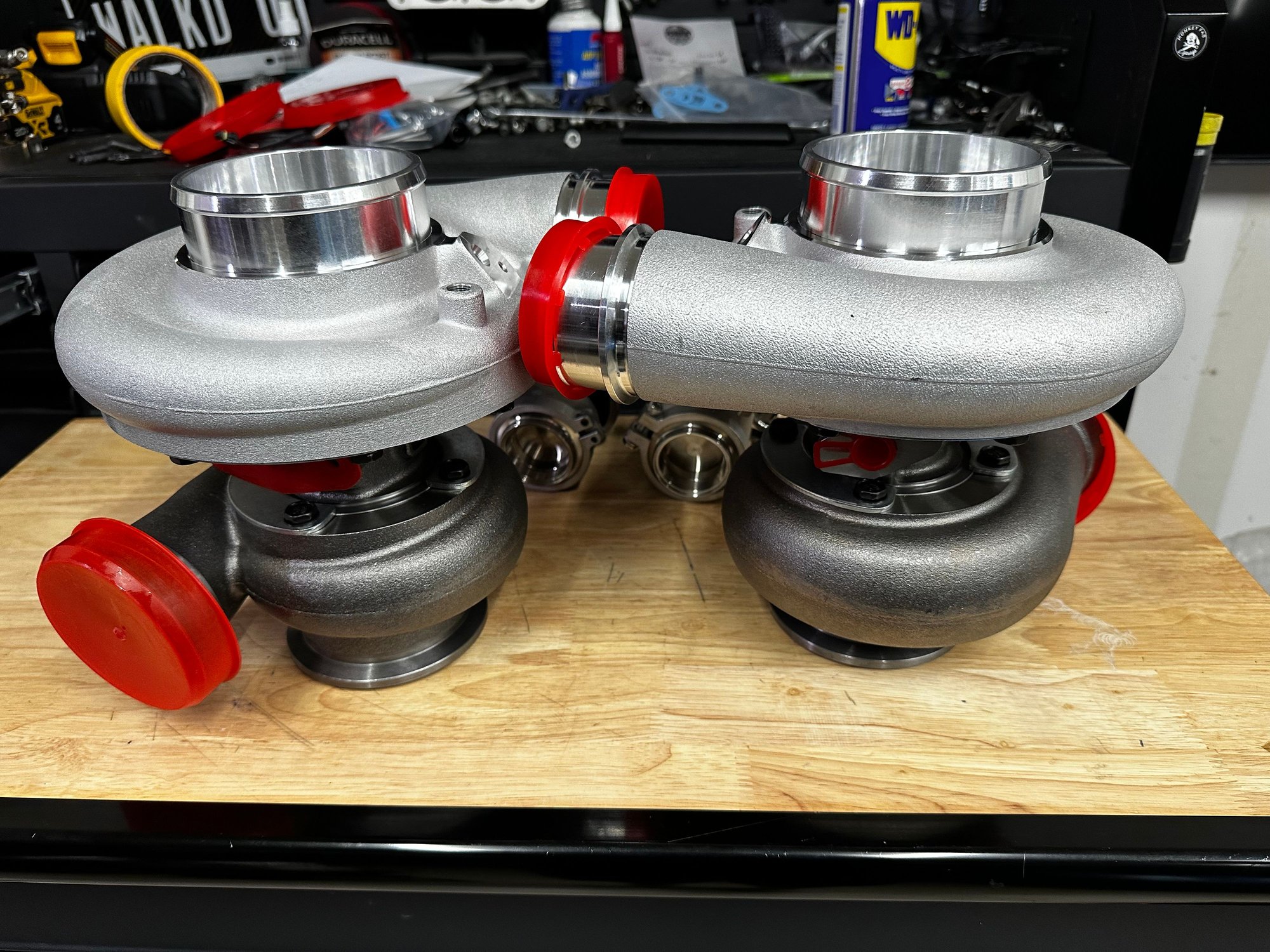

Ended up ordering some VS Racing 69/73s. I think these will fit my goals a little better. Not trying to break any records. Shooting for 1200whp on "mild" boost. Mid 20s psi. Should give me some good resolution for boost/traction control and not push everything too hard. Also ordered some stainless piping, wastegates, and some of those Motion wastegate merges.

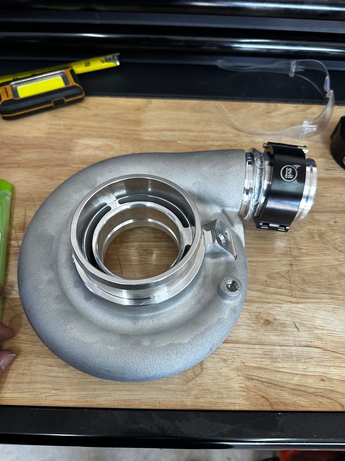

turbos are here. Should be able to mess with them on Sunday.

I was leaning real hard to mid-mounting the turbos behind the drivers area. In the end, I was afraid of spool time being too slow.
So, I decided on fender mount. Got to work this weekend.
