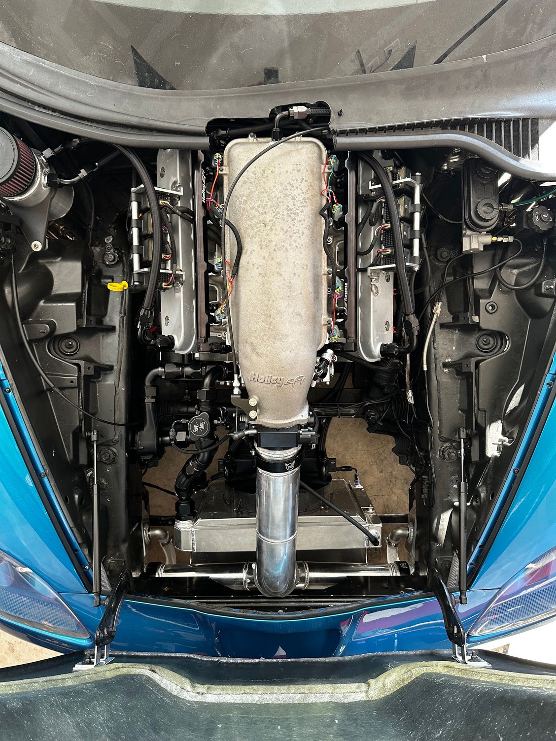

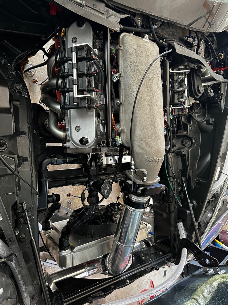

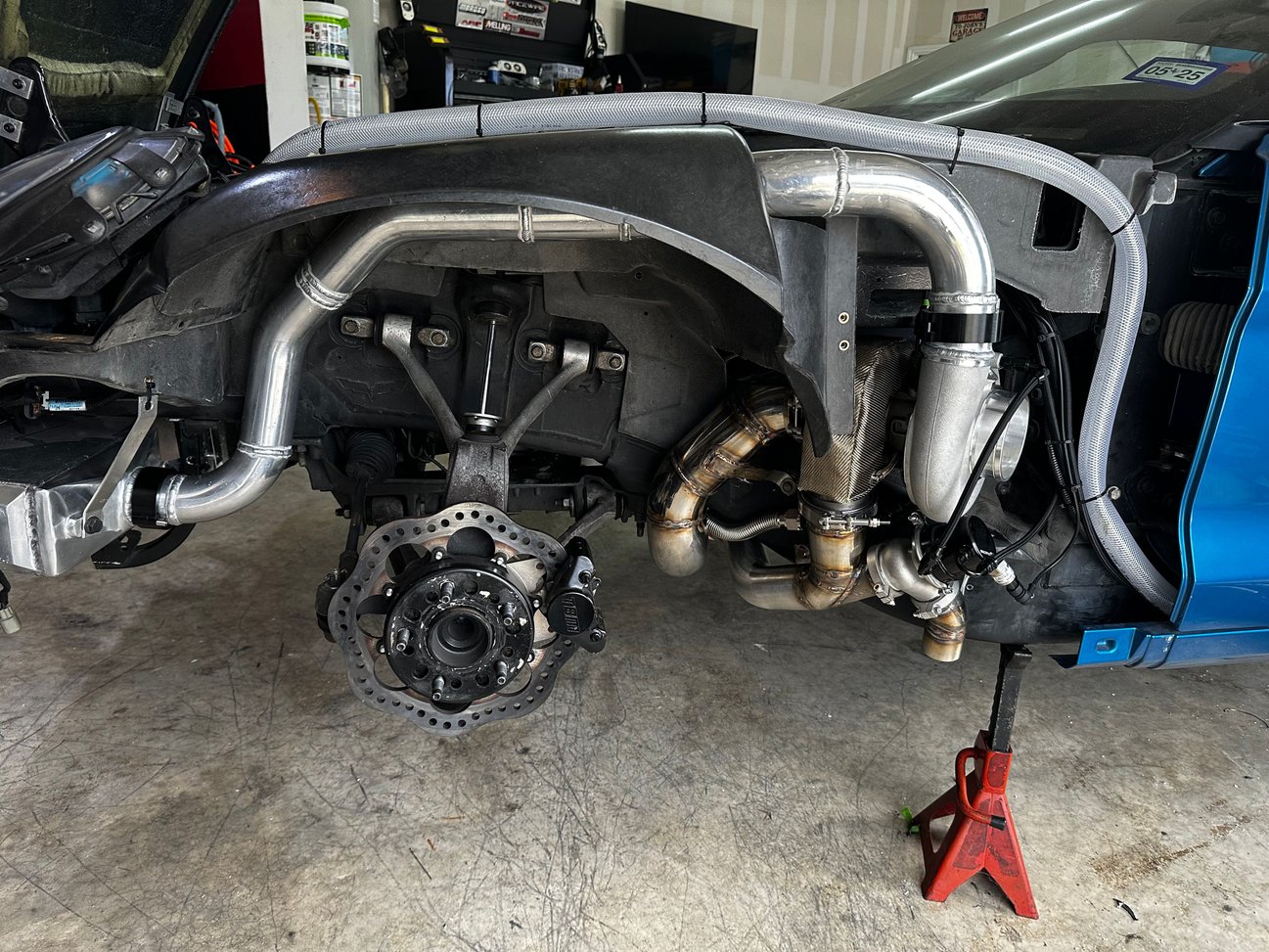

Been chipping away at it. Cold side is done. Mostly everything up top is finished. Just need to wrap up the passenger side hot side and a few other small things here and there.

What radiator is that?
What pump?
Could you describe your cooling system?

Radiator is a scirocco style from C&R. Fan came with the radiator, I believe its a Spal. 20an lines and the fill is from Chase Bays. Pump is a Davie's Craig EWP150 and a 417 motorsports water manifold

It looks well set up to me. Thanks.
And, basically the same stuff I have, but my rad is in the rear…. It seems I have issues getting the air out, as it runs way hotter than I’d like.

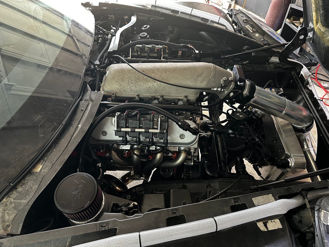

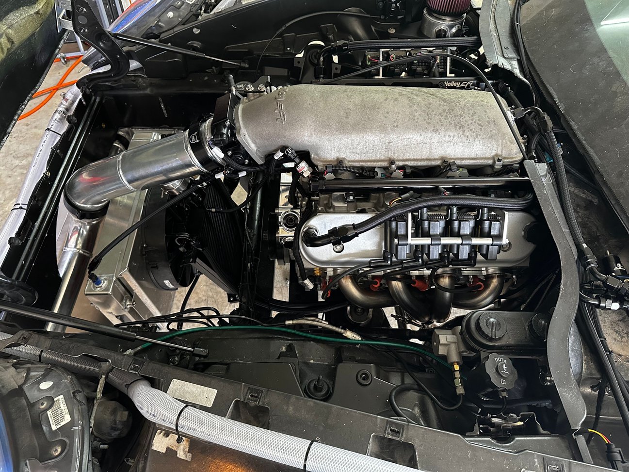

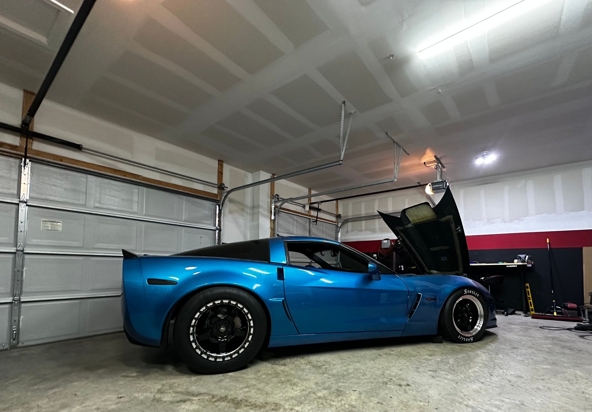

Here's how it sits, completed. Its full of fresh e85, oil, and water. Attempted to fire it up earlier today and the battery just didnt have enough juice. Was able to get some oil moving, TPS autoset, and fuel primed. Ordered a Noco jump box to try again tomorrow.

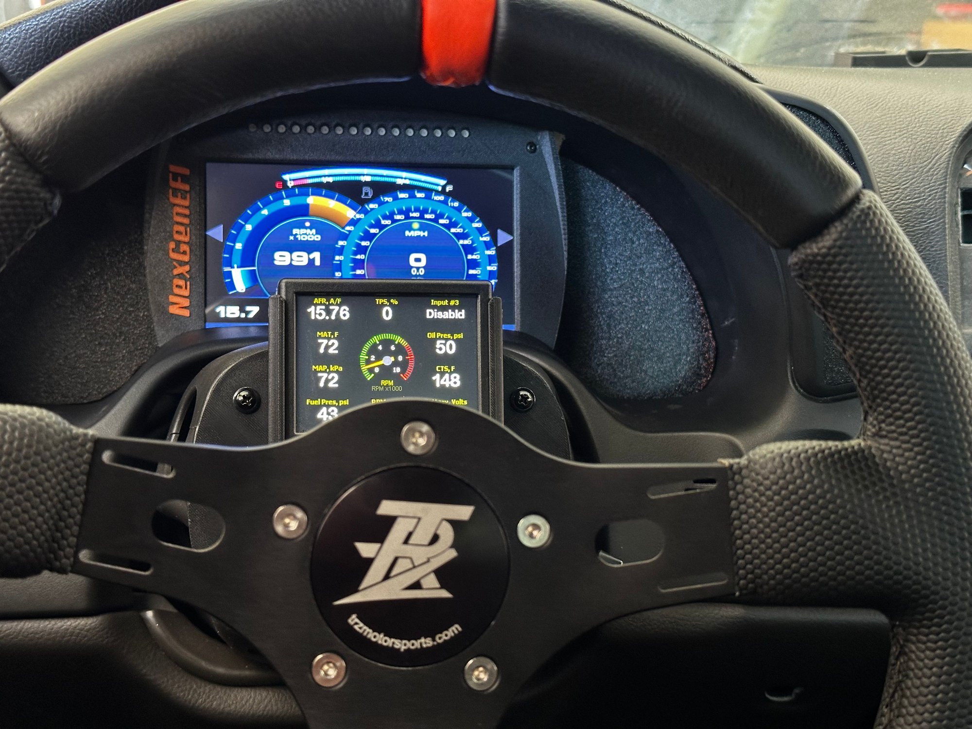

Its ALIVE!!!!
I was having trouble getting it to fire off. Not sure if i just needed to add more fuel in the tune or the 210 injectors i got from a buddy are/were no good. Had a friend swing by some stock ls3 injectors and it kicked off almost right away. I did still have to add some fuel to get it to stay on and idle well. I dropped those 210s off to have checked/cleaned/flowed, so we will see.
It does have a small oil leak that i've almost gotten completely sealed up. Got crank on the AN line a smidge more.
Revs are nice and snappy with the solid roller in there. Overall, the exhaust is pretty quiet with the Vibrant Ultra Quiet Resonators on there. Just has a deep, bass tone.
I did get to take it up and down the block and everything felt solid.
