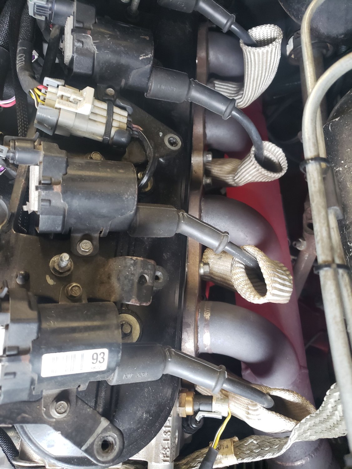

I got the car to idle more normal than it was before, but the pedal is still a rock. I gave it a few revs once it warm to clear it out and this is what the driver manifold looked like after i managed to get a picture of it. Clearly something somewhere isn't right. It must be lean to run hot enough to make the manifold glow red. The number one cylinder runner was so hot my temp gun just says over temp when i check it.

Timing is way too late and fuel is burning on its way through the header. or it's super lean fuel mixture.

I believe it's lean, that would support my vacuum leak idea. Unmetered air getting in leaning out the mixture.

That large of a vacuum leak should be easy to find. What head bolts/studs are you using? I've seen the top row of head bolts interfere with the intake surface, not allowing the intake to seat properly.

I bet if you log your idle, you will find timing at 0* or less. I would also guess that you will find a bad reading from at least 1 sensor, and odds are it will be the IAT sensor. I have doubts about a lean condition having anything to do with this.
edit-- Or your reluctor wheel broke loose and it will require a timing light to verify actual timing.

Betting on this also , late timing leads to low vac , poor / incomplete burn leads to unused O2 which the sensor picks up as lean , definitely leads to high exhaust Temps. Aftermarket crank ? Could be an inaccurately mounted reluctor wheel ?
