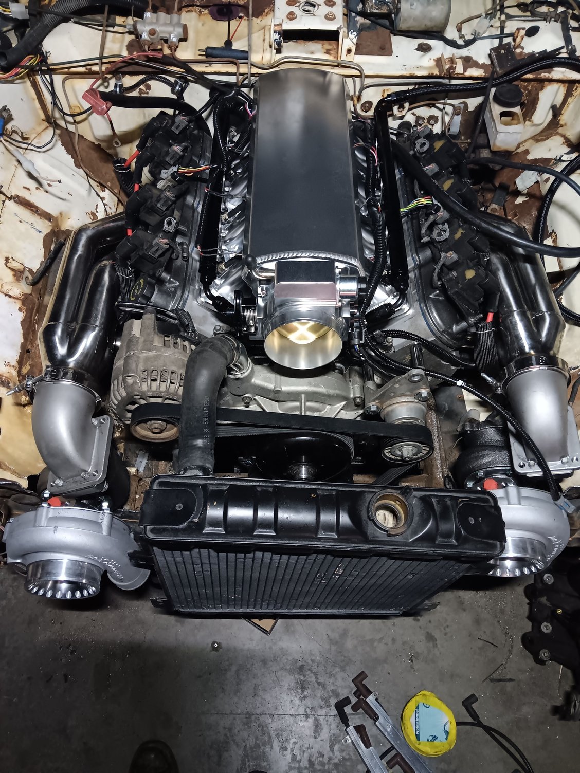

Didn't see your reply about the internal wastegate till after i ordered these. Gt3582. Don't mind the old radiator. Just seeing what's gonna fit. The intercooler is going to be out in front of the grill lol. Cramming 10lbs off **** in a two pound sack. It's tough. I've got two walbro 400lph pumps. Dual in, single out intercooler. Two wastegates, one BOV. Oil feed and return lines. Anything I'm missing?

Idk where I read that the turbo becomes the muffler. But that's a joke. This thing is so fkin loud. I was going to do fender exit but this thing is so loud it will wake the dead. I ordered some 9 inch long resonators. But I don't see that making a difference. Exhaust has been a sore subject from the start of this project. My drivers side manifold is a half inch from the gear box. I'll have to run my exhaust inside the wheel well arch and under the cab outside the frame. Just worried it's going to inhibit me from lowering the front end. Can't wait to try the 2step though. It shoots some pretty good flames lol. If I run the short (like 2" deep) come filters on the turbo inlet, you think it would restrict the airflow too much?

FWIW - Porting of the housing leading into the internal wastegate (on the turbine housing) can help with boost creep. The late great Corky Bell ported one for me a long time ago and it helped.
