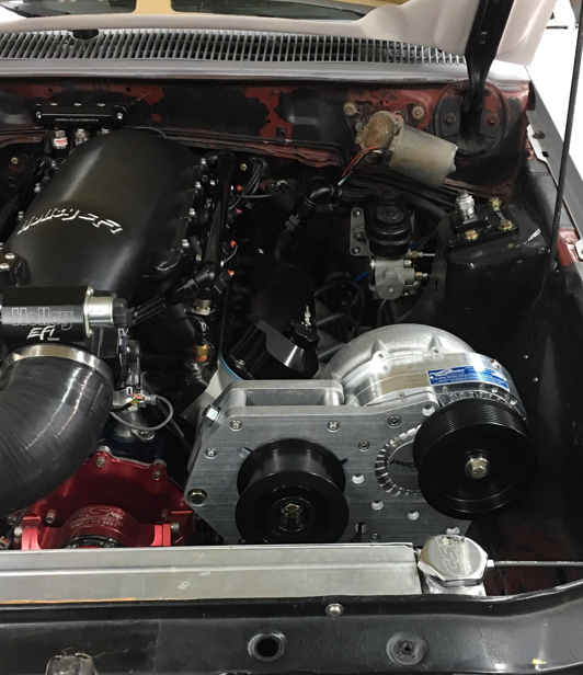

Working with a buddy on an F1 setup on his SBF in a Fairmont. Space was def an issue and the accessories and drive with a 12 rib belt was also a pain. Super slick car though! Def takes up a lot of real-estate up front! Much more than similar power turbo would have. But he likes the whistle! lol so here we are! Had to buy some fancy headers to match it all too of course.
