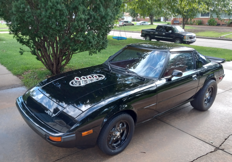

Comfortable cutting glass! lol. The motor is crazy far back in those things... Yet you can have a tea party for 2 in the nose cowl area.
Bud runs one as a bracket car. The need for turbos up there is strong!
Happens to be FS if anyone needs a pretty slick roller for 8k in the mid west. Other than being pepto bismol pink, its a nice car! lol

Tiny little RX7 with alum 5.3 and CD009 maybe?
