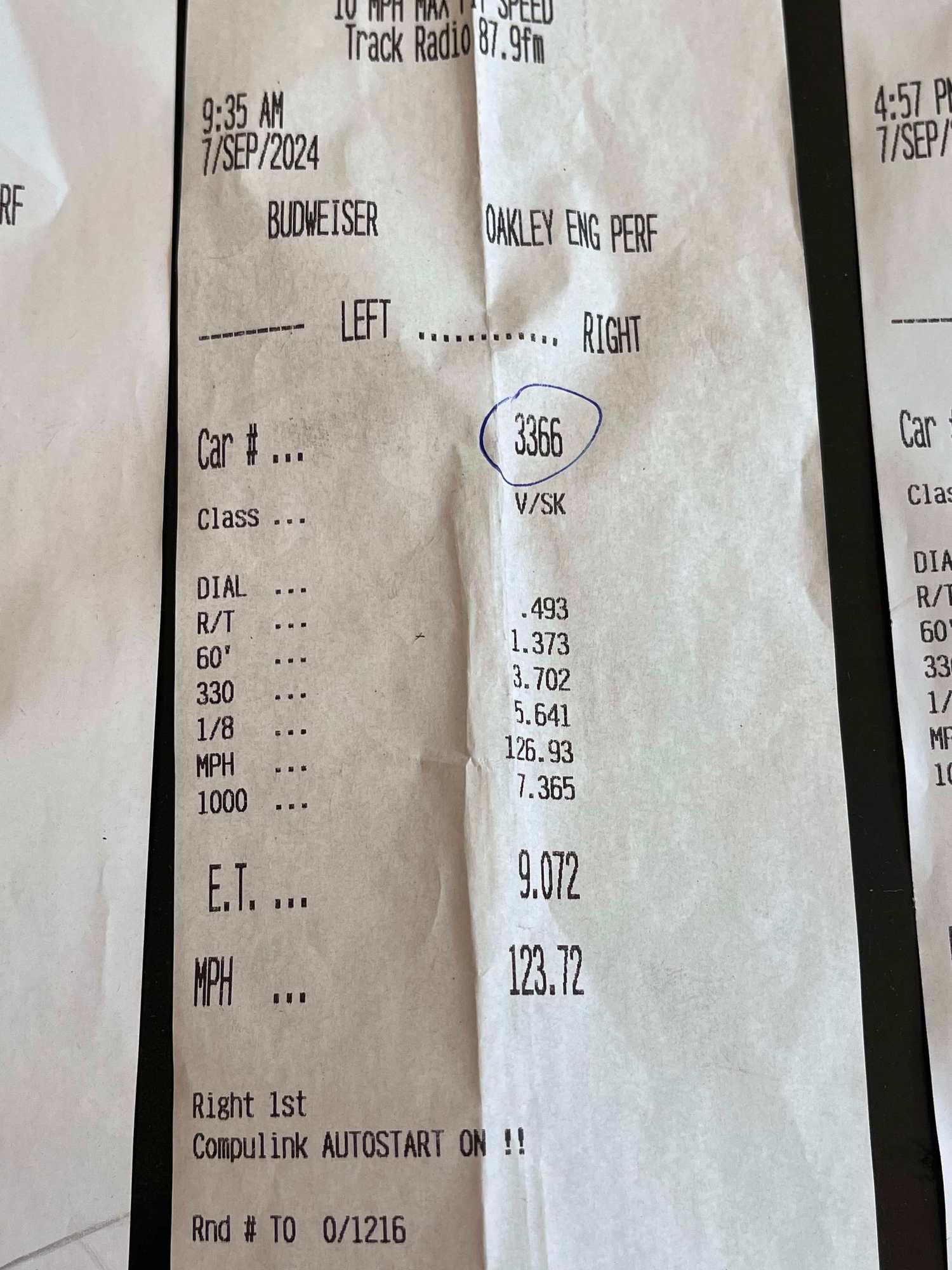

I've run this in 12 passes, and only half of the passes were decent I screwed on some and had tire shake on another.
Wallace says this is 920HP @ 3200 raceweight. This was on 18 psi (S485), 1.2 ramp, 15 total timing on E85. I'm hoping to run 5.30 with this ol' SBE then retire it.
