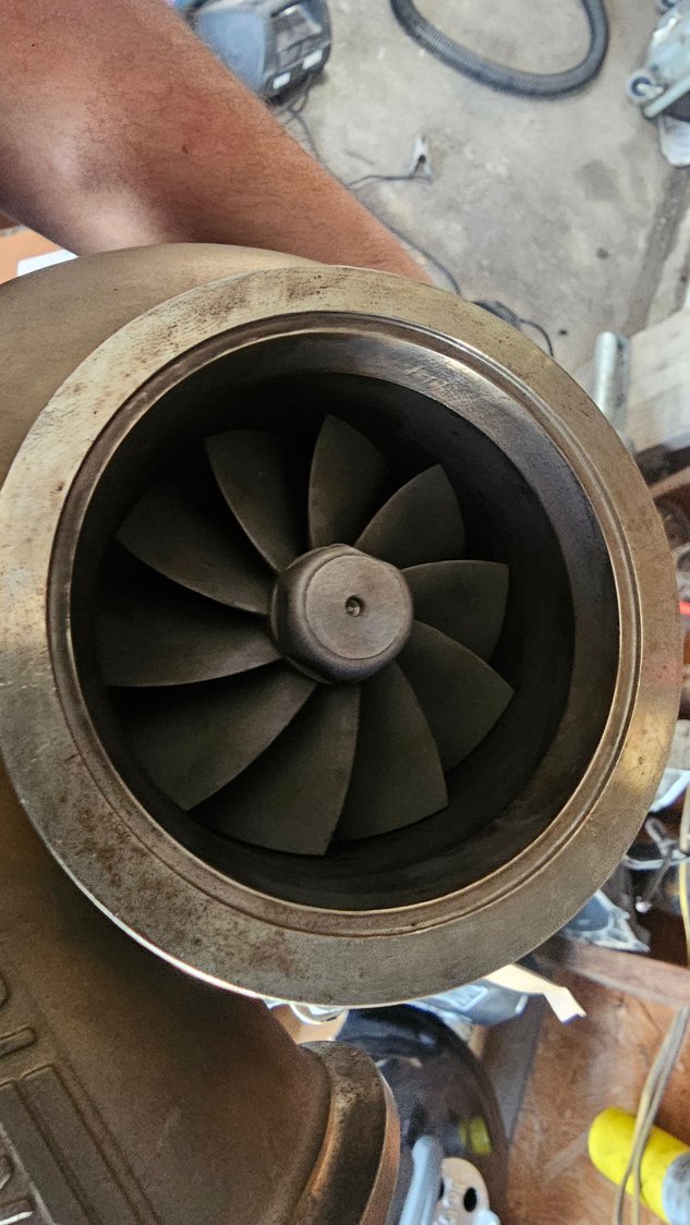

Are you sure it's the turbos smoking at this point?
the motor didn't smoke at all before putting the turbos.

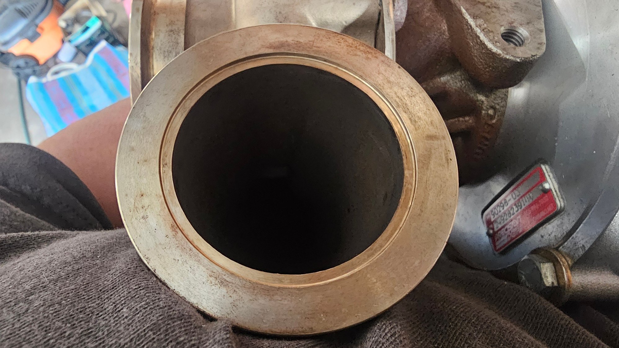

So it has oil in the charge piping?
no oil
