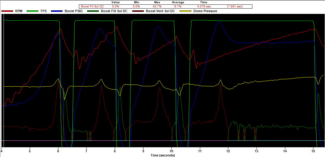

Weird that you say that, I was at the track tonight and saw a guy wearing a Jaywire T-shirt. I ended up having the opposite problem, and I'm scratching my head as to what is happening. 1st and 2nd gear, I got a bit of the rise in boost, but in 3rd and 4th, it went up to 16.5 PSI and flatlined. No overshoot at all. The problem is, I was commanding a rising boost curve all the way to 24 lbs. of dome pressure and it didn't raise the boost whatsoever. I'm wondering if I have a boost leak somewhere. Doesn't make sense that it's only in 3rd and 4th gear though, although 1st and 2nd don't seem completely right. See the datalog traces below to see what I'm talking about.

Yes, I'm boost by speed. I don't know how well the testing would work since setting it up with boost by time wouldn't simulate shift points where the throttle is shut and then I'm going WOT again. I've done a lot of testing with different PID settings and most of the time, changing them doesn't prevent the hump from occurring, but it does induce a downward drop in dome pressure after the hump. Where I have it now creates the most level pressure over a pass, aside from the humps. I do wonder if there's something mechanically wrong, however. If you look at the second datalog trace, 3rd and 4th gear are perfect. Normally they're not. I guess I'll have to do some inspection of my system to see if there's something going on.
