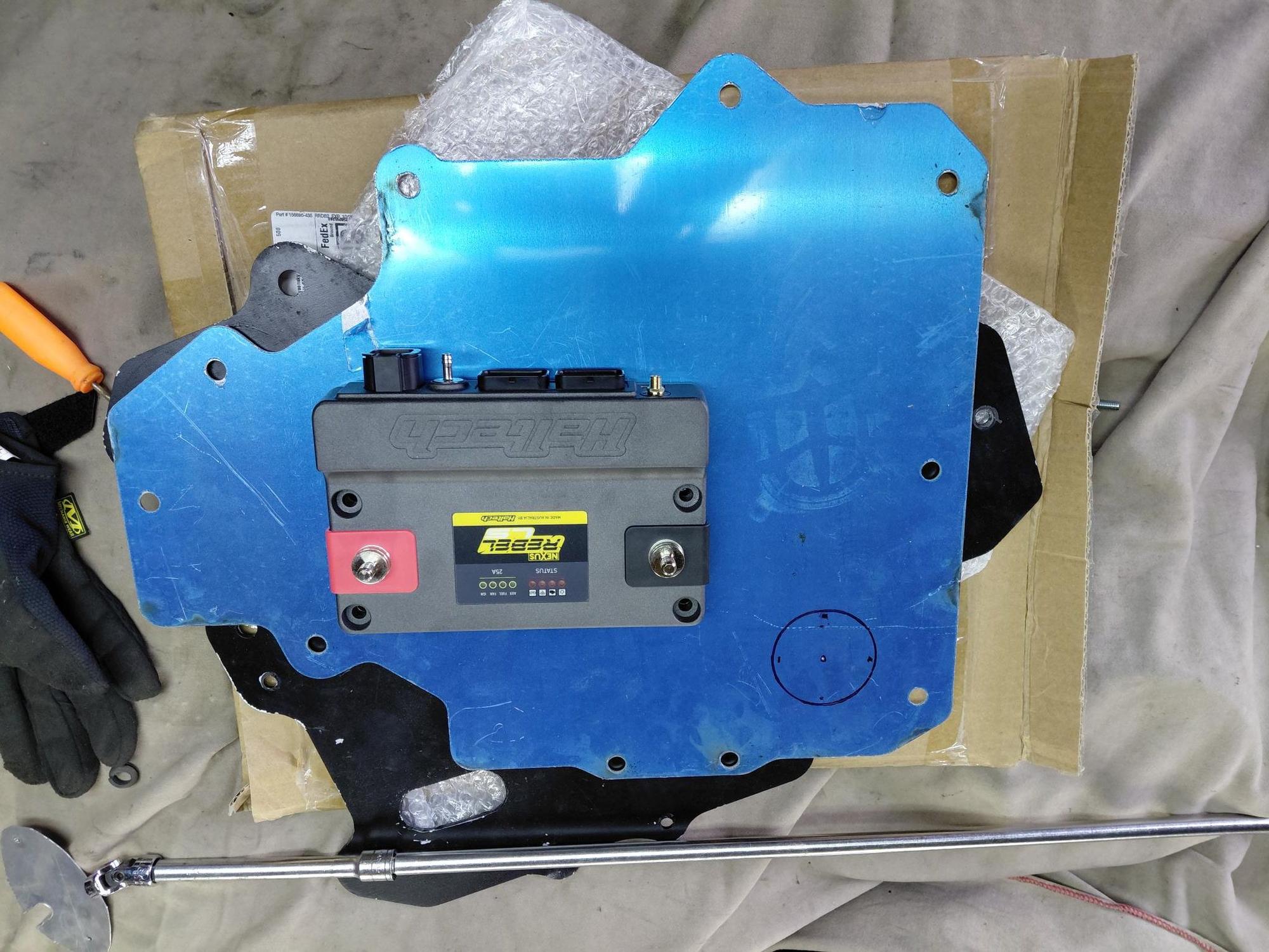

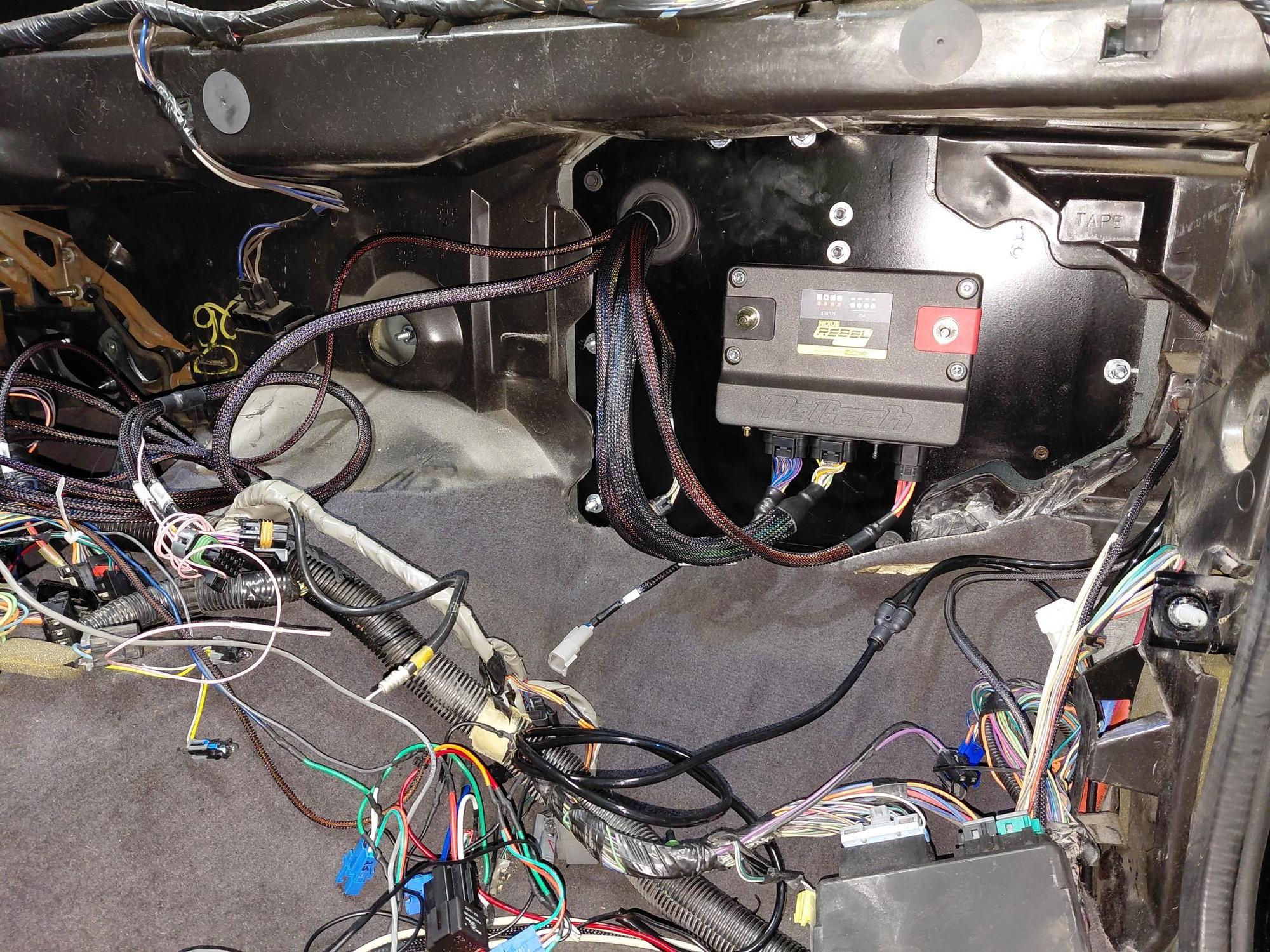

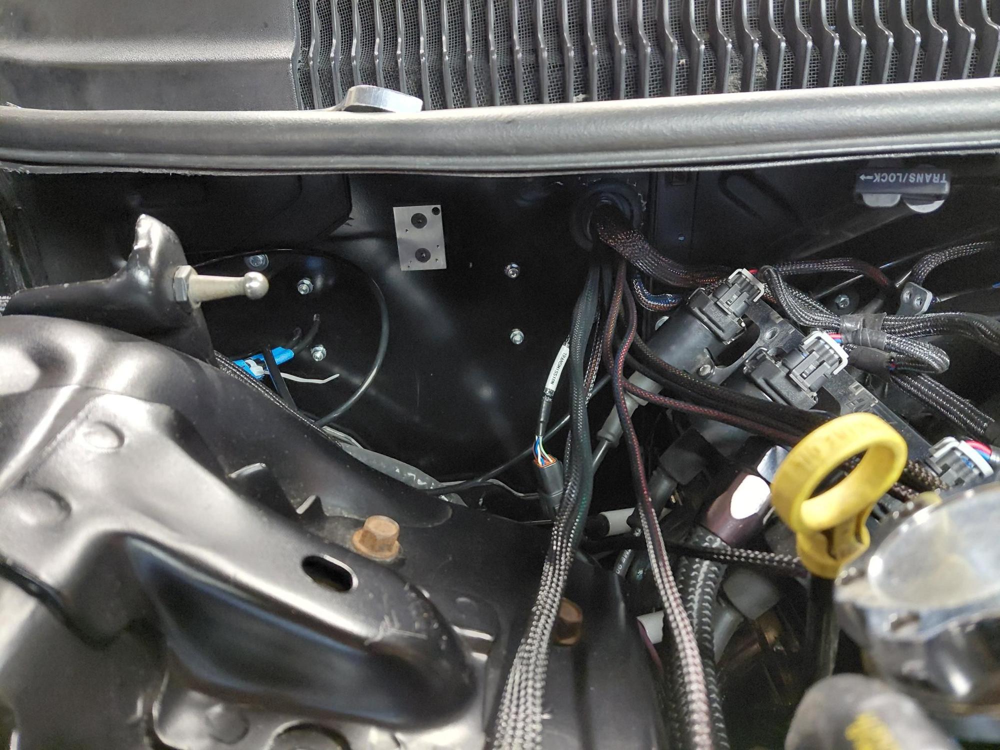

Quick progress update, with all the AC/Heater dash components removed I got the delete plate mocked up for mounting and installed.
Got the Haltech mounted and harness pulled through the firewall as well.
I tried to keep the harness up high and as far away from heat as I could.
Starting to feel good about this, next I'll wrap up the engine connections and then start wiring in the lights and hopefully by then the screen mount will have arrived so then I start mocking that up in the dash.

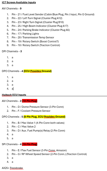

Current list of inputs for anyone interested.
Guys with experience please feel free to make suggestions on how to better utilize them as well.

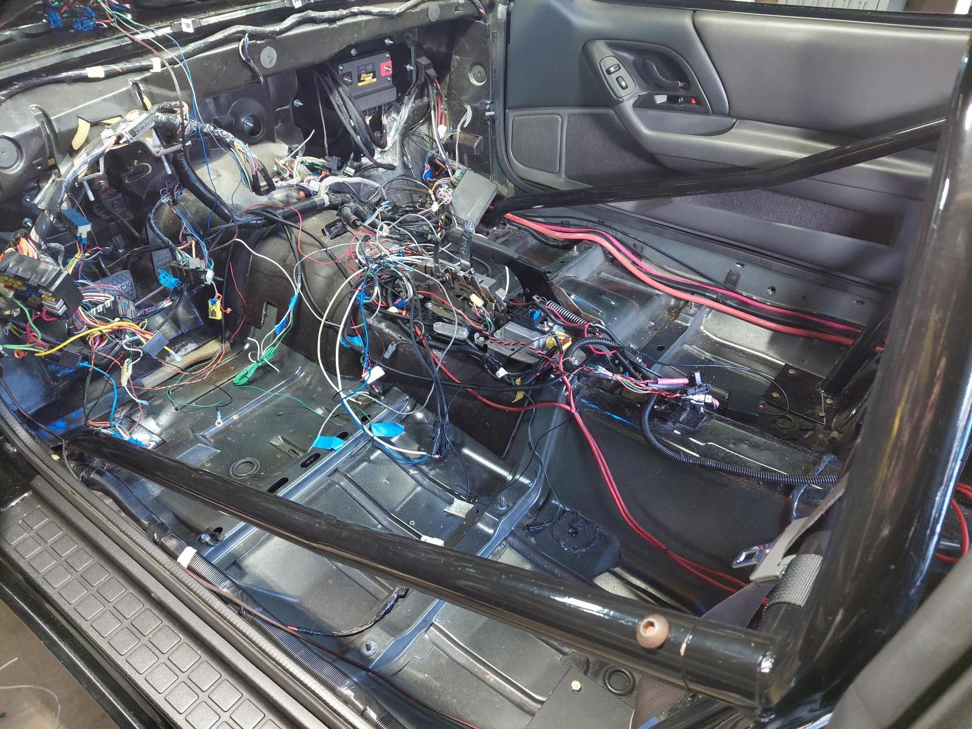

Morning gents, quick question on wiring.
I'm about ready to move into the cabin to start wiring in the factory harness into the screen.
In the attached diagram below, both the Rebel and IC-7 screen provide both a +5-volt supply, +12v supply and ground supply for multiple sensors.
What is the best way to tie multiple sensors to these power/grounds, soldering wires onto one main lead, terminal strip, multi pin connector with jumpers across the pins?
I'm also trying to plan for future add-ons without having to pull the dash back out so the idea being able to add more inputs/outputs easily in the future which on the Rebel will be easy but for the IC-7 will require some planning.
Any suggestions are welcome.
