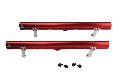

So, I found the rails, they're Aeromotive rails which is nice.
Fuel Rail Kit, Edelbrock LS1 Intake – Aeromotive
I'm not seeing any LS2 brackets on their website so I shot them an email.
Not sure what else I can do if they don't have brackets.

I really dislike those rails as I've seen those brackets bend and flex and pop out o-rings even at the correct installed height. I much prefer a fuel rail that has solid "blocks" for rail attachment. if you can't find the correct attachment for those rails I would switch them out entirely to something else or make some better solid brackets to hold the rails at the correct position.

I'm back to square one on this, I went back out and pulled it apart because it was bugging me that the height was right for LS1/6 at 2.5" then why do the bolts not line up.
The adapters are too large diameter wise to fully seat in the fuel rail opening for the injectors, so they in fact don't work.
I dremeled one down to test the theory and while I got better fitment, the aluminum got too thin and broke, at least now know.
@NicD I'm not seeing any options out there for fuel rails for the Vic Jr. with blocks instead of brackets so I might be stuck there.
The Edelbrock ones look better with a bracket the bolts through the rail but that's about it.
I've got emails out to Aeromotive, VS and Fuel Injector Connection for spacers and brackets, we'll see what comes back.

My brackets are very similar; the metal is actually pretty thick at least but I can see Nic's concern.
Once the rails are bolted down, they're extremely rigid so really at this point I'm not making any changes.
This setup saw nearly 22 psi without a problem so I'm going to stick with it for now but keep my eyes open for other options along the way.
The real problem was the Amazon spacers, once I ground down the circumference, they seated far enough into the rail for the mounting holes to line up.
Problem was I removed too much material, and they broke on install, oh well.
Aeromotive doesn't make an LS2 height bracket for their rails, so I've come full circle and ordered the spacers from VS Racing lol.
I sent the rail dimensions to VS and they said theirs would work so they're on the way.

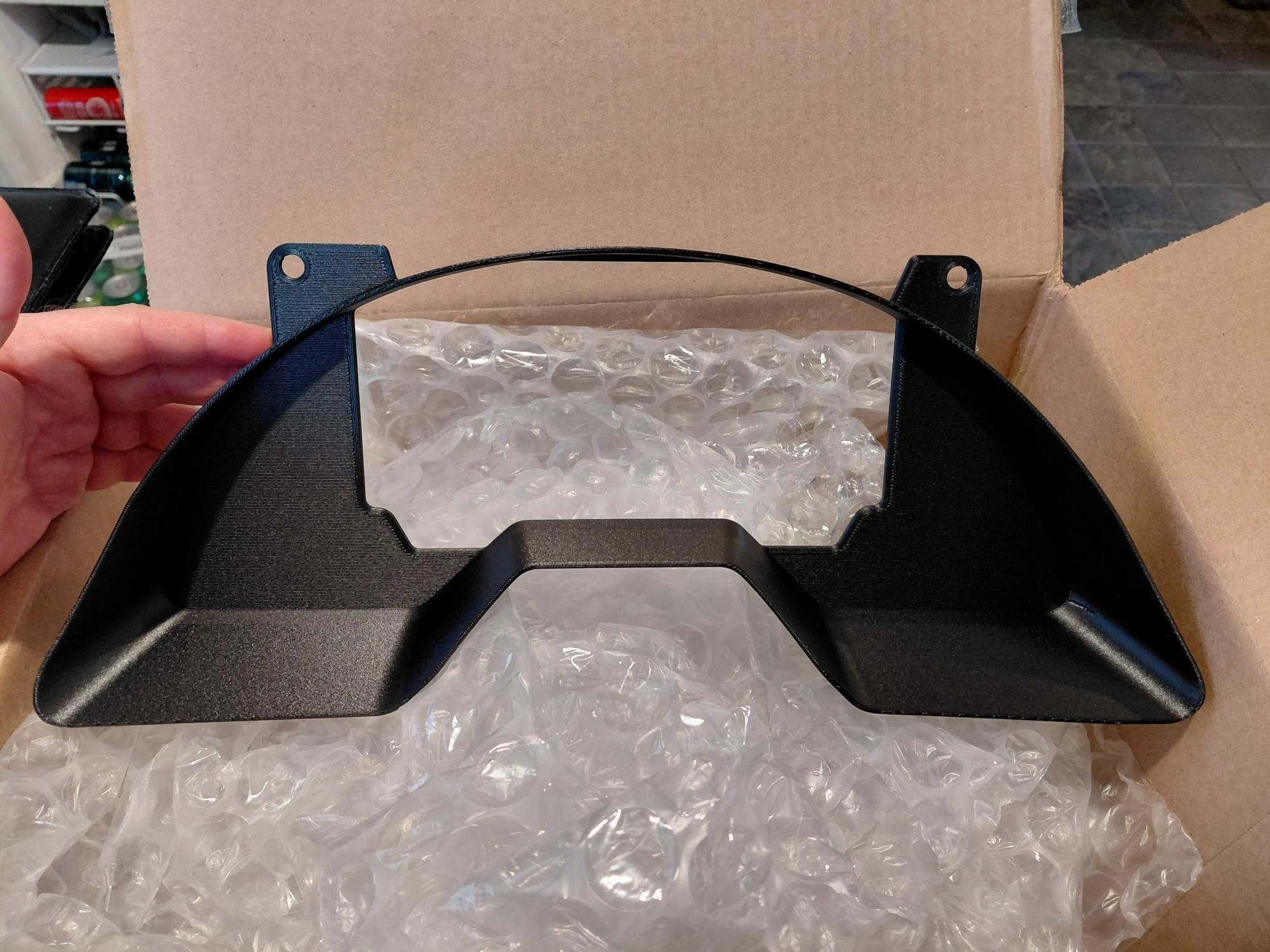

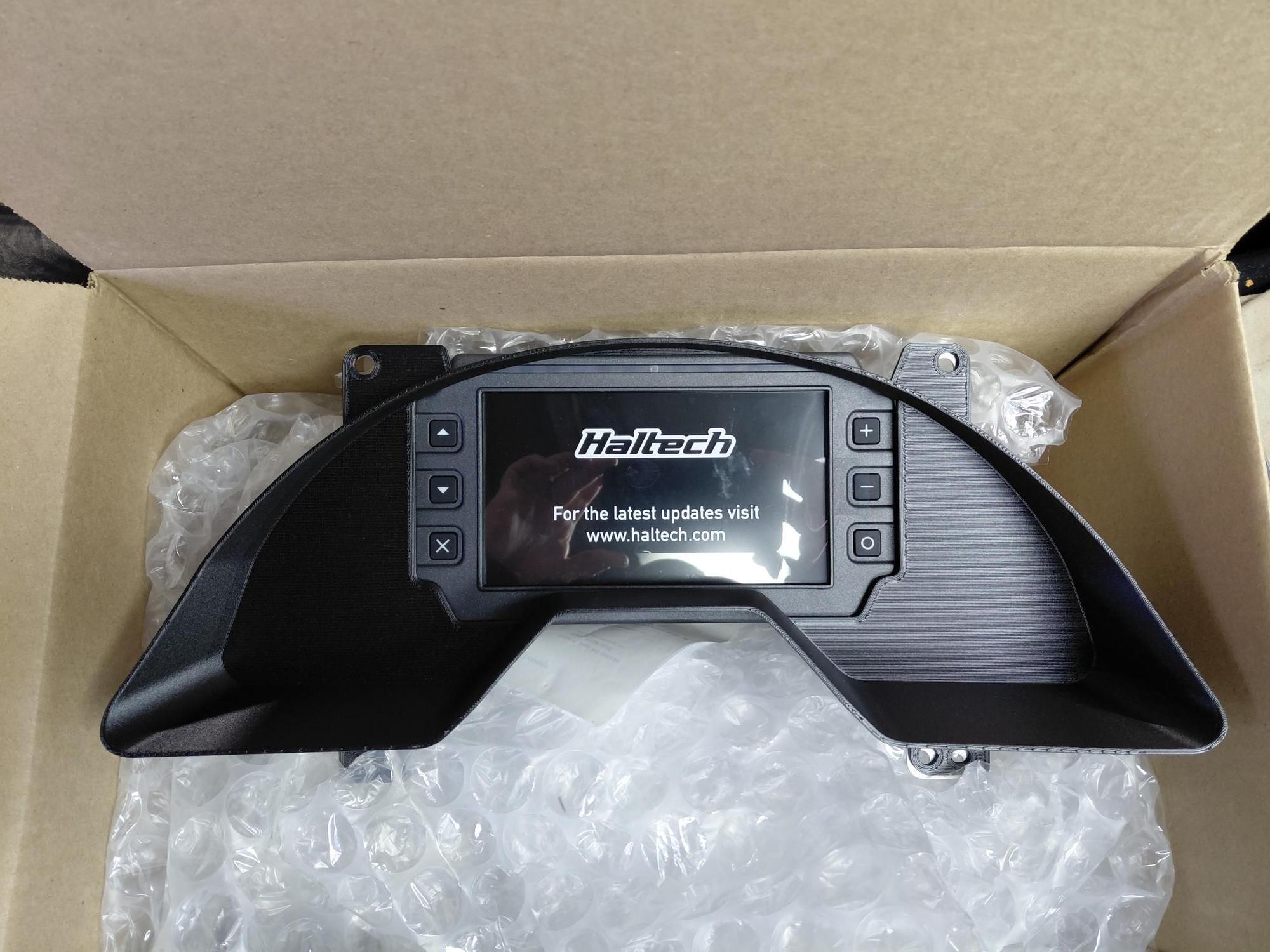

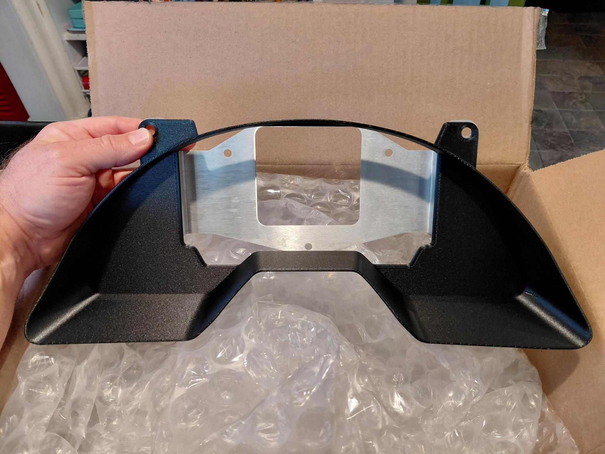

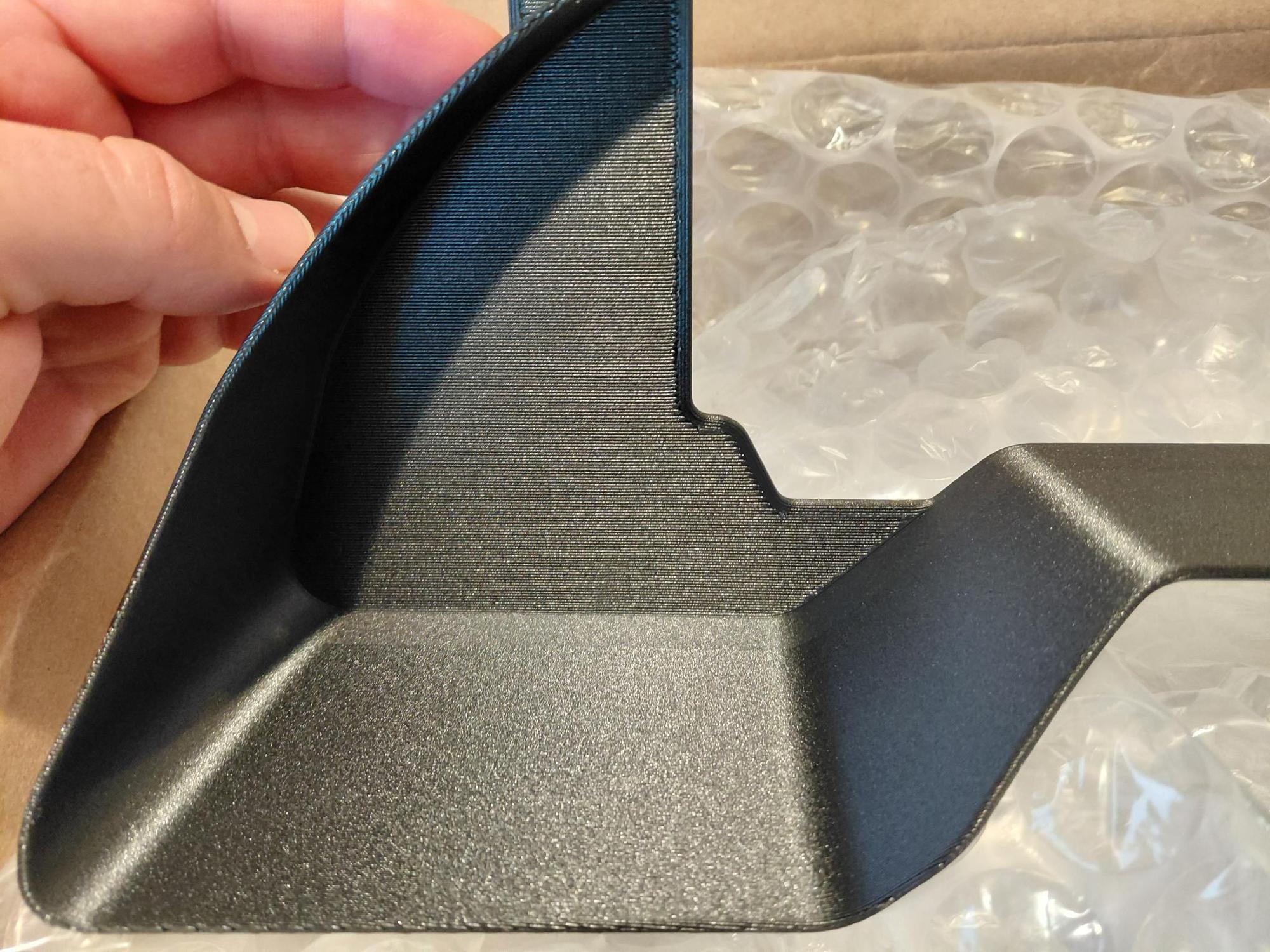

On a brighter note, the dash insert for the IC7 screen arrived yesterday and looks to be a very nice piece.
Dr. EFI kind of inspired me to go this route after seeing all the 3D printed items he's been using on his builds.
I got this piece from Jeg's made by Reversion Raceworks and while the shipping was a little inaccurate, I didn't have to wait too long at all to get it.
As I've mentioned before my son is deep into 3D printing, and he gave it two thumbs up for its quality and construction after rattling off a bunch of jargon that I didn't remotely understand about layering and it being all one piece lol.
Can't wait to get the screen mounted and start running wires.
Reversion Raceworks RR00334 Haltech IC7 Digital Dash Bezel, 1997-2002 GM F-Body - JEGS
That looks real good. The aluminum support piece is a nice touch.

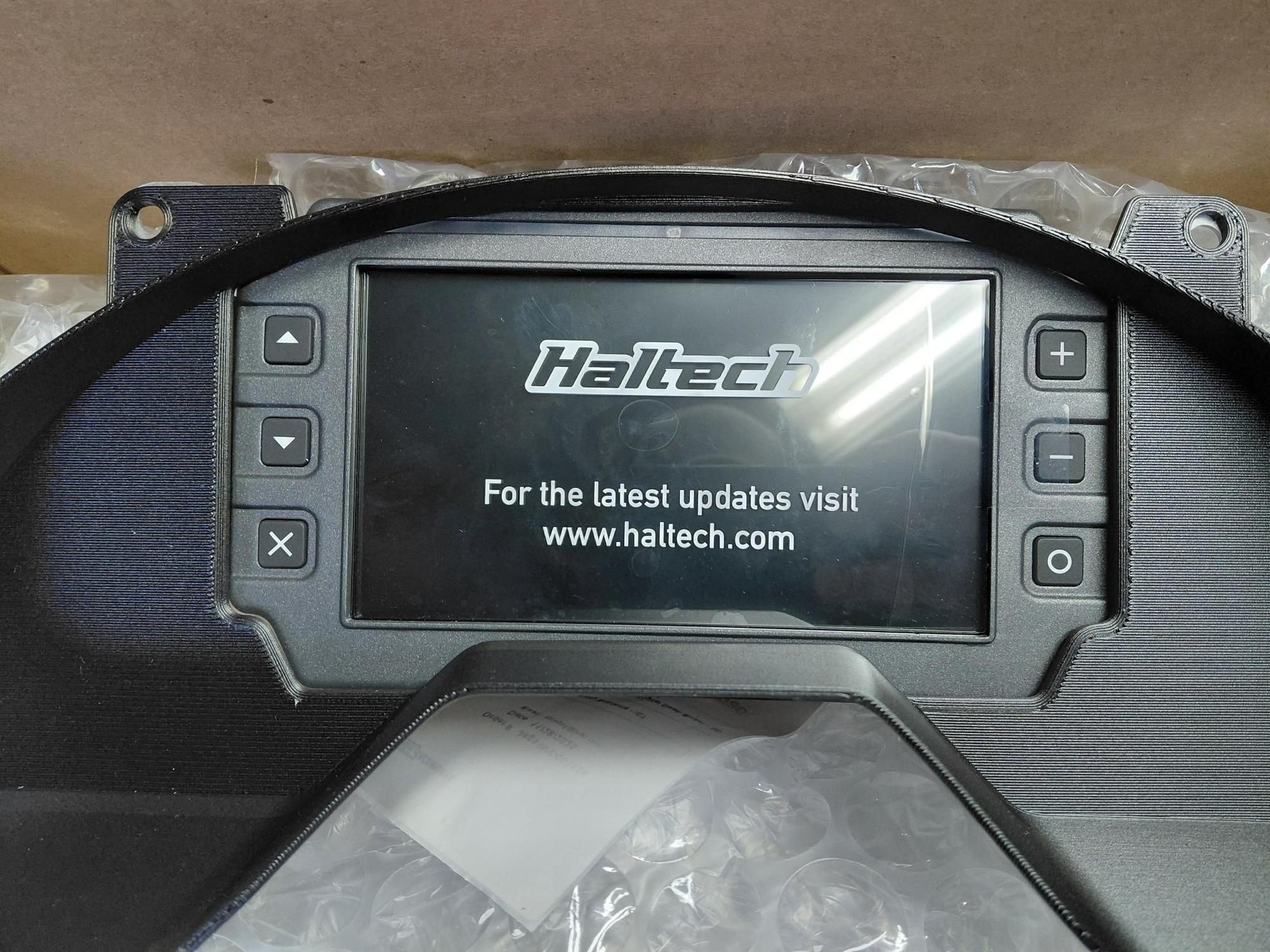

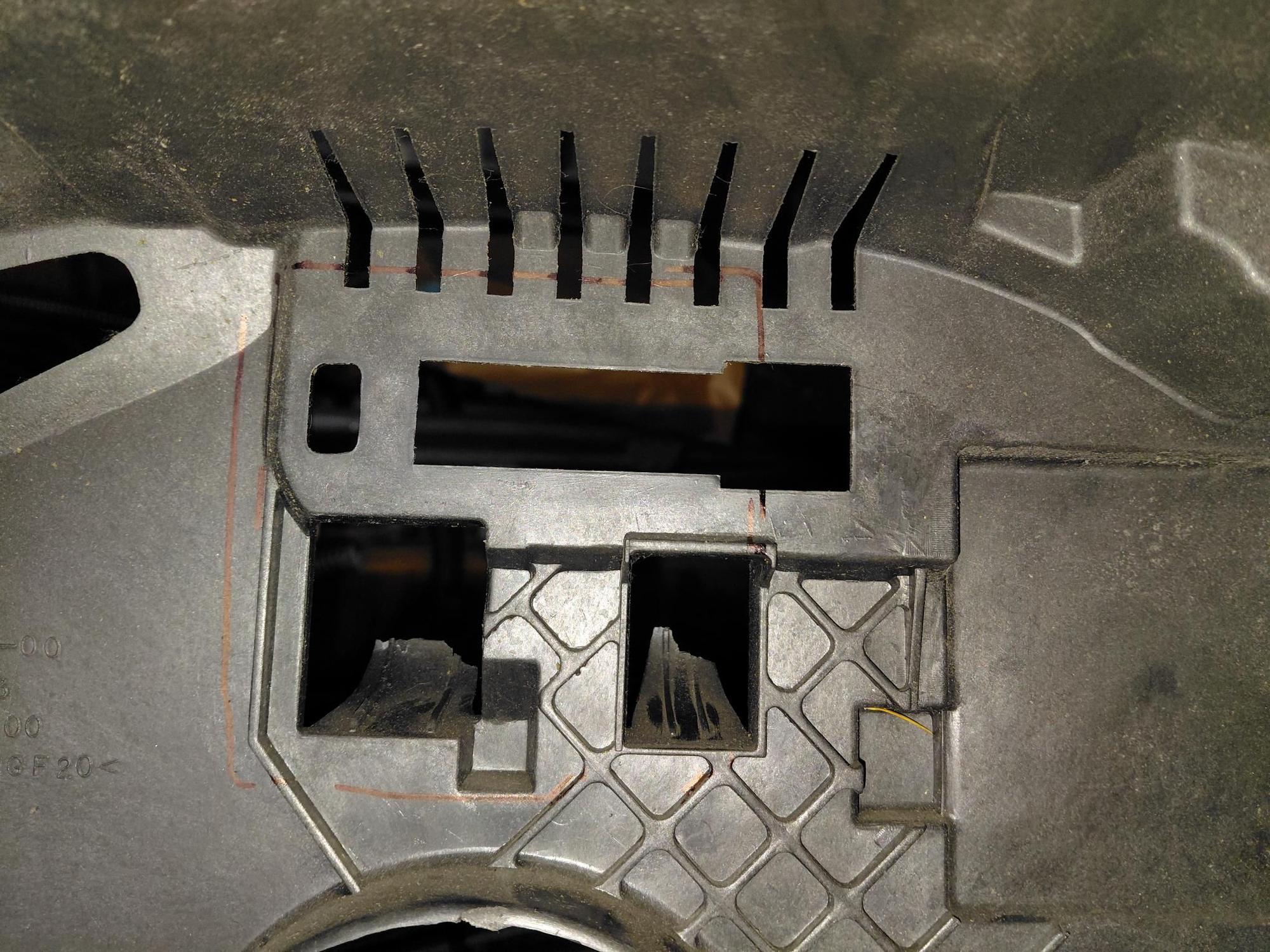

Shot of the screen installed.
Reversion really nailed it.
This is the area that will need opening up for the Haltech connector using the bracket as a template. I'm thinking I'll keep the hangers for the factory harness since I'll need them but everything else around them can go.
