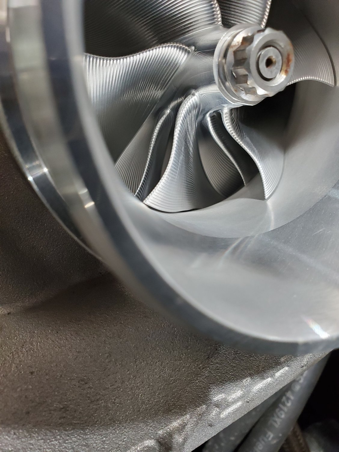

You wanted an Argument? Take a look at the Compressor wheel in Viren's 78/75 NextGen. See there are two sets, small diameter Primary and much larger Secondary set of impeller blades? It IS a Two Stage Compressor.. You should have one just like it.
That's a good idea
Yeah, that's not how it works. That's just one compressor regardless of the configuration of the impeller blades.
what are the benefits of this?
Looks cool and sells a lot of units.
It's cheap, it's just a slight variation of another manufacturers design that they copied. It will also make 200-300 horsepower less than other turbos that are available in that particular "size".

Its a swept blade design. I see it alot at work with turbine engines. The turbo aftermarket just blindly copied it IMO and its #1 benefit isn’t performance. With turbine applications it was mainly used to increase mechanical strength by reducing stress, vibration, etc. This bumped the life limit on the part slightly. Which is huge with aircraft. It also slightly smooths airflow into the compressor with less losses/drag than a standard straight blade design so it is more efficient as well, but not a massive difference like they play it out to be. Quieter too.
