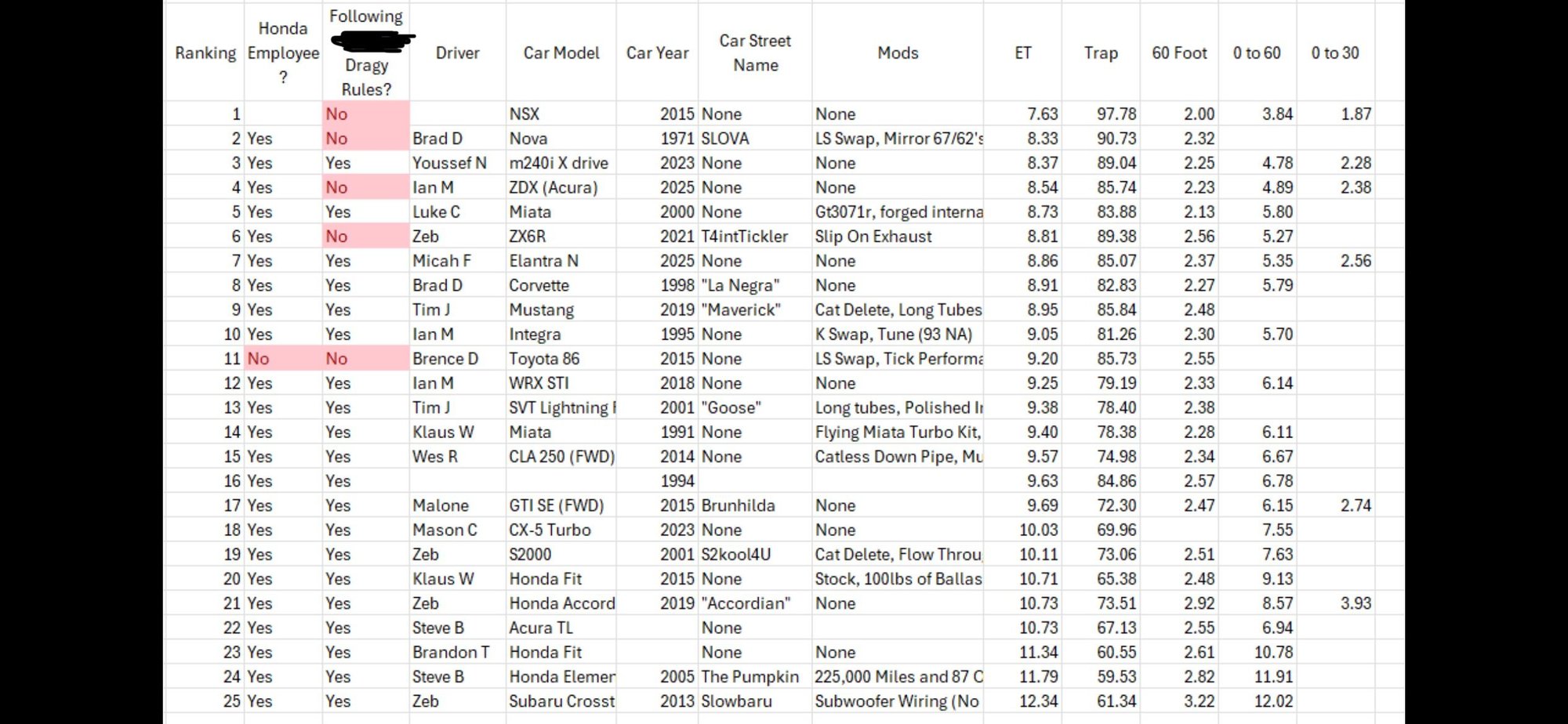

Me and my group of friends are super slow, I just want to do hard tire autocross/grandchampion stuff.
My circle of friends with autocross I think I may be competitive just NA with a 408
I think I like the laggy feel but may try the 67/62's since it's on the car already.
This past LS Fest east a bunch of people punched into the 9's (1/4) a good bit. I'd really like to just creep up to a 110~120 mph 1/8 mile trap on street. I know I need to work on 60' times
These are my circle of friend's times. Kind of feel like I can be competitive with just a 408 NA. But I'll try and run these turbos and will see what happens
The time under for my car was at LS Fest with soft timing and low boost on a 4.8. 8.33 et 60' of 2.32
Best time was 7.45 (1/8) on a hard tire 5.3 on 8lbs at 100 mph
