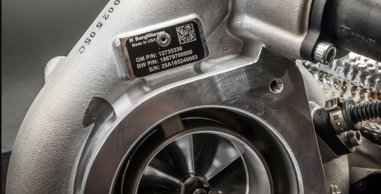

Heard many say these aren't legit 76mm turbos and they they basically lied to everyone. The rumor is the new turbos Borg produces are using the exducer size of the turbo to classify it. So that its likely a 56/76 compressor or similar and not a legit 76mm unit. same with the 67mm turbine wheel. Any facts on this?
I was able to find the borg warner PN. Its 18679700009. But of course there is no infomration this thing anywhere other than many mentions of it being a "76mm unit". I thinking the rumors are true.

Don't believe so. At least not the Borg turbos I bought. They always did it with the turbine wheel, not the compressor. My S475 had a 75mm inducer and a 100mm exducer on the compressor. So do I get to say I have twin 100mm turbos now? lol. I guess thats more impressive sounding.... My S480 had 110mm exducer... its that a 110mm turbo now?
IDK just rubbed me the wrong way I guess. Thought it was crappy that GM is claiming they have massive 76mm turbos, and even bragging they are the biggest factory turbos ever installed on an OEM car... when they really don't.

You are correct, just the turbine was that way, but only on the S series stuff for some reason (probably just different engineering team bs). IDK the GM turbos have to perform decent to make the power they do on a 5.5l v8 using high flowing heads and high rpm they are running. They might tap out early when turned up though, but I don't see any OE company wanting to deal with turbo lag on a production car. Looking at the photo of the turbo above I'd guess GM is tapping into some of the EFR tech it looks like one.

yes. the turbo is almost same as EFR7670. ZR1 uses smaller turbine side, i seen somewhere say it was 67mm in their data.

The "EFR7670" is really a 57/61. Sounds about right to me. I'd be suprised if it were a 67mm compressor.
Old Jan 26, 2026 | 12:31 PM
TheWrathofDan's Avatar
Joined: Mar 2021
Posts: 57
Likes: 11
From: Skodberg
67mm turbine side not 70mm as per efr7670
