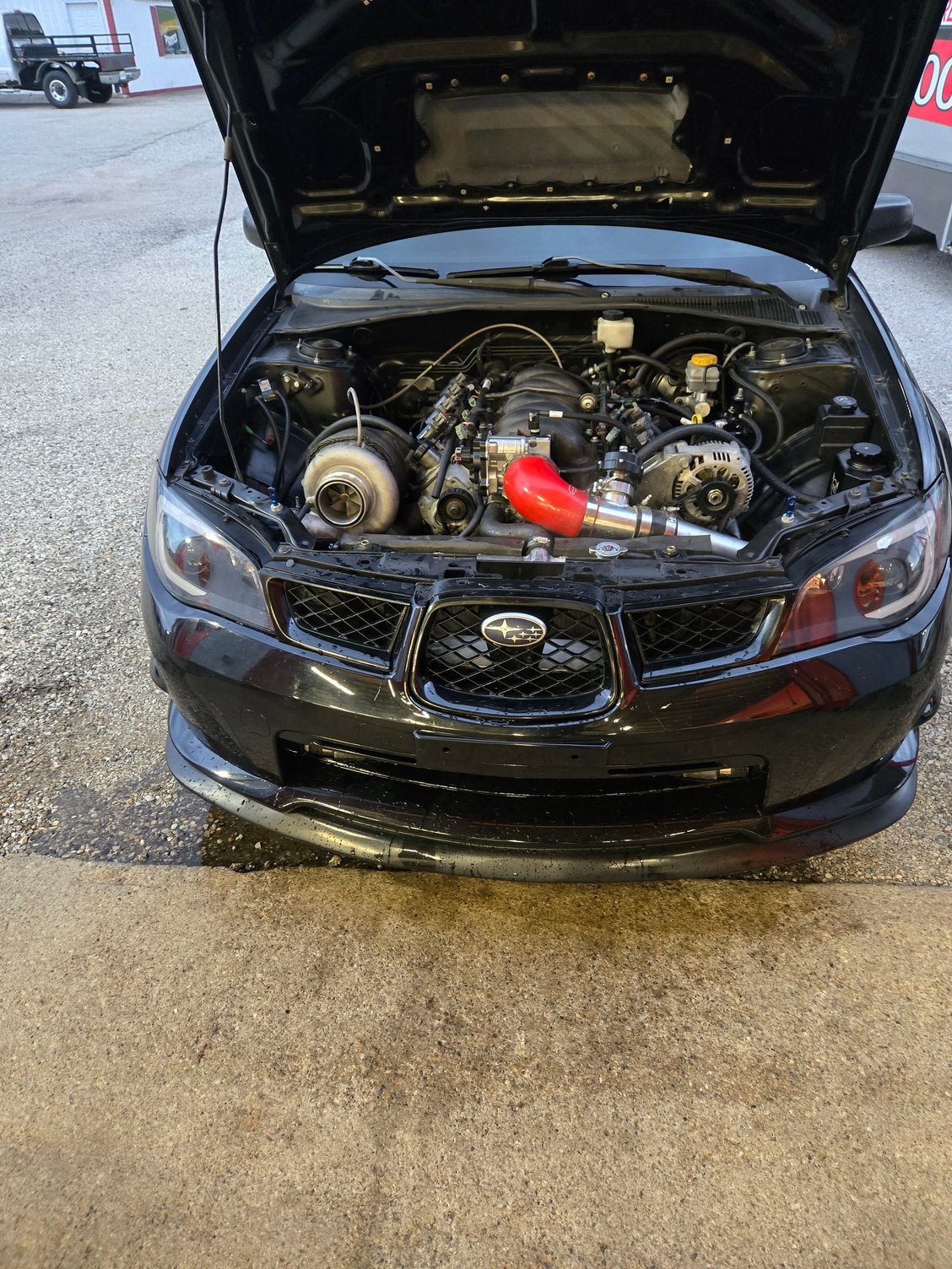

Just got a pulsar 7375 compact for my 5.3 swap car.
When I first built it I had a gen 1 7875 vs racing boy on it.
Then swapped to a 3584rs. The instant boost is nice and since its a street car should just leave it alone but i cant so I picked up this pulsar to see what thats like
Baby turbo next to the new guy

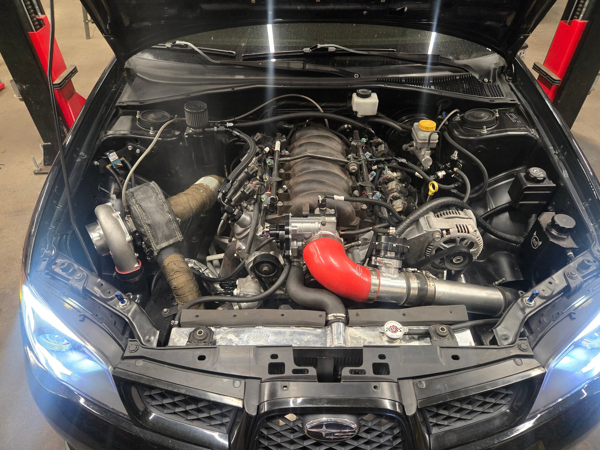

Its a rod/piston 5.3
summit 8715R1
Tremec magnum
Version 1 with 7875
Version 1 with 7875
Version 2 with 3584rs

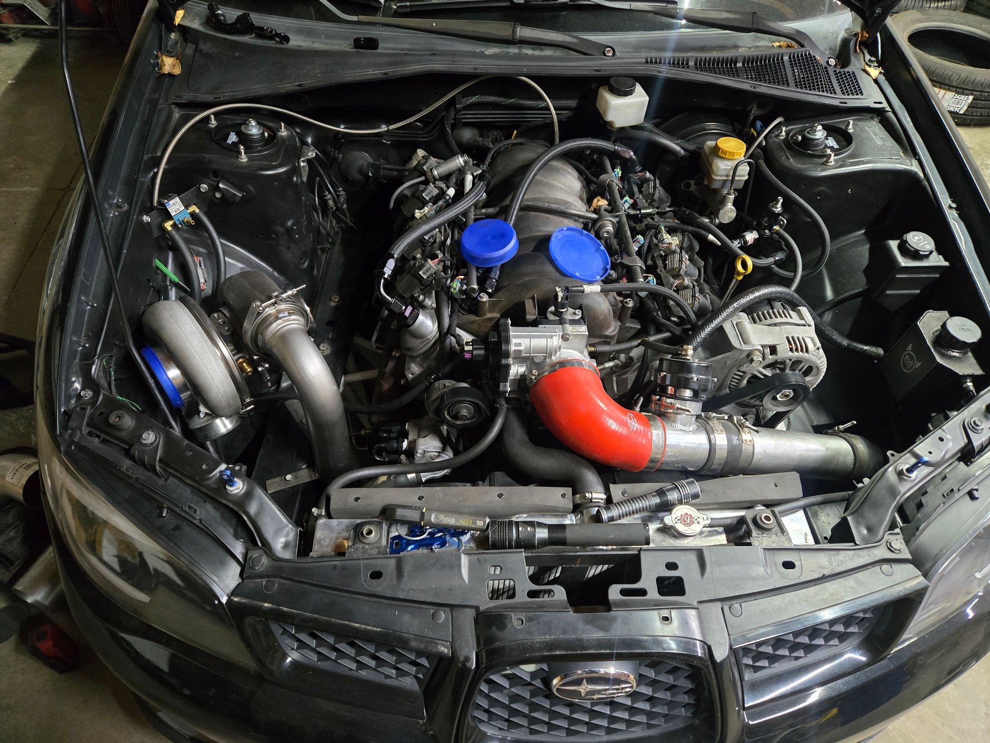

Progress of version 3 with 7375. Still gotta fab rest of exhaust off turbo. Fitting a 4in is gonna be tight

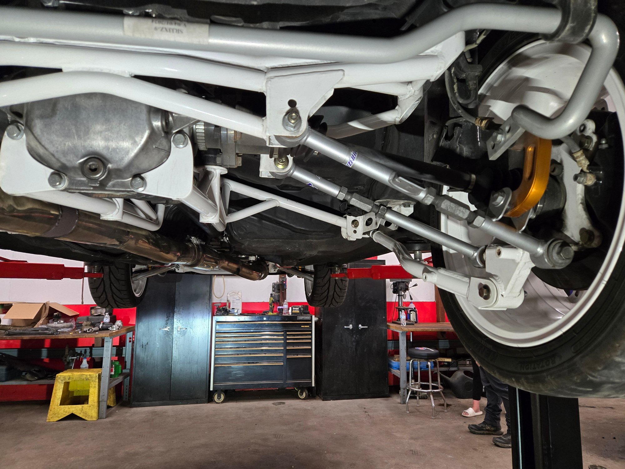

That thing is sweet! I'm guessing it's just RWD now? What are you using for a rear diff/axles?
Old Jan 28, 2026 | 07:41 AM
Bbknucks's Avatar
Joined: Dec 2022
Posts: 444
Likes: 158
Yea rwd. Diff and axles are from a 370z

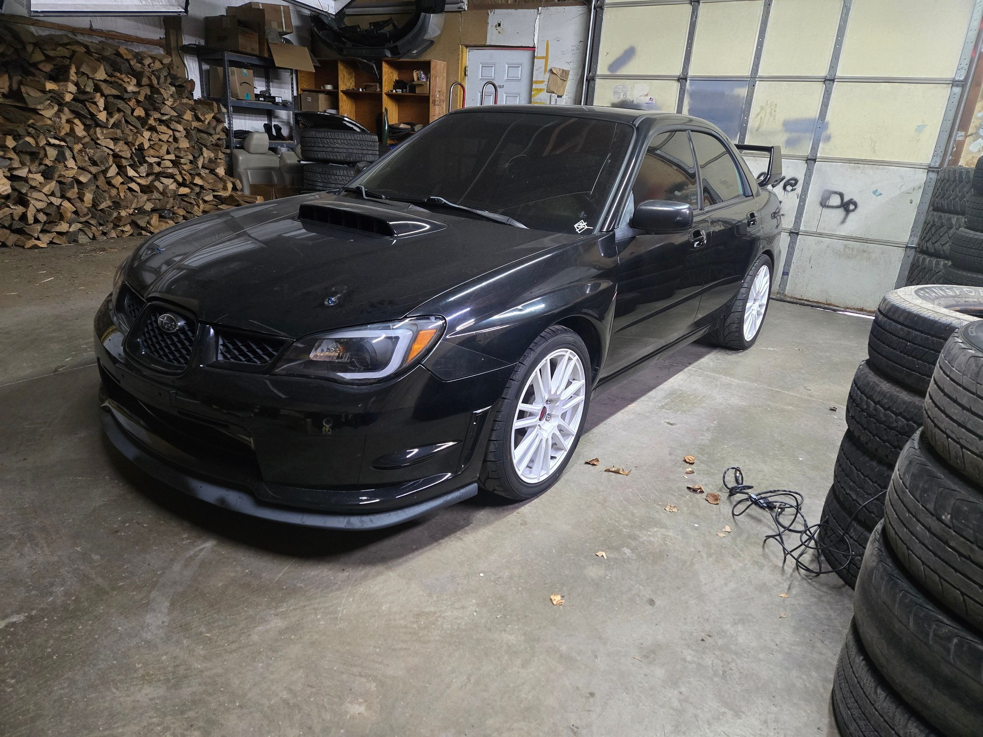

Its unassuming all closed up. Probably gonna be a bit louder with the full 4in exhaust vs the 3 on it now

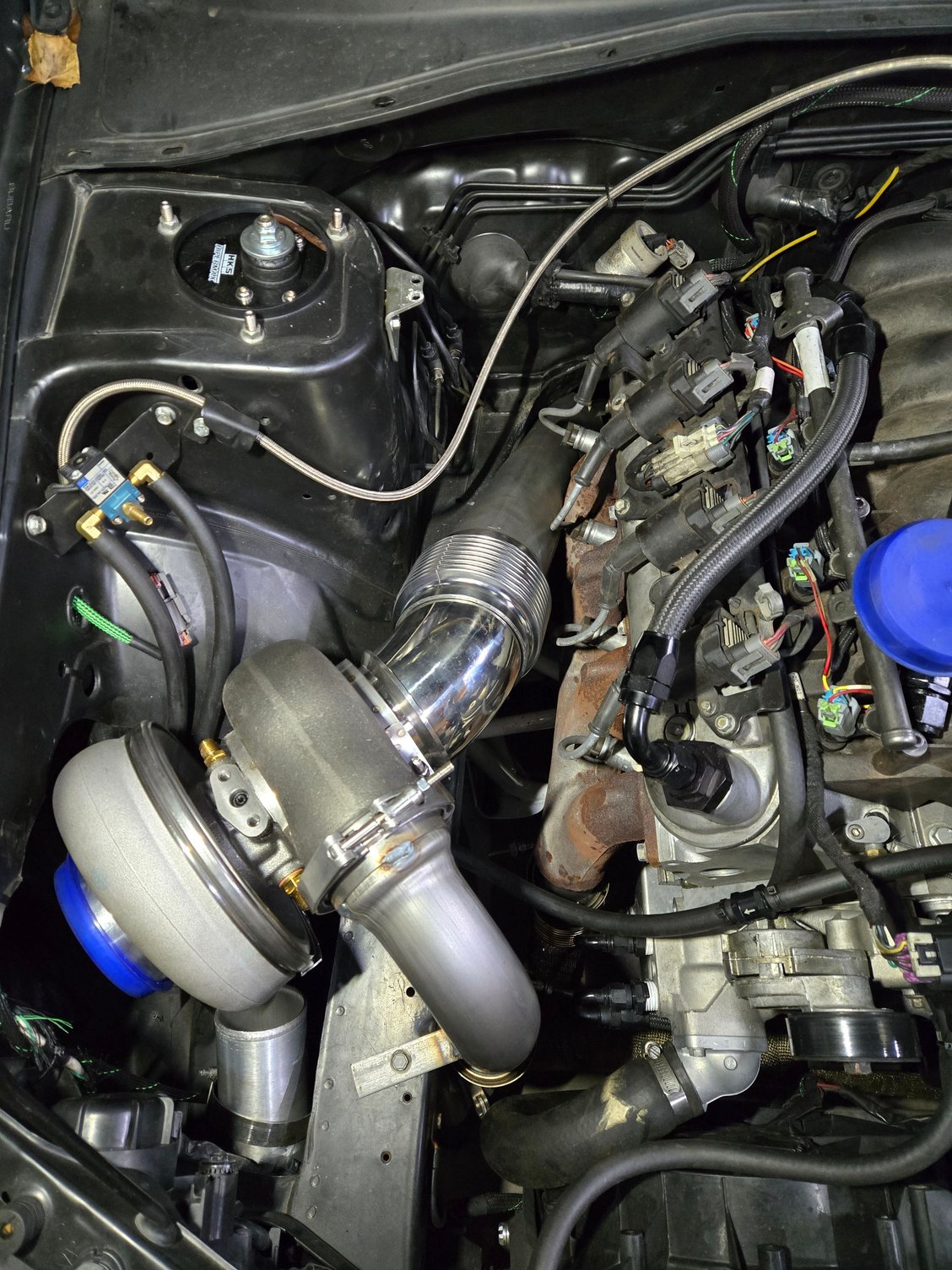

Old Jan 29, 2026 | 02:19 PM
Bbknucks's Avatar
Joined: Dec 2022
Posts: 444
Likes: 158
Started mocking up the down pipe . Gonna need to smash that pipe a bit more for clearance

I had another question, is that rear cradle an off the shelf swap piece?
Old Feb 11, 2026 | 08:54 PM
Bbknucks's Avatar
Joined: Dec 2022
Posts: 444
Likes: 158
I haven't had much time last couple weeks to mess with it.
Being a dad and a responsible adult is really ruining all my play time... haha
And I need to finish up the 2650 install on my buddies obs 1500 lt4 swap truck.
The cradles front and rear are made by a guy in Washington tssfab.us. he makes alot of quality subaru bits.
He now makes a cradle that will hold a ford 8.8
