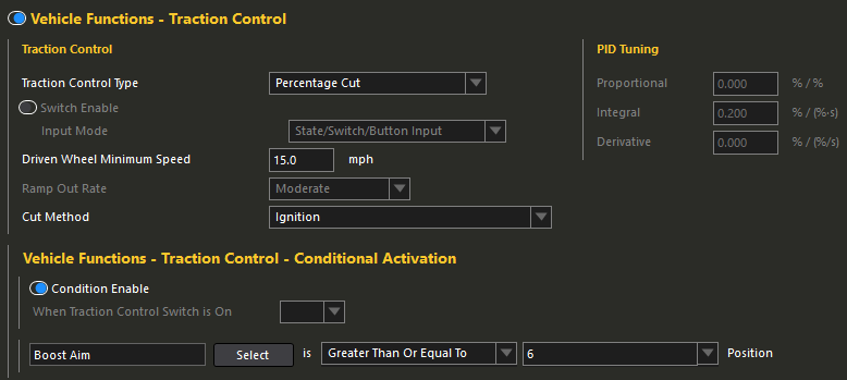

Originally Posted by Black_Sunshine_99
I added a rotary switch to my Haltech but I haven't decided if I should use it for boost profiles or traction control. Still kinda leaning towards setting up traction control but sounds like it's a lot.
Here's a neat trick, you can use a single rotary for both so to speak. You can setup a trigger for your traction control to only activate above a certain rotary position, and also have that same rotary reference your boost settings. As an example, rotary positions 1-6 would be your boost curves with TC off, 7-12 would be those same boost curves with TC on. Or you can even link it to various TC slip profiles.

With the Haltech you can really get into the weeds with how you configure things, it can be as simple or advanced as you care to make it. Something like this...
