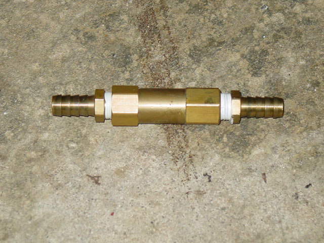

Do you have a check valve on the PCV line? Do a search in here for mcmaster check valve and you should come up with a part number for a nice one. Where does the fresh air line route to when the switch valve detects boost?
**edit**
www.mcmaster.com part# 7775k52 It's a one way check valve. You'll need to get the hose barb ends to connect to the PCV hose also.
Here is a pic of the valve with hose ends installed.

I understand that but, the PCV line is hooked to intake manifold also and the PCV valve might not be stopping boost from entering the crankcase. It's best to put a check valve on that line also.

BTW check valves are not the way to go....most motors need good ventilation all the time. Under boost the valve closes not allowing boost to enter the crankcase yes...but...it isn't venting either!
Mark
