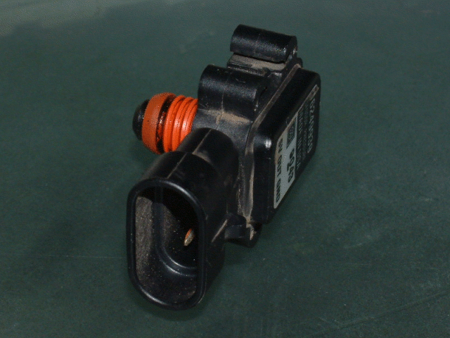

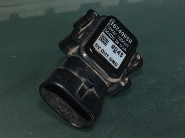

This is off a 99 6.0l... Being 6'4" I'm not going to try to pull the one off my 01 until it's dire.
This look like the 98??
Old May 17, 2005 | 10:18 PM
Lostpatrolman's Avatar
Posts: 370
From: Largo, Fl.
I just checked my 98 map sensor and the sensor that came with my ls6 intake. They are both the same. Both sensors have 3 male pins.
