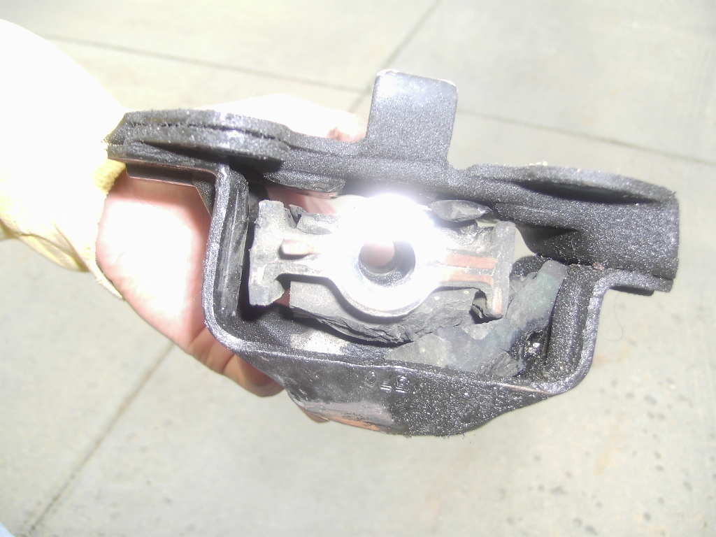

I'll say, this has definitely been a challenge so far. Quite a few problems to address. For one, my passenger side motor mount was almost entirely gone:
![](http://www.garysdecks.com/SS/2006-05-01/DATA0032.JPG)

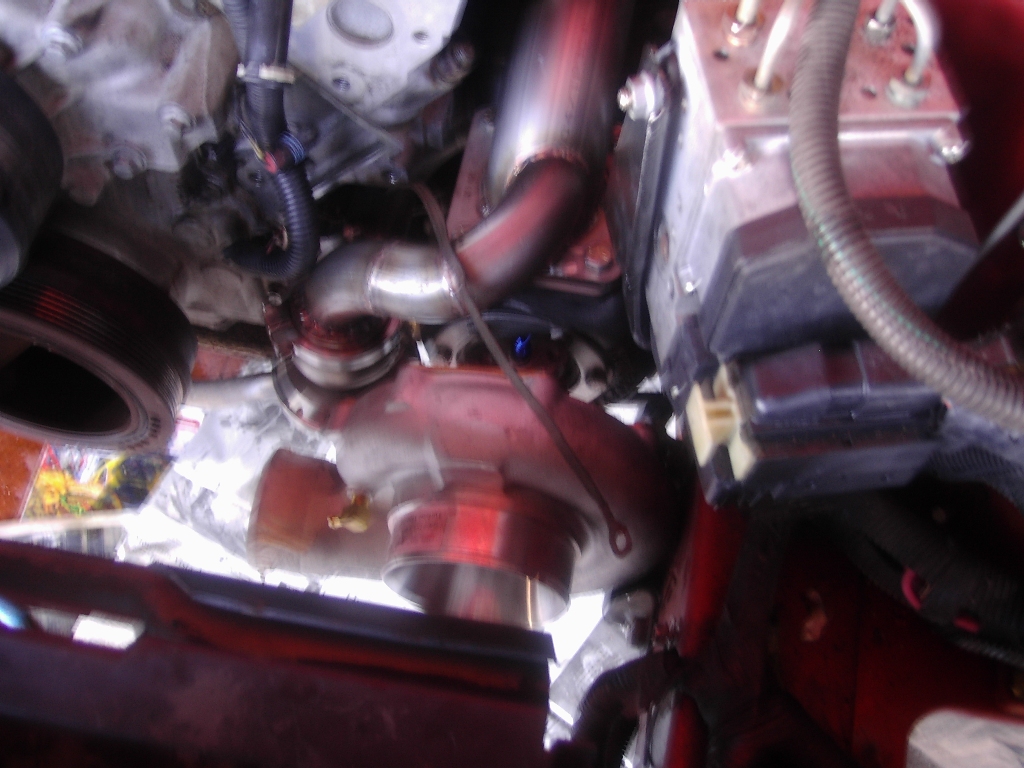

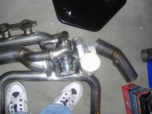

I've had to trim down the size of three of the pipes so far (ranging from 1" to 4") to make it fit.
Now for those of you that are wanting to upgrade to the 76, keep in mind that you WILL have some fitment issues. We had to pound about an 1/2" to an inch into the frame, along with installing some spacers under the drivers side k-member (provided with kit) and grind part of the steering knuckle down to make it all fit without anything hitting.
The power steering pressure line was a complete pain in the ***, as we had to bend it, install it, uninstall it, and bend it again repeatly for hours before we got it to line up without hitting anything.

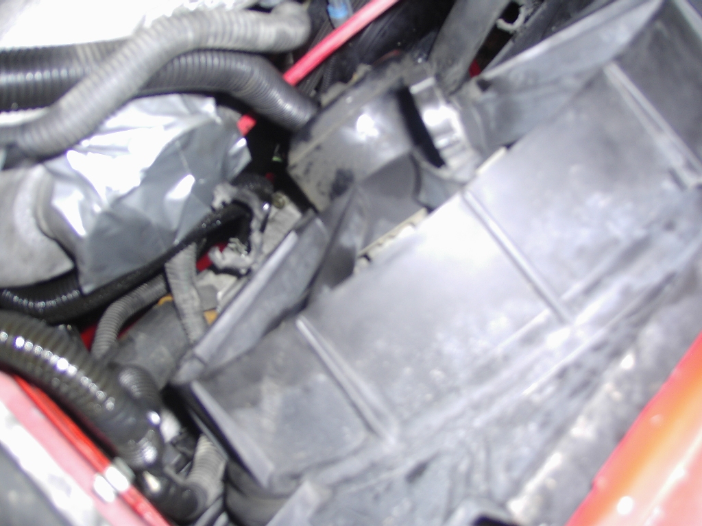

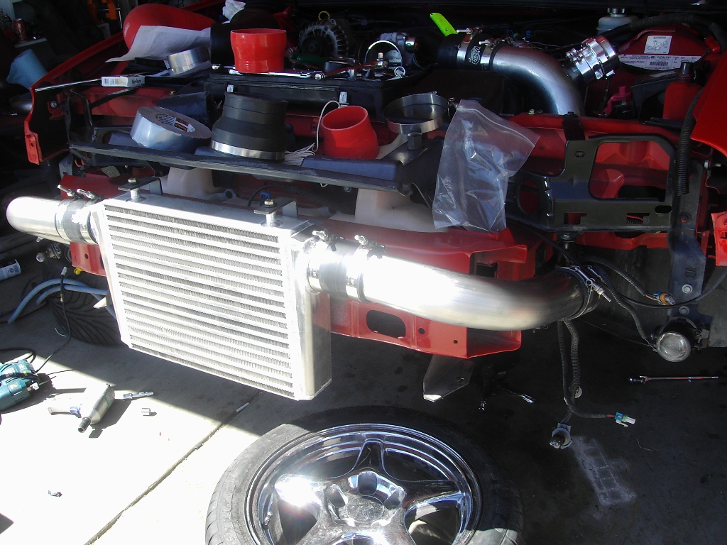

The next challenge is to find a small 90 degree reducing elbow 4" to 3" for the air intake into the turbo as this is a very tight fit:
![](http://www.garysdecks.com/SS/2006-05-06/DATA0016.JPG)
Hopefully, something like this will work:

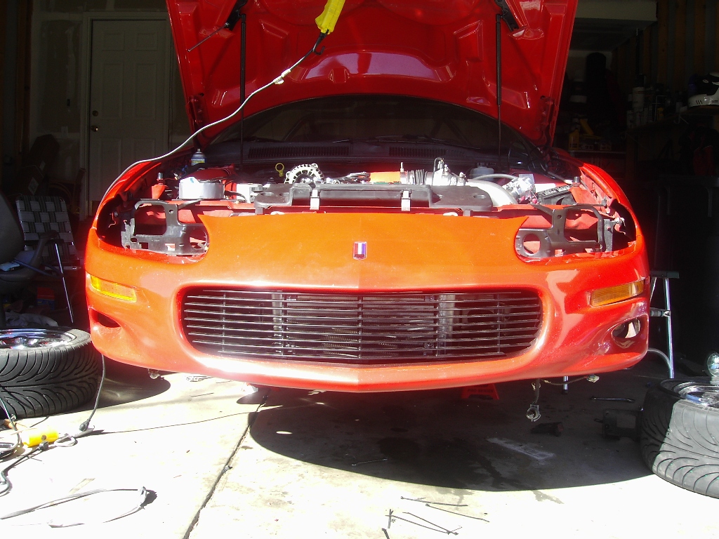

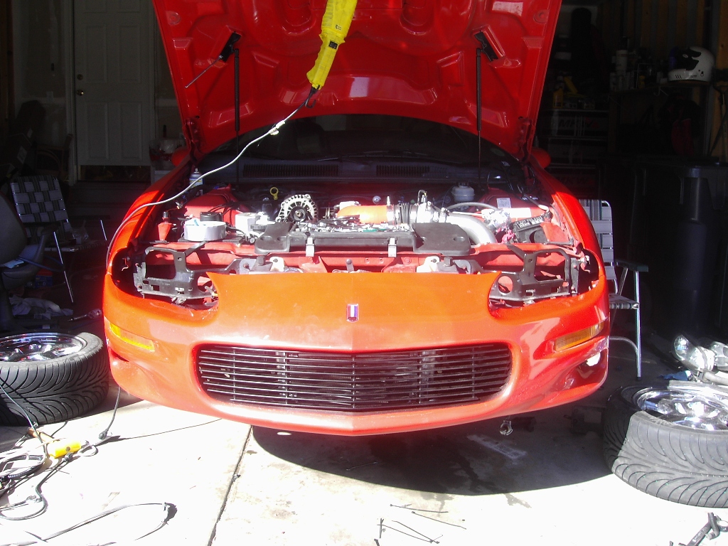

We cut up the stock bumper for the new grille, but I need to find something to make it look better. I'm thinking I can probably cut up the stock foam to put in on the sides. Then maybe spray paint the innercooler black. I dunno yet. I'll keep searching for some ideas.

Originally Posted by xssive
Did you try clocking the turbo inlet side volute for more clearance?
After this picture was taken, we pounded the frame in and it has almost 1/2" clearance:

Putting a T76 on this manifold definitely makes things VERY tight, but it obviously can be done
On ZAngel's car, we actually slotted the motor mount tabs on the K-member (tubular) and slid the motor over to the passenger side about 3/4" to get enough clearance.

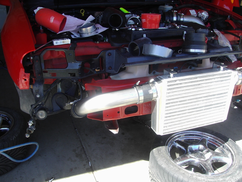

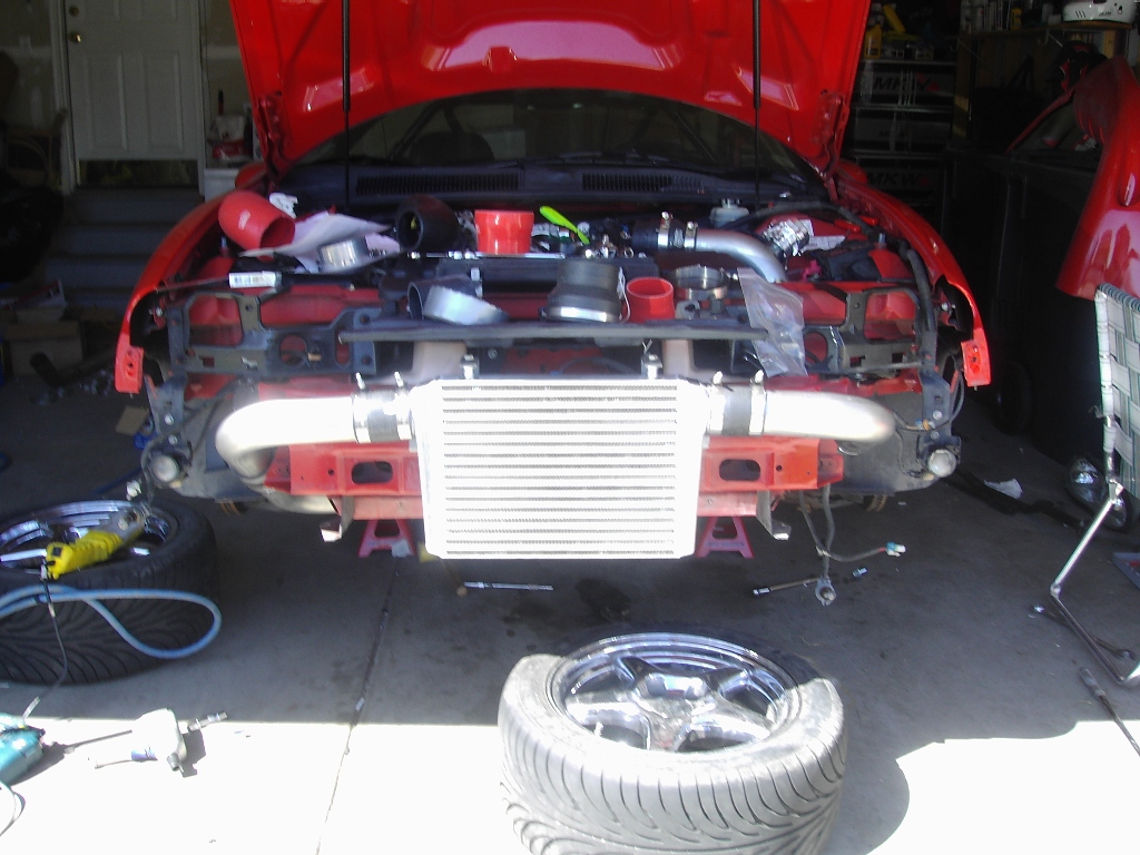

A few more pics updates now:
![](http://www.garysdecks.com/SS/2006-05-15/DATA0001.JPG)
![](http://www.garysdecks.com/SS/2006-05-15/DATA0002.JPG)
![](http://www.garysdecks.com/SS/2006-05-15/DATA0003.JPG)
We painted the bumped support and the inside of the lip for the grille a metallic black:
![](http://www.garysdecks.com/SS/2006-05-15/DATA0004.JPG)
![](http://www.garysdecks.com/SS/2006-05-15/DATA0005.JPG)
This is definitely more of the look I wanted as it hides the inner cooler somewhat and still allows full air flow.
