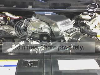

Moved it to another site, it should work now. Here's a pic since the video is crappy.

looks promising. Do you find the sheet metal TB connection to be restrictive? It looks thin.

Thats some good work getting that stuffed in the engine bay. A problem I see is there is not much belt wrap and there`s a hose going in between the belt so you could not add a tensioner in the longest run of belt. It seems like there will deffinately be belt slip under load at higher rpms.

Thanks fellas, I don't think the ducting on top of the blower will be restrictive, "technically" it should flow as much if not more than the 3.5" tubing in front of the TB. But I won't know til I get it on a dyno, but like I said I don't expect much on the dyno seeing how it's still stock compression. I might throw some race gas in it just to see what it'll do but I've definitely got to tear it down and lower the compression very soon.
And how much more belt wrap do you want?? It's wrapped a whole lot more than if I used weiand's complete setup with there tensioner.

I'd hate to guess how much it could make, it depends on too many things. These small roots blower aren't meant for really high HP numbers because they have to spin so fast for a roots blower and that heats the air up pretty quick. They are mostly meant for a pretty strong daily driver with lots of low end torque with otherwise tame manners.
