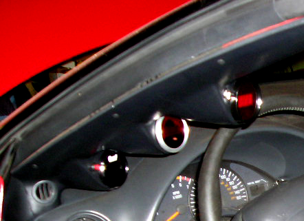

Originally Posted by jeremy02
I'd like to see some interior videos when running(tachometer, speedometer, other guages), pictures of the interior(aftermarket guages), and pictures and videos of the setup from behind the car, please!
Thanks.
Mine are in this order starting at the bottom:
-wideband
-boost
-fuel pressure
Buttons to the left just recall the low/high and menu settings, ect. I put an LED to the right of each guage and set it up so that if fuel, AFR, or boost goes over a certain amount, it lights up.
The only thing you cant see is on the right side (towards the driver) is another LED and purge switch for the meth. The pillar pod is from autometer
