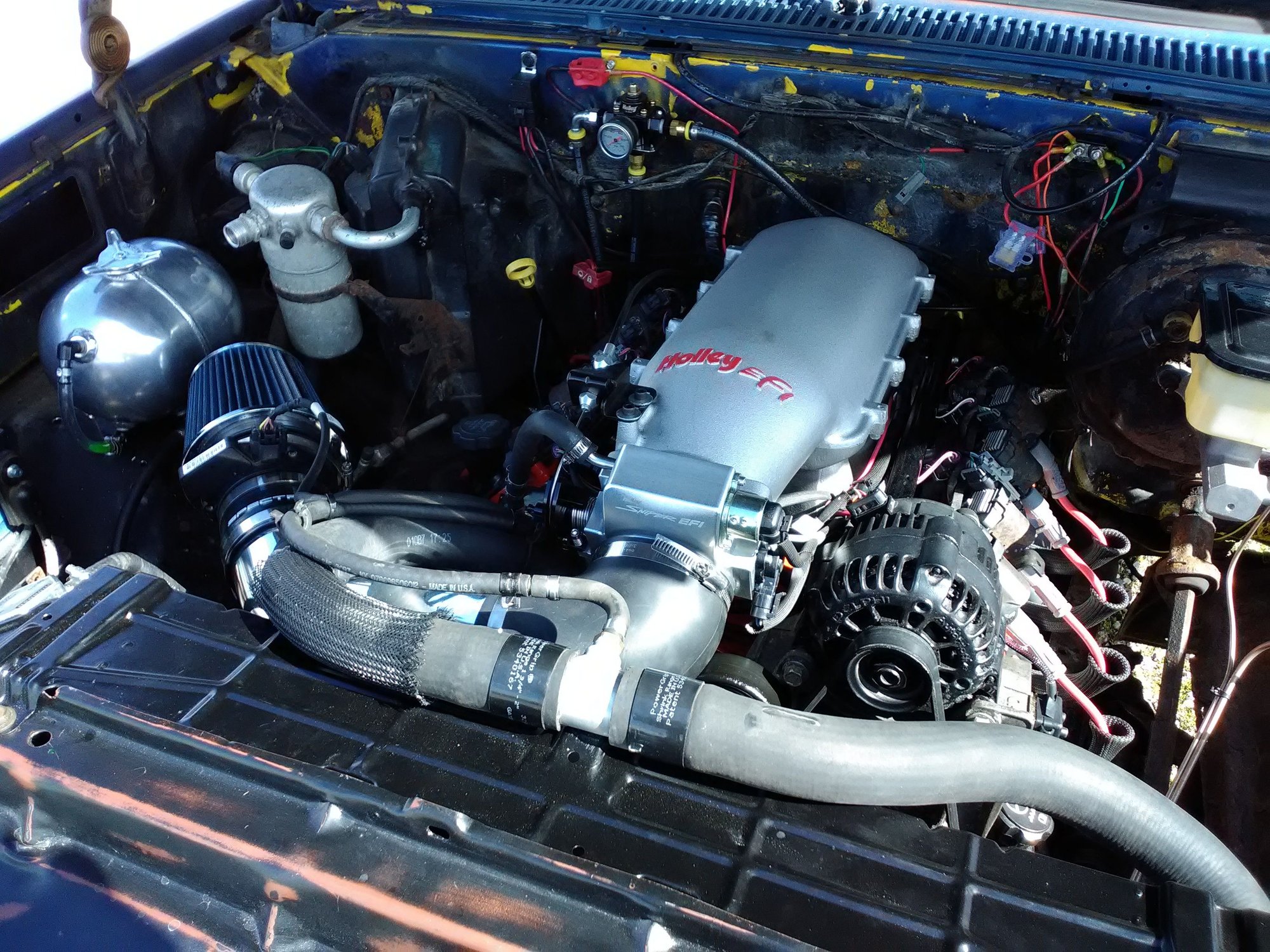

I have a lq4 all new internals with stock pistons. 223 X 600 Cam 42 lbs injectors and long tubes, when I had the engine dyno tuned it had stock truck intake and tb . The tuner guy said it was being restricted by tb and intake. ....so I put a Holley high ram and a 92 my tb . Now I lost all my bottom end.
*****can a tune shop tune the bottom end back into it. If not what are
your recommendations

Holley Hi-Ram killed the bottom end. A FAST manifold would save it and add to the top end. The truck intake is actually a good unit. What numbers did you get from the dyno?

With the short runners on that intake, it will be VERY hard to regain the bottom end power you had.

Large displacement high-revving racing engines. NOT a good street manifold.

Yeah, that intake manifold is terrible for 99% of the regular old combos that people try to run. Run a stock intake or a FAST and be done with it.

Tbss intake with the 92mm tb. Best all around intake.
3600 converter with some gearing would help as well!
