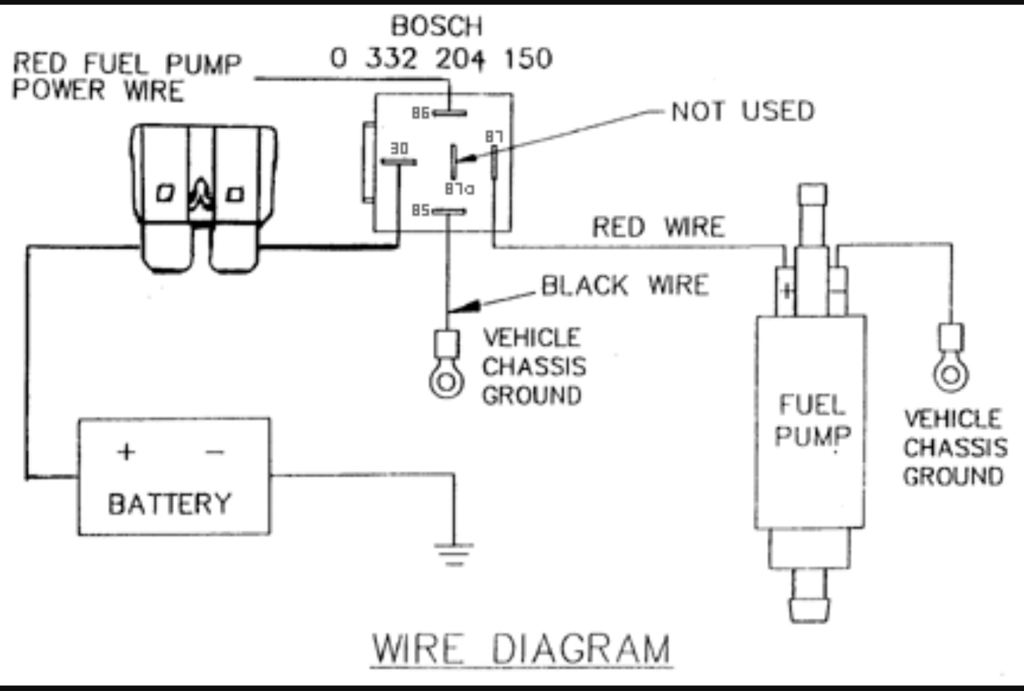

I currently have a single 255 Walbro with Racetronix hot wire and Im planning on leaving it as is.
I am adding another 255 pump and it will be using its own wire. I will have a fused power wire going to the battery. My question is, what do I do with the other wire?

pretty sure this is what I need to do. I got a new wire with the new pump. If im understanding this right, Im going to cut the connector off at the one end ( not the end that plugs into the fuel pump itself) then take the negative wire and ground it and take the positive wire and run it to a new relay and then build what is shown here in the diagram and the new pump should be good to go.

I apologize. Quite often im so busy with everything i use my cellphone to call customers back. I of course have to block my number, so itll come up as unknown, blocked, unavailable etc. Then when theh dont answer i leave a message. But most of the time, i cannot because their vm is either full or not set up. Not saying this about you personally just to give an idea.
Anyway, lets take a look here.
Youre using an inline pump or another in tank pump?
Are you trying to pass it through the existing bulkhead or? Thats just a generic diagram so hard to tell.
Also, first, what power are you looking to support and what application?.
