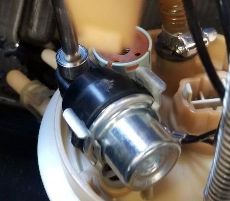

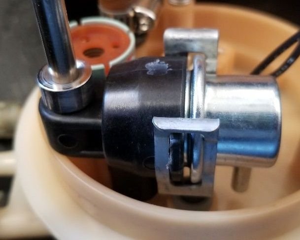

I cut mine off.

What do you mean, by "cut it off"?
I know I could "pop off" the silver colored diaphragm housing, but that would have fuel spraying all over the place. I wonder if there is a spring and diaphragm inside of it, like my Aeromotive one has? If I went that route, just remove the spring, check ball, whatever, and use it as a empty housing to direct the fuel back down into the bucket like stock?

I cut the black housing off of the metal rod. I installed a Racetronix 340 kit and it came with a return hose that clamps to the end that will be exposed when you cut off the housing. I think I have photos at home that I can post this evening.

Update:
Installed the new 340lph Aeromotive Stealth pumps this morning.
With BOTH regulators still in the mix, but the Aeromotive regulator's pressure adjustment screw totally backed out (ie; non-functional), the pressure would not go lower than 65 psi.
Popped the whole bucket assembly back out
Dis-assembled the factory regulator, so that it was non-functional
Aeromotive back in the mix, and fully adjustable, working great by itself.
I didn't concern myself with how, or where, the return fuel exited the gutted stock regulator and back into the tank, since the factory bucket has long ago been butchered and has not been an actual "fuel bucket" for a long time anyway.
FWIW, I've never really had any issues with a Walbro, but they advertise them as not being E-85 compatible...
As a side bonus, the Aeromotives are actually quieter than the Walbros were...I guess that's where the "Stealth" name comes from, lol
