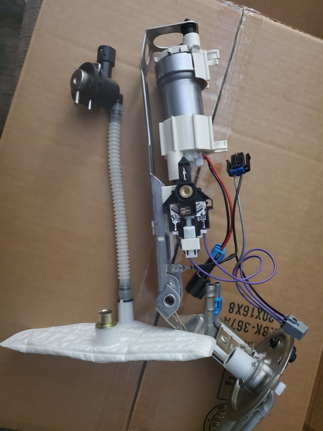

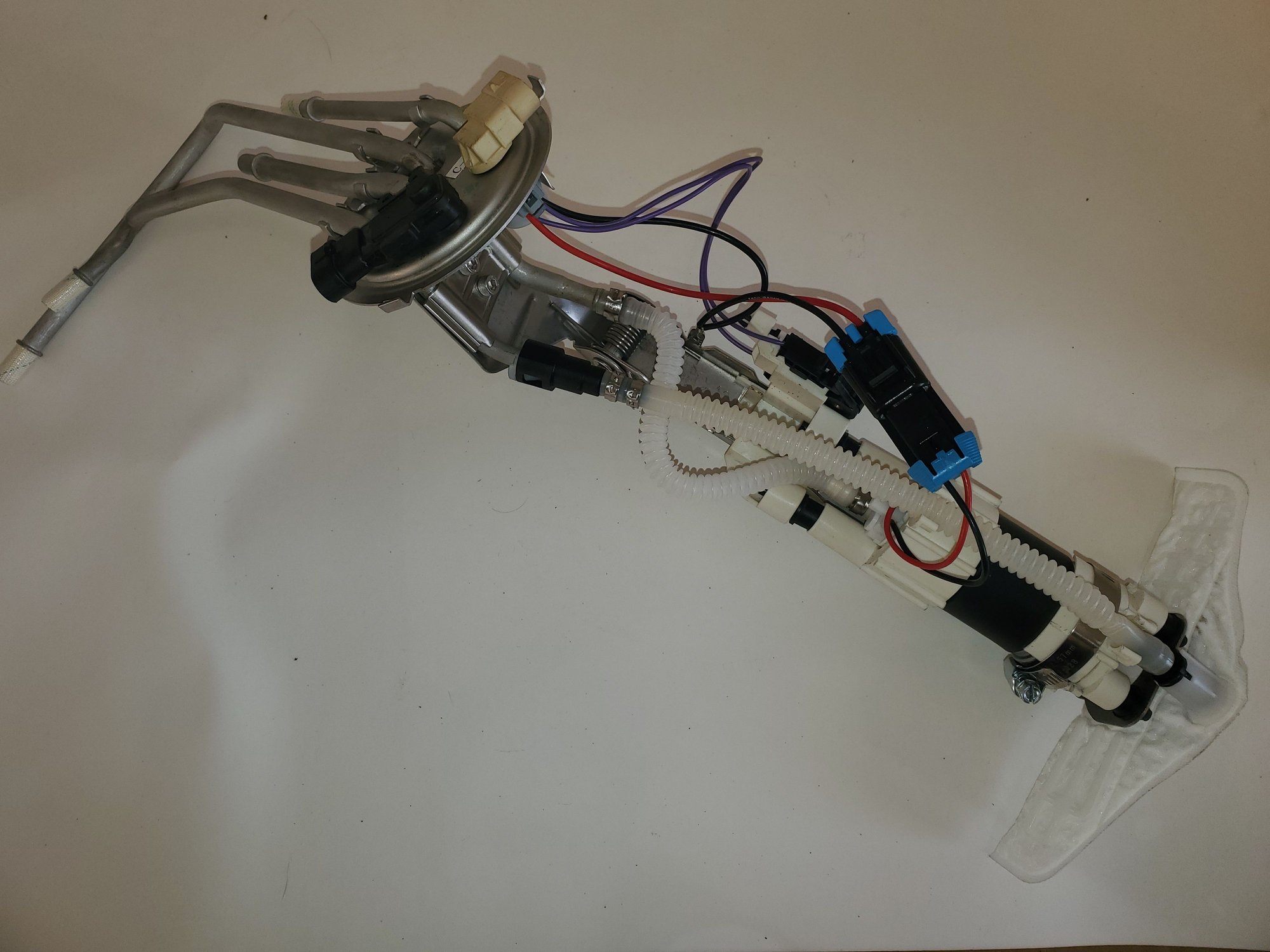

Just a little picture to help feed your imagination.
In case you cant guess thats a Hellcat pump in a 98 module.
We will be offering these as drop in complete modules only at the moment. There are too many different module designs to allow us to have them as a pump alone for sale in this setup. We will have 98 hellcat pump and hotwire combo options but the modifications will be up to the end user there with no instructions.
Brand new gm modules will be used.
We will have 340 kits available as well.
This is just a preliminary/prototype so its still kinda rough.
No one can "have it for free" or "try it out"
These modules take quite a bit of time to make, no need to joke around about them.
They will also offer a complete wiring harness with new style bulkhead that must be bought with the kit. It will only be sold together. Still plug and play, drop in and go with either an adjustable external fuel pressure regulator or c5 filter reg kit.
Ill post more pics when its near completion with the harness. They will come with the complete harness from bullhead on car to pump and hotwire kit.

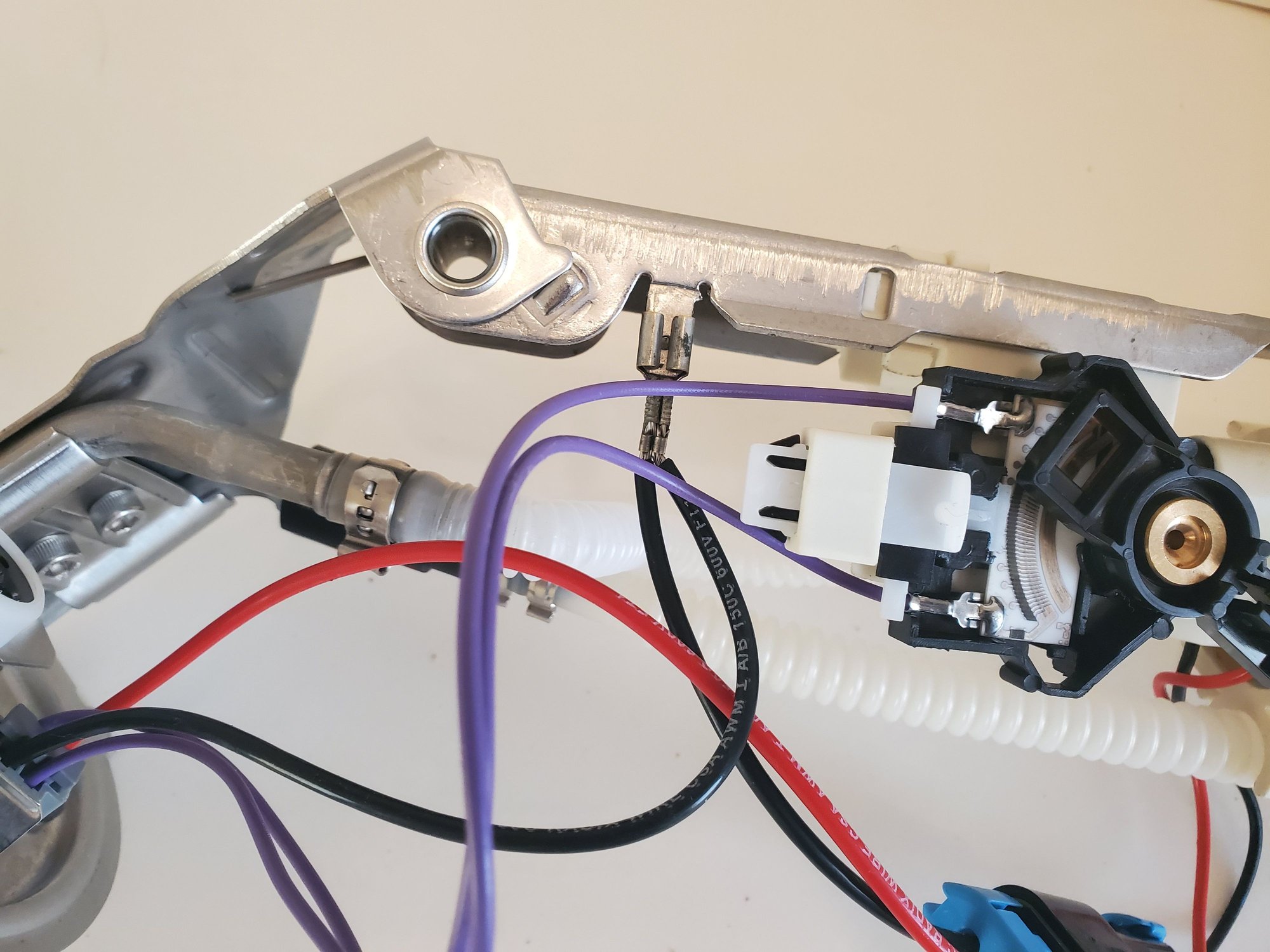

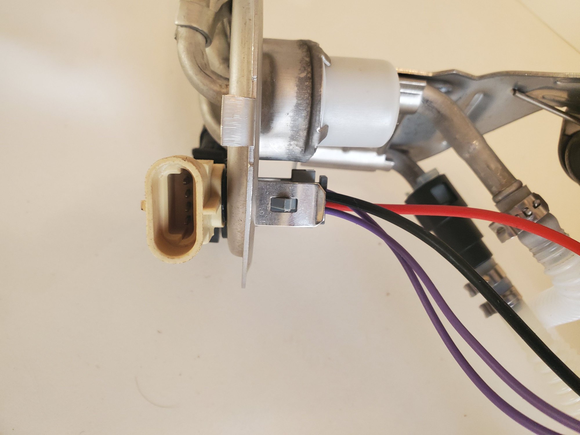

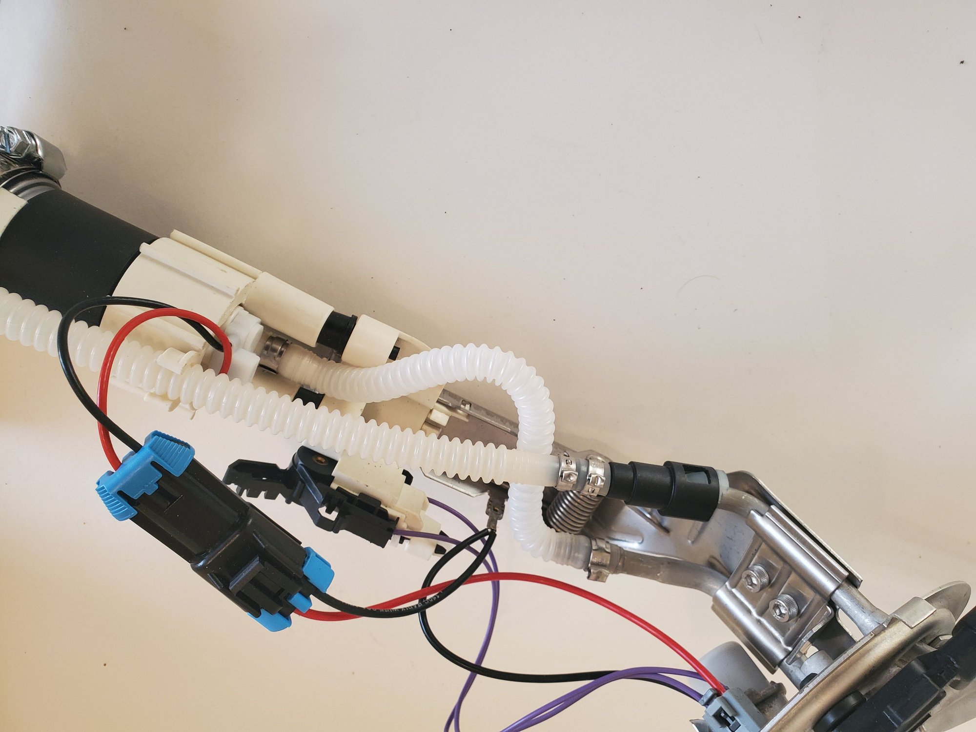

Completed!
More info Monday for pricing. This will require a specific hotwire harness that will ONLY be sold with the units. You cannot purchase separately.
They will be 100% plug and play no repinning necessary. Includes new heavy duty bulkhead.
We will have 255/340/and the hellcat options.
255 and 340 will work with factory regulator.
The hellcat can use the c5 filter/regulator kit, external regulator or complete fuel rail kit from Racetronix. We can modify the 255 and 350 for external regulator also for same price if you want to use the c5 filter kit or an external regulator.
These are brand new GM module assemblies also. We will use them until the supply runs out then we will use an aftermarket unit there.

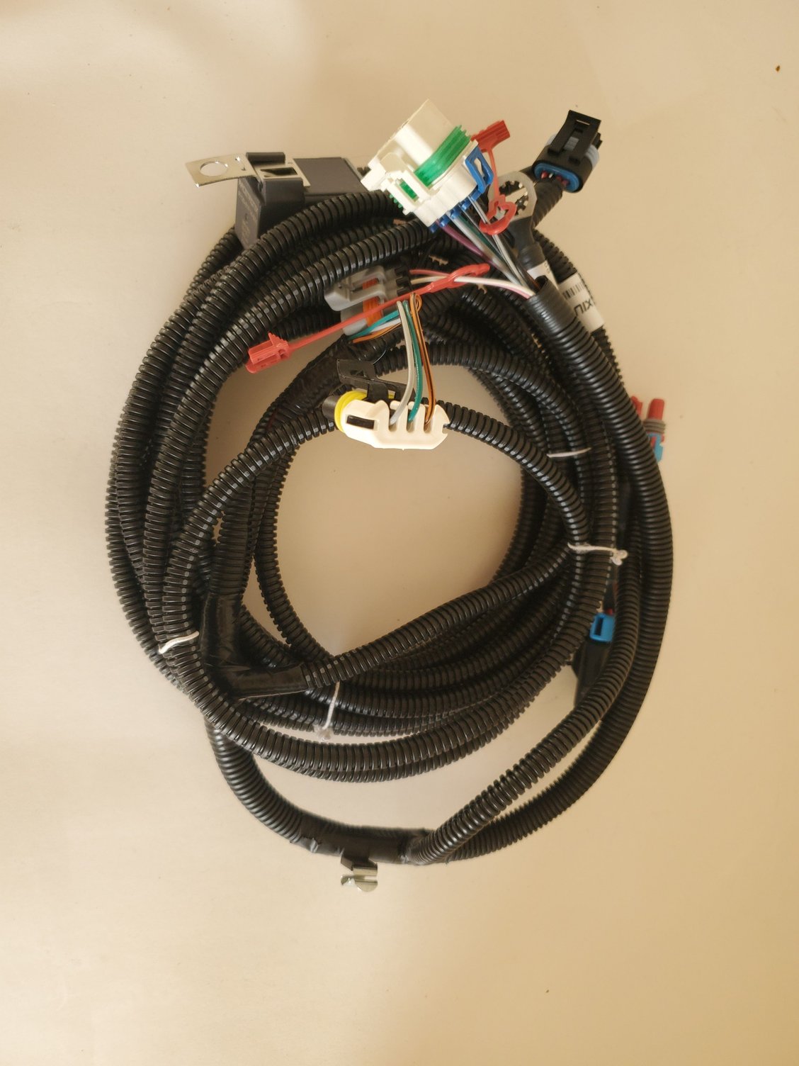

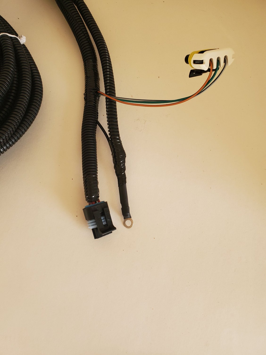

Here is the hotwire harness done.
You cannot use any existing hotwire harness you may have and these modules will only be sold with the new hotwire harness.

You can upgrade to them but they are so overly expensive just for a special sock, it's not worth it to me.
The way the 98s are fed directly on the return they wouldn't be an issue.
You can see that in the pictures.
