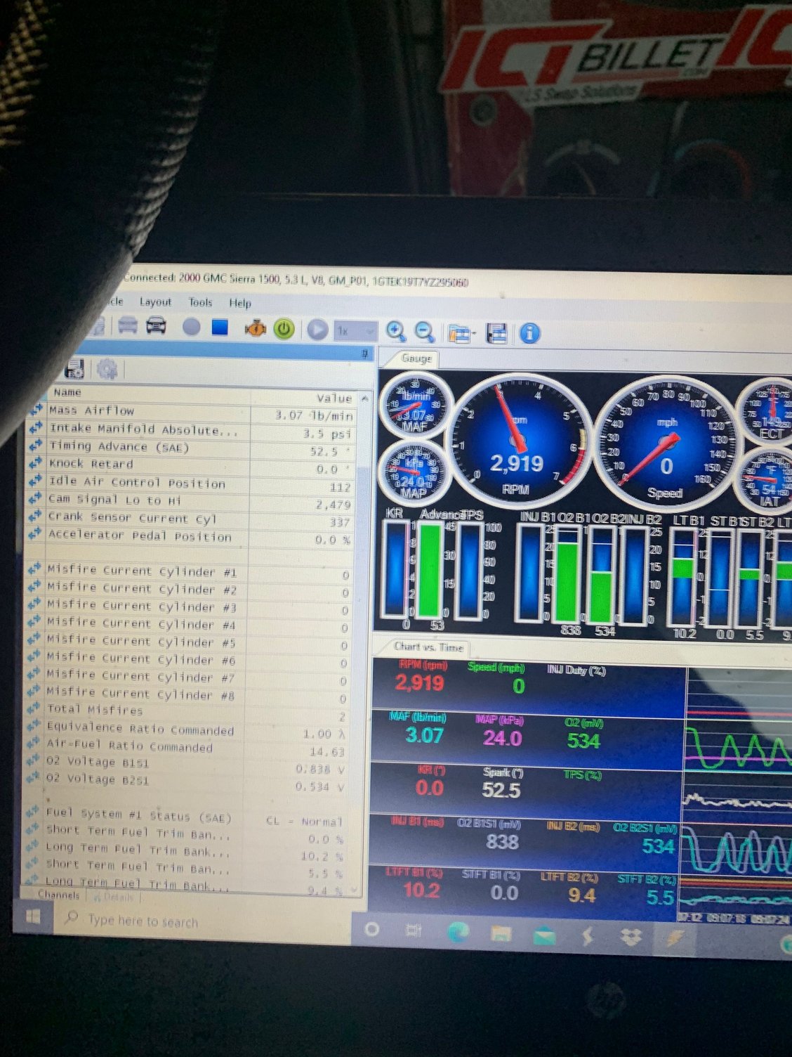

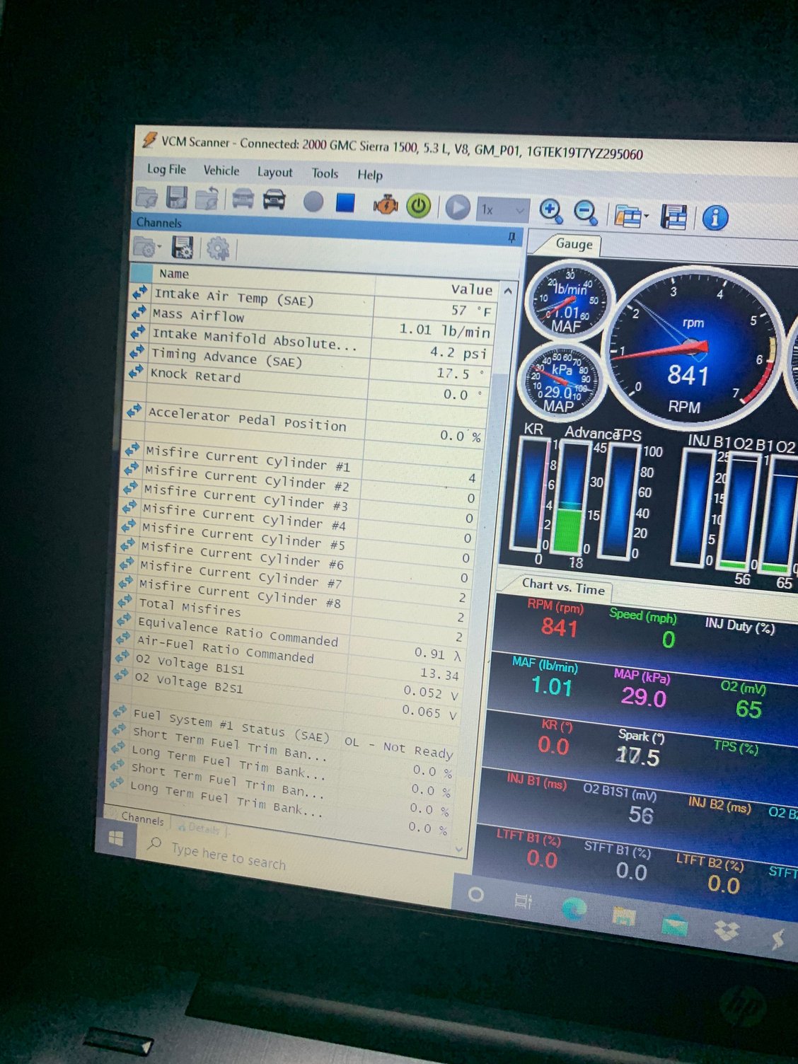

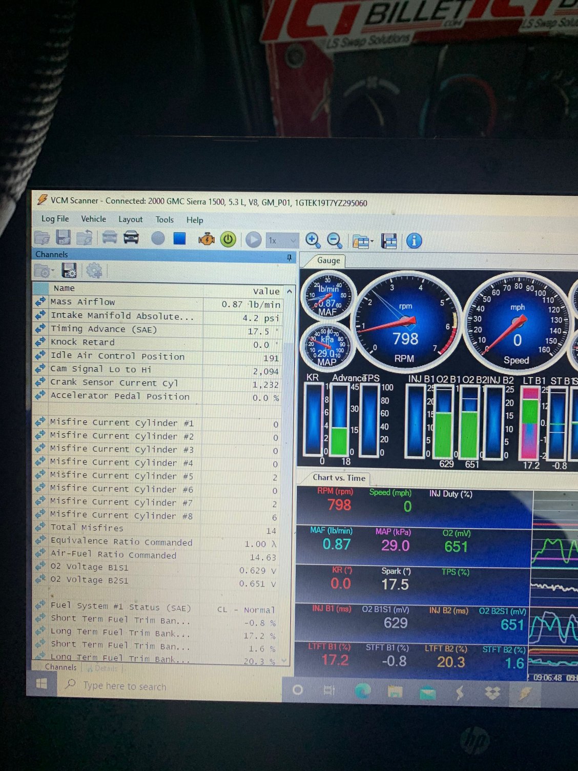

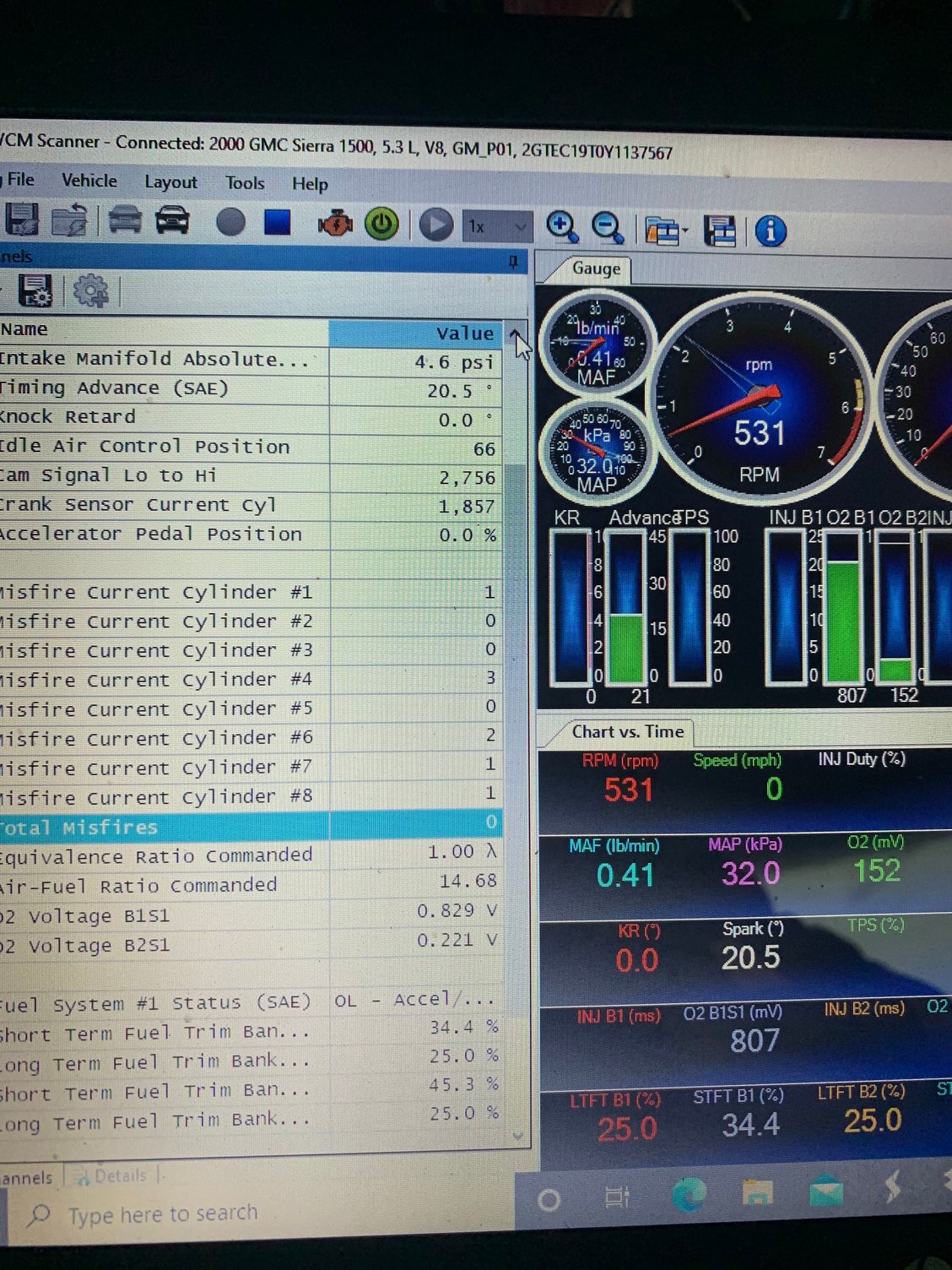

Tried a new pcm and new tune and the problem is worse than ever. I’ll insert a picture of hp tuners scanning. It is so far lean now.

Why are you in Open Loop with every HP Tuners screen shot? Do you ever go into closed loop? Are you running some kind of a cold air intake?
Rick
Rick

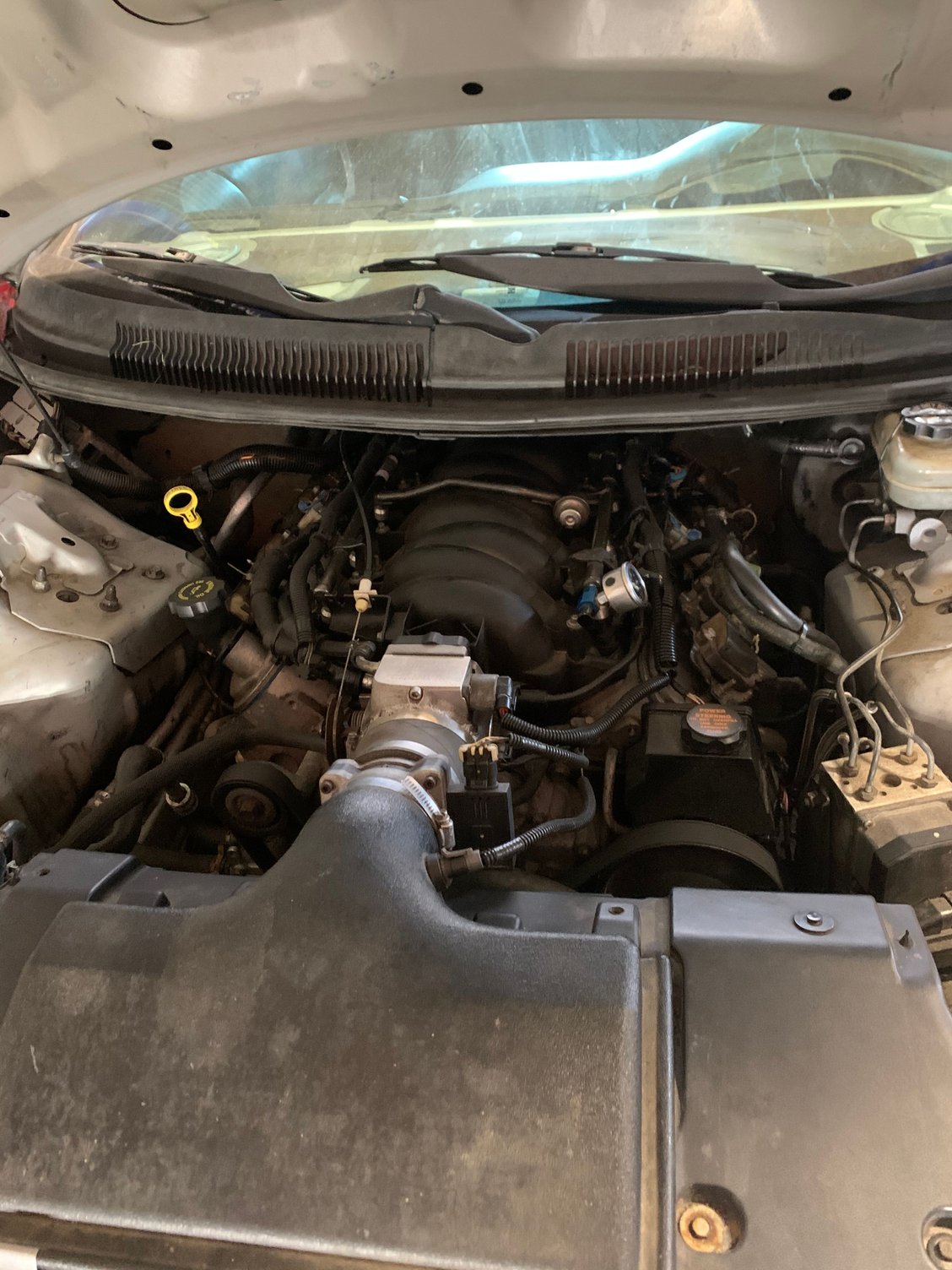

it will go into closed loop and I can force it too as well. Conditions are the same either way. It has gutted stock air box with a smooth lid.

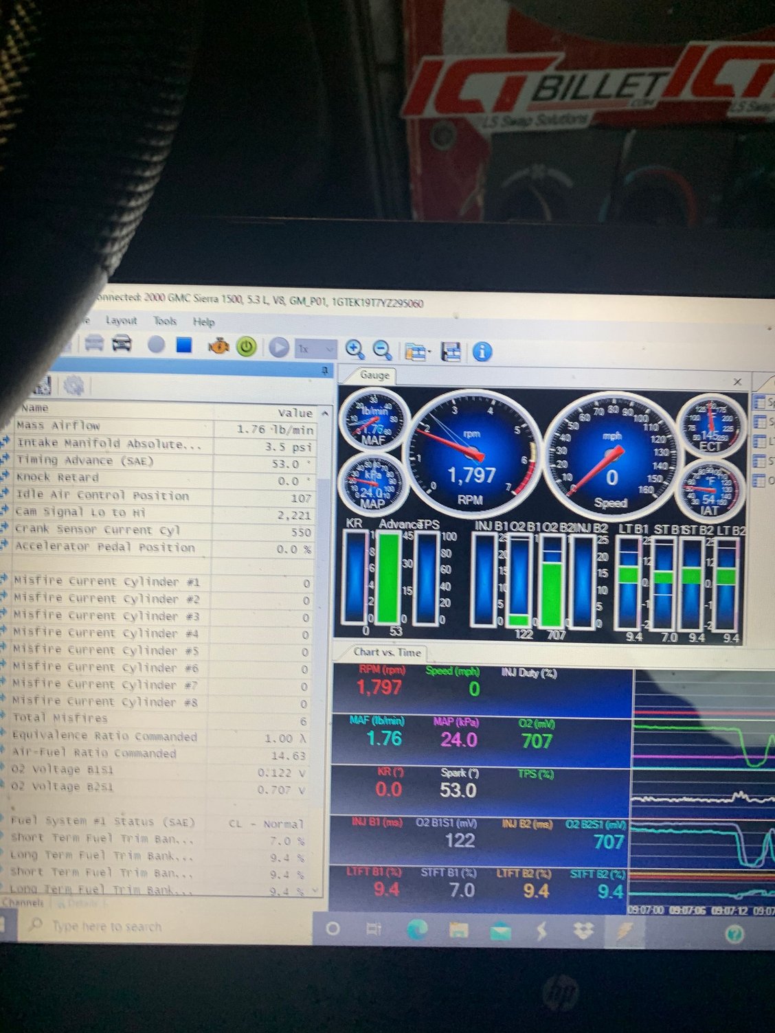

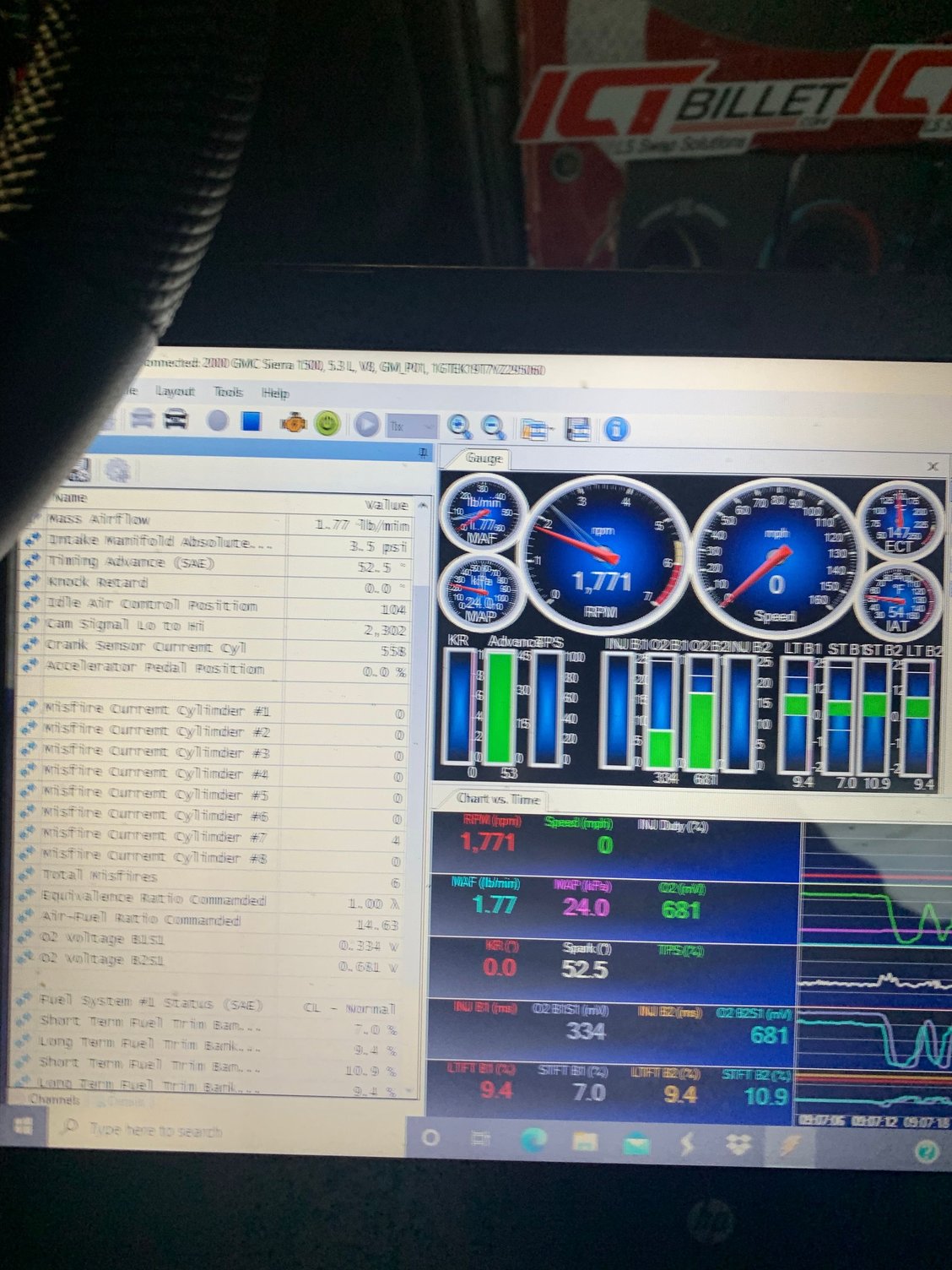

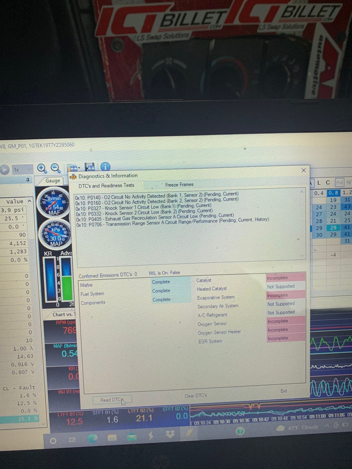

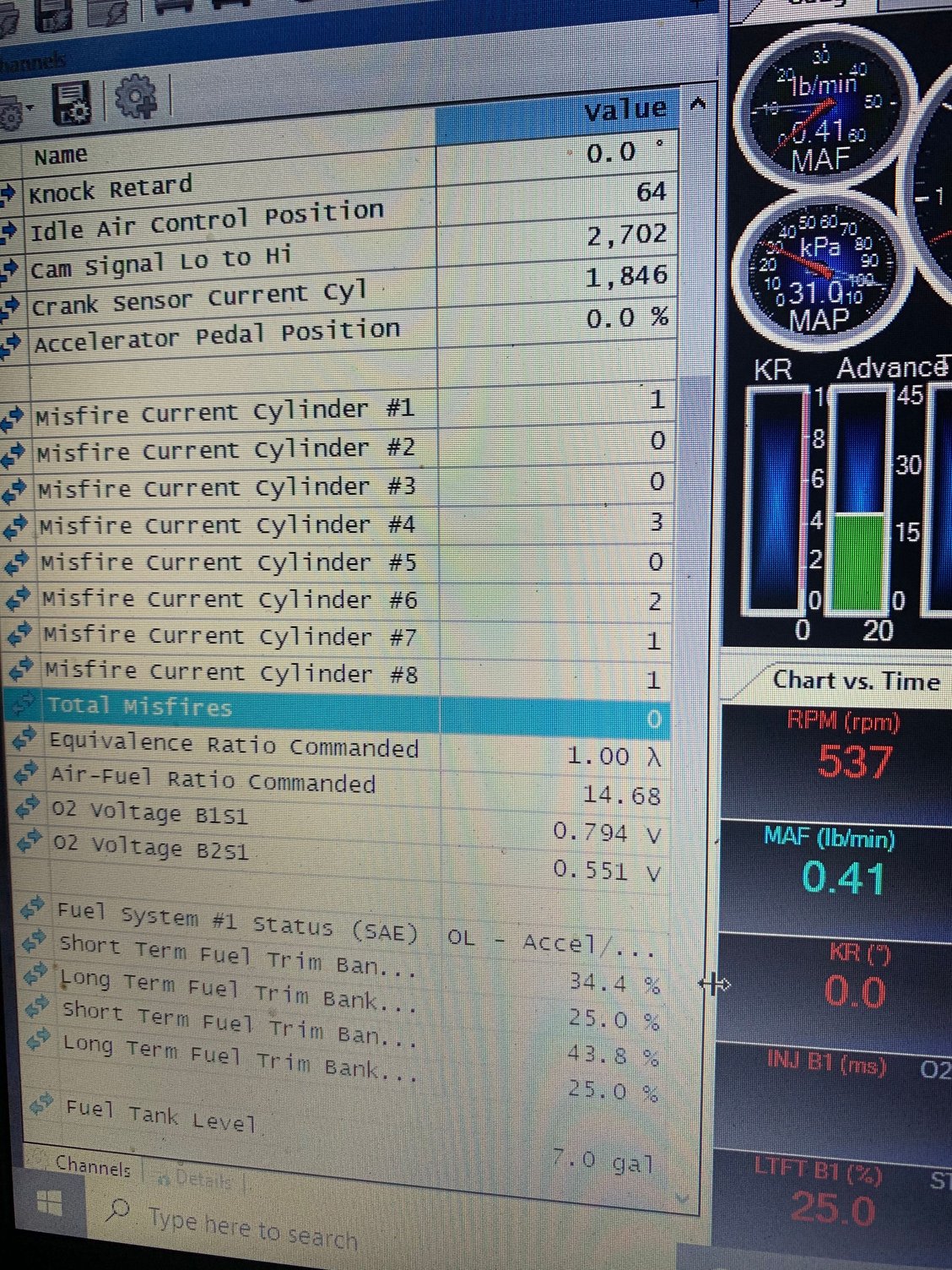

I put the old pcm back in and got it do run better than with the new pcm. I changed the pcv valve to a new one hoping that would help.
here is some screenshots and videos from hp tuners scanner.
The weird thing here is that these code have all been deleted from the ecm with hp tuners. However they keep coming back.

If you have misfire codes, it's not burning the fuel, and the O2 is seeing oxygen, and saying it's lean. Make sure you have good ignition on all cylinders first before chasing your tail on "lean" fueling issues.
