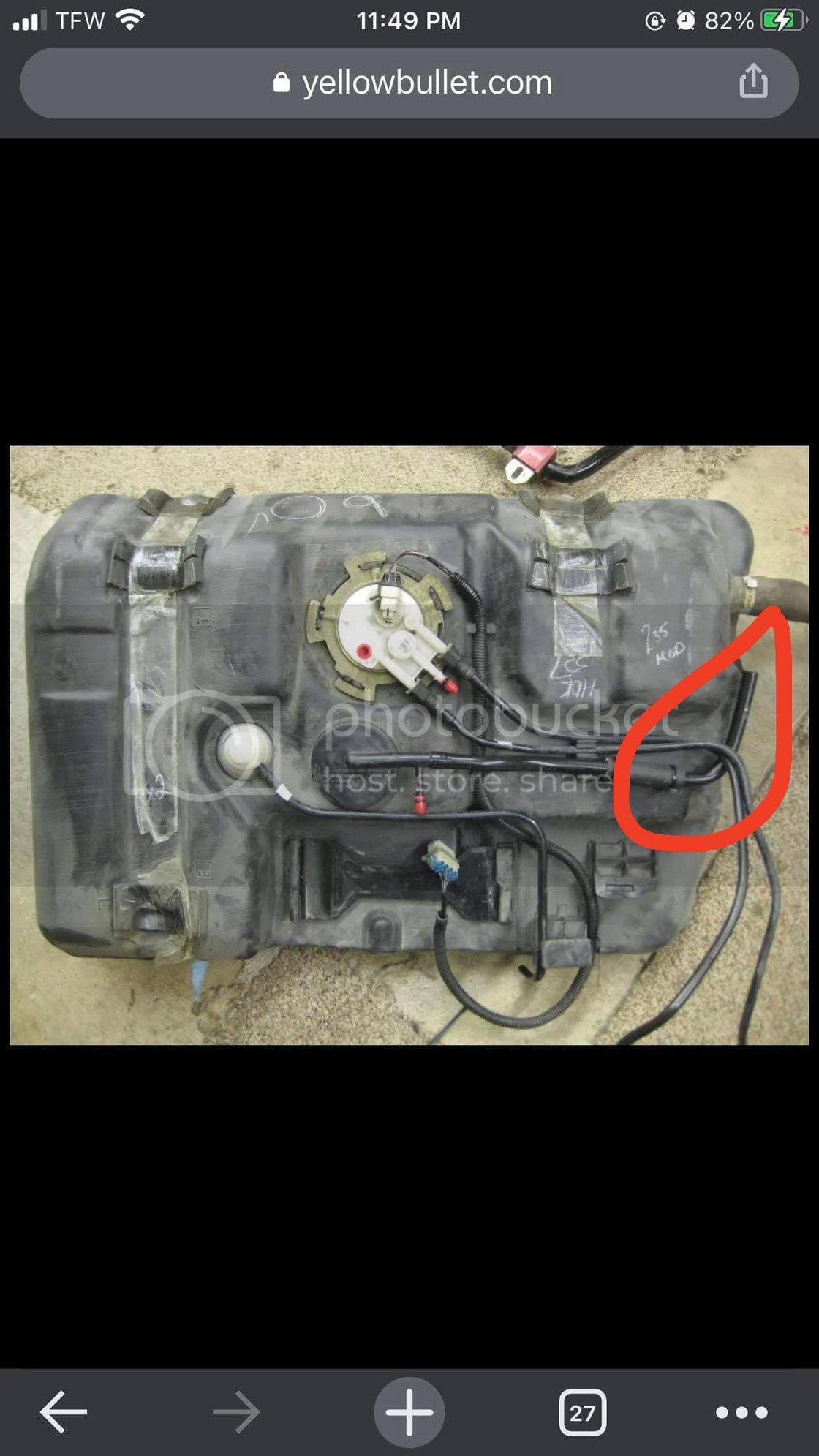

Basically, disconnect everything involving evap. Plug off any lines or outlets that may lead to fresh air getting in intake. Then disconnect the evap line going to the tank and vent those to the atmosphere. Preferrably above the tank level. Best spot is run it along side the filler hose

so just put a filter here ?

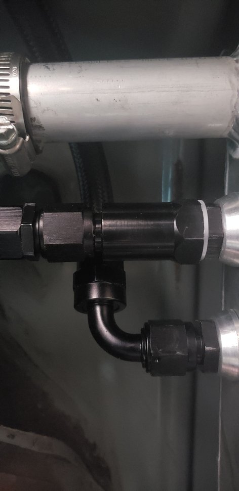

On my 99 build I have an aftermarket tank from Nasty Performance which has a 12AN for fuel feed with two 8AN bungs, one for the return and the other for a breather line. Since there was no roll-over valve installed in the tank I installed one onto the tank and will be directing the vent line down lower than the tank so that in the event of a rollover the fuel will not leave the tank.
