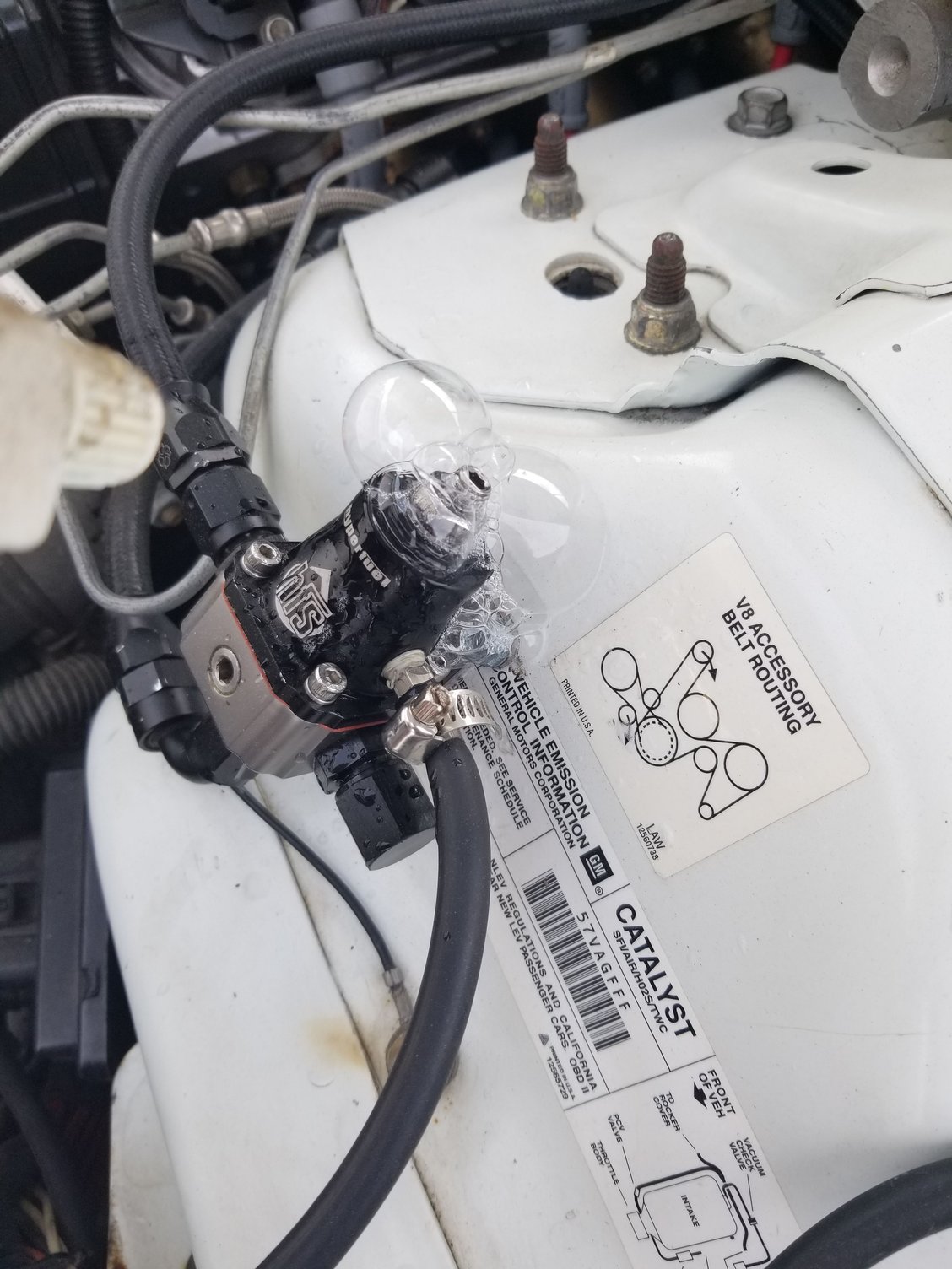

Putting 20psi of compressed air to the regulator, I Found this today. After I wrapped the screw with teflon tap, I took it for a 4th gear wot pull, 5900 rpm seeing 12.9psi of boost, fuel pressure was at 60.34psi.
Compared to the other day, 4th wot pull, 5900 rpm boost was 13.1 and fuel pressure was 52.86psi.

That hose clamp is way too big for that vac line. The clamp, when screwed down that far, will distort and not apply even pressure all around the hose. Maybe try the soapy water there, too.
Agreed. Im doing that next.
The vacuum line fits perfectly on the intake manifold port but not the hose fitting supplied with the regulator. That fitting that came with the regulator is very thin.

ah firewall was blocking the pic. It may be worth trying a different regulator given that you tried different pumps.
