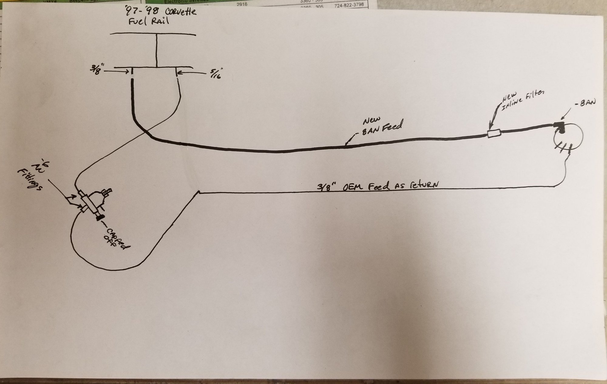

Here is a sketch of my fuel setup.

People have made much higher on a stock rail, I would venture to say even a stock fuel system except pump, injectors, and wiring. Are you saying the regulator is PRE-rail? I'm not a big fan of that.
After the rail. See sketch above this post.

ah firewall was blocking the pic. It may be worth trying a different regulator given that you tried different pumps.
Thanks. I'm going to try new fuel rails.

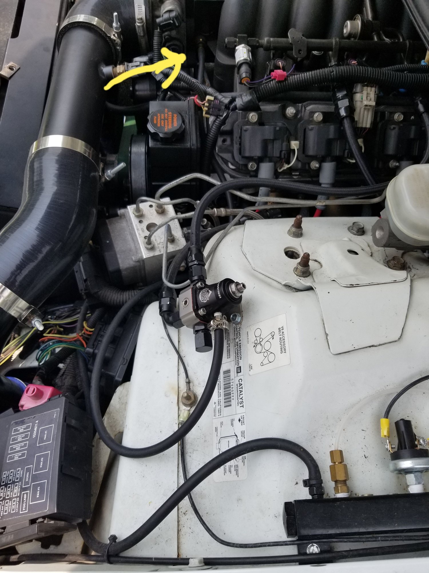

Originally Posted by gametech
Any chance that your boost reference line to the regulator could be getting pinched when the engine torques on it's mounts?
no chance of that. As you can see here. I've had it on and off a bunch of times through out this trouble shooting process and never saw anything wrong with it.

ive never used a 98 vette fuel rail, but isnt that a regulator built into it in your last picture?
Typically it is but I removed it since I'm using a external regulator. There is nothing inside there now.

Move the psi sensor to before the rail position and another gauge into the side of the regulator.
Do they match?
And, lose that shitty scotchloc wire thing! All that does is cut wire strands.
Are you SURE that sensor is accurate? I've seen many that are not linear.
What's with that screw hose clamp on the reference line?
