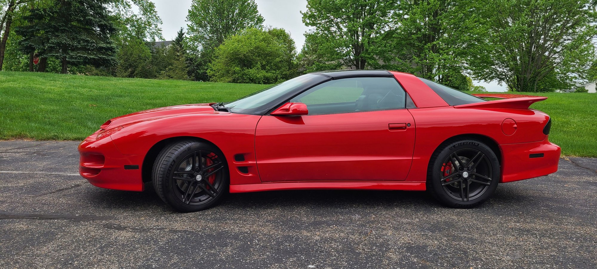

Hello everyone, I have a 1999 Trans Am with 95K miles that I bought out of an estate so I was fairly certain that some 18 year old and whipped the car to within an inch of its life. It had sat for about 3 years. The older gentleman who owned it had died several years before the sale and needed all kinds of deferred maintenance done to it.
So, I have replaced the entire suspension with a full UMI adj. setup except the engine cradle. Rebuilt rearend with all the goodies (new posi, Moser axles), all new upgraded brakes (Brembo 4-piston up front), all new fuel and brake lines, new Transzilla 6-speed with the Tick LS7 clutch package, and it came with a Borla cat-back exhaust system on it. Also upgraded the side marker and all front lights to LED's.
Now that all the other "stuff" is done on the car, I want to start turning my attention to the engine. It was tuned by someone and had numbers of 349hp/357tq on a Mustang dyno and 87 octane pump gas.
I want to start doing some things to the engine. I was thinking of starting with an intake manifold and came across a ported, by Vengence Racing, MSD unit with 42lb injectors and rails. Then perhaps get headers on it.
