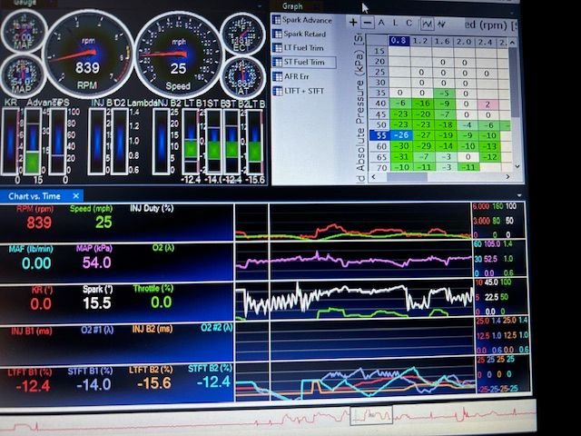

I figured this was worth a picture. Here's a representation on what's going on. This was a very short drive in the neighborhood.
I've got a set of injectors on the way. Fuel pressures are 56. Nothing changed there.
