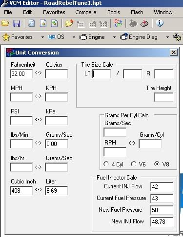

Where's that calculator from? the one in HP Tuner is much simpler as per below.
Injector Scaling and Sizing Write-Up
Robert
Robert,
The program above isn't just a injector scaling utility like the one in HP Tuners. Fuel Injector Calculator from Performance Trends is designed to size injectors for an engine based on inputs. The utility in HP Tuners does not offer anywhere near the capabilities of FIC.

Originally Posted by 405HP_Z06
Robert,
So, it's some sort of hand held? or a program we can add to our lap top? By the way i understand the difference, but my point was to find out which tuner program had such a feature. I use the math and spread sheets in my web for the same thing, however, I was hoping one of the tuner programs included such features as clearly my HPT does not.
Robert
Robert
IMHO, the capabilities of Performance Trends FIC really go beyond the intended purpose of any tuning software. The utility in HP Tuners offers a quick and easy way to determine the output of an injector based on a change in fuel pressure, but since it doesn't provide the way by which to generate IFR's it's pretty useless. I don't know why, but it would make sense to me to include a utility in the tuning program that generates the IFR table based on inputs like the spreadsheet everyone uses.
