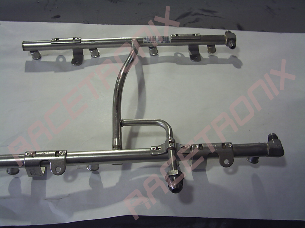

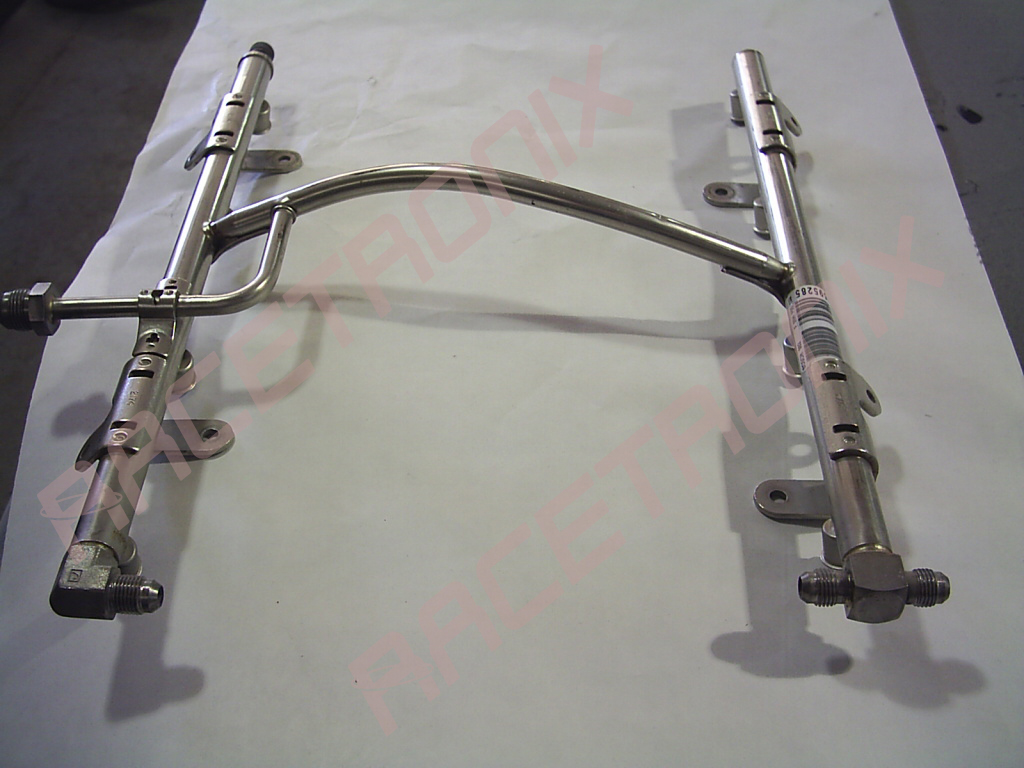

Old Sep 25, 2008 | 05:38 AM
Racetronix's Avatar
LS1TECH Sponsor
Active Streak: 30 Days
Active Streak: 60 Days
Joined: Mar 2002
Posts: 2,032
Likes: 26
From: A Racetronix dealer near you...
These images should help. All this can be done easily with a cutoff tool, file, sandpaper, MAP gas torch, silver solder and some flux. This setup can support 1000HP+ with a proper pump system.
The D/S rail fitting has a -8 Teflon line running to the P/S 'T' fitting. The other side of the 'T' fitting runs to a regulator. Make sure you remove the pulse dampening strips inside the rails once the end caps are cut off. This particular rail setup is from a 950RWHP TT C5 Z06 using a Racetronix / Lonnies DP fuel system.
