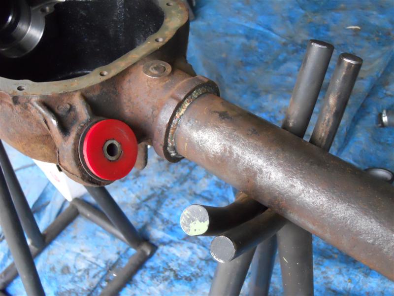

or you can wait and have this happen to your 10 bolt, as of which JUST happened to me :\
Attached Thumbnails Rebuilding the 10 bolt....-154501_1590650019017_1618880993_1361213_191206_n.jpg

I'm confused , I dont really understand what have my axel tubes welded on... NUBE!!!
So, Weld axel tubes on, get gears, and installation kit, and i'll be fine?
Old Nov 25, 2010 | 12:44 PM
Joshiedoom's Avatar
Joined: Dec 2007
Posts: 1,712
From: Between Bowling Green/Owensboro
The tubes that are in the "pumpkin" are pressed in. Weld that whole assembly together.
