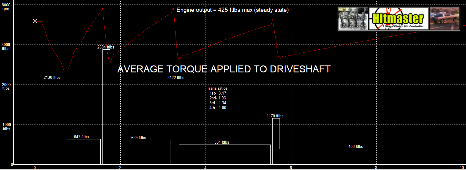

Clutch induced impact is what kills stick shift rears, not 1000hp. Here's a graph showing how hard these clutch induced impacts hit this 8.8 rearend during a dragstrip pass, all from a little sealed 425ftlb crate engine...
Note that when the clutch is pulling the engine down fast, you see huge torque spikes.
Also note that when the engine is gaining rpm in 1st gear, engine torque applied to the transmission's input shaft is nowhere near the 425ftlbs this engine is capable of...
The basic takeaway is that the slower a clutch pulls the engine down, the more power the rear can handle.
