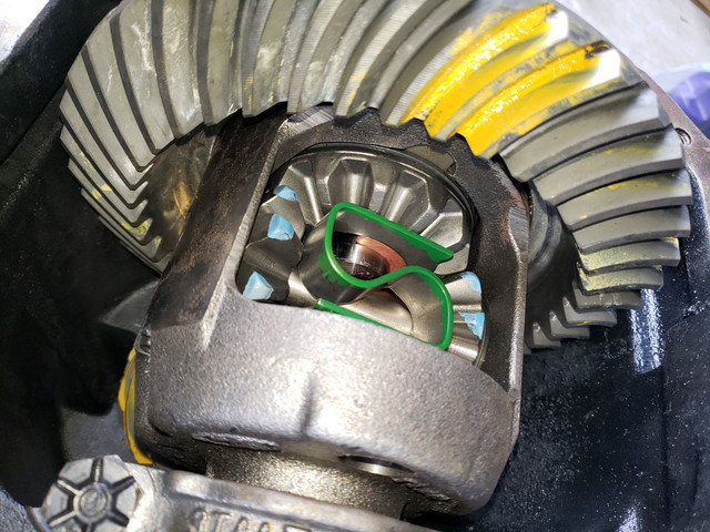

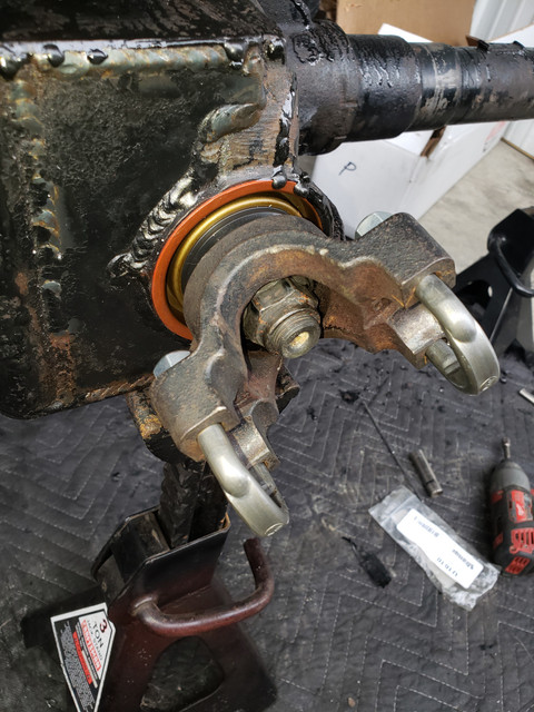

some pics of the welds
x6 50i 0 60
2012 wrx sti 0 60

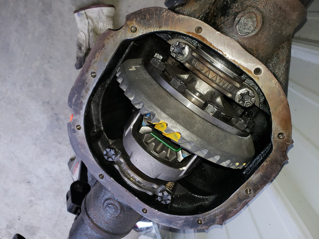

and the welded mini spool..which for obvious reasons will be getting changed out
ordered a bunch of parts and will be updating soon!

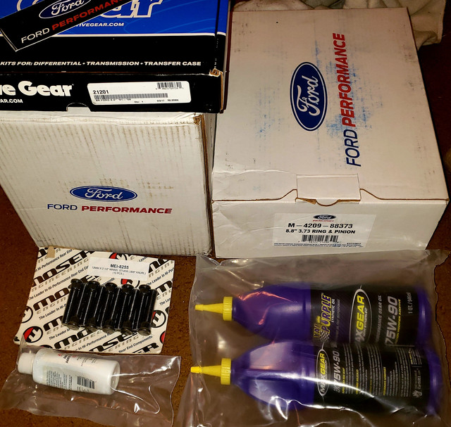

Parts arrived

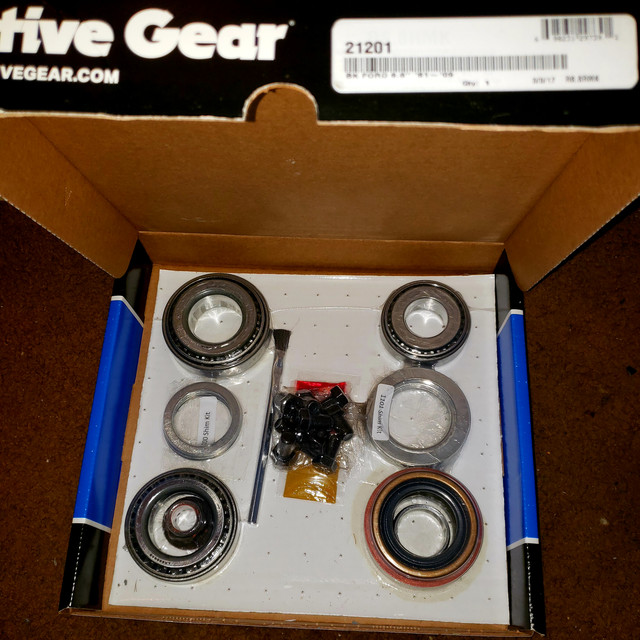

Picked up my rearend from Morgan Performance in Greensburg,IN
new bearings and seals
unfortunately the Moser axles had to be cut to remove the c clips bc of the welded mini spool
I guess my next purchase will be for some Dutchman axles to get this together and put in the car

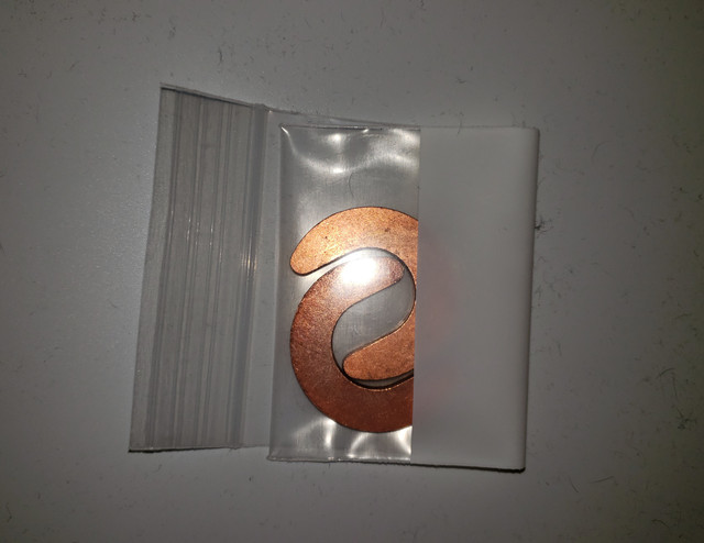

Few parts came in : OEM replacement c clips and the Spohn sway bar installation kit to clear the GT500 diff cover with OEM bar

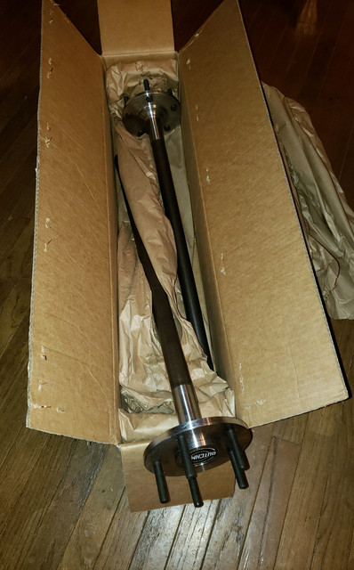

Axles came in today , I sent my Moser studs to TJ at Dutchman to go ahead and press them in for me .

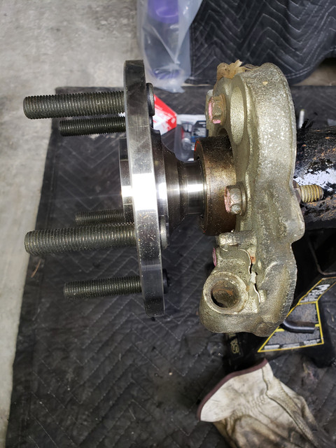

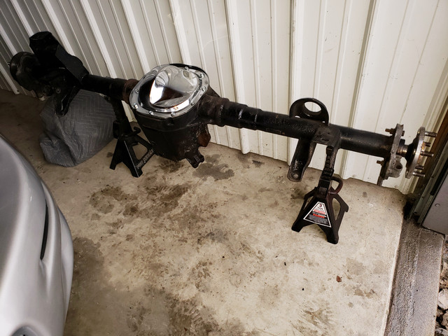

Installed axles with new c clips
baby girl generator
Filled her up
I most people just use rtv on 8.8s , I did a layer of rtv.gasket.rtv ... I cant stand leaks
all done ,should have installed in the next week or two

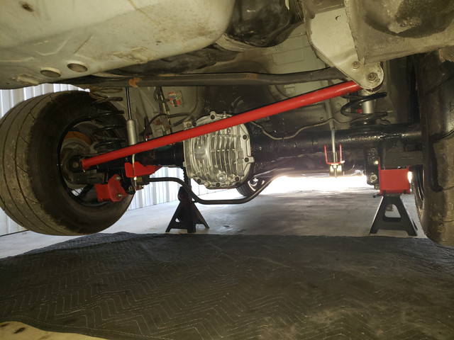

8.8 and SJM abs delete is all done and installed.
I have put about 50 miles on the car and everything feels so much smoother than the 10 bolt ,along with no gear wine.

Also forgot to post a pic of the sway bar brackets installed .
