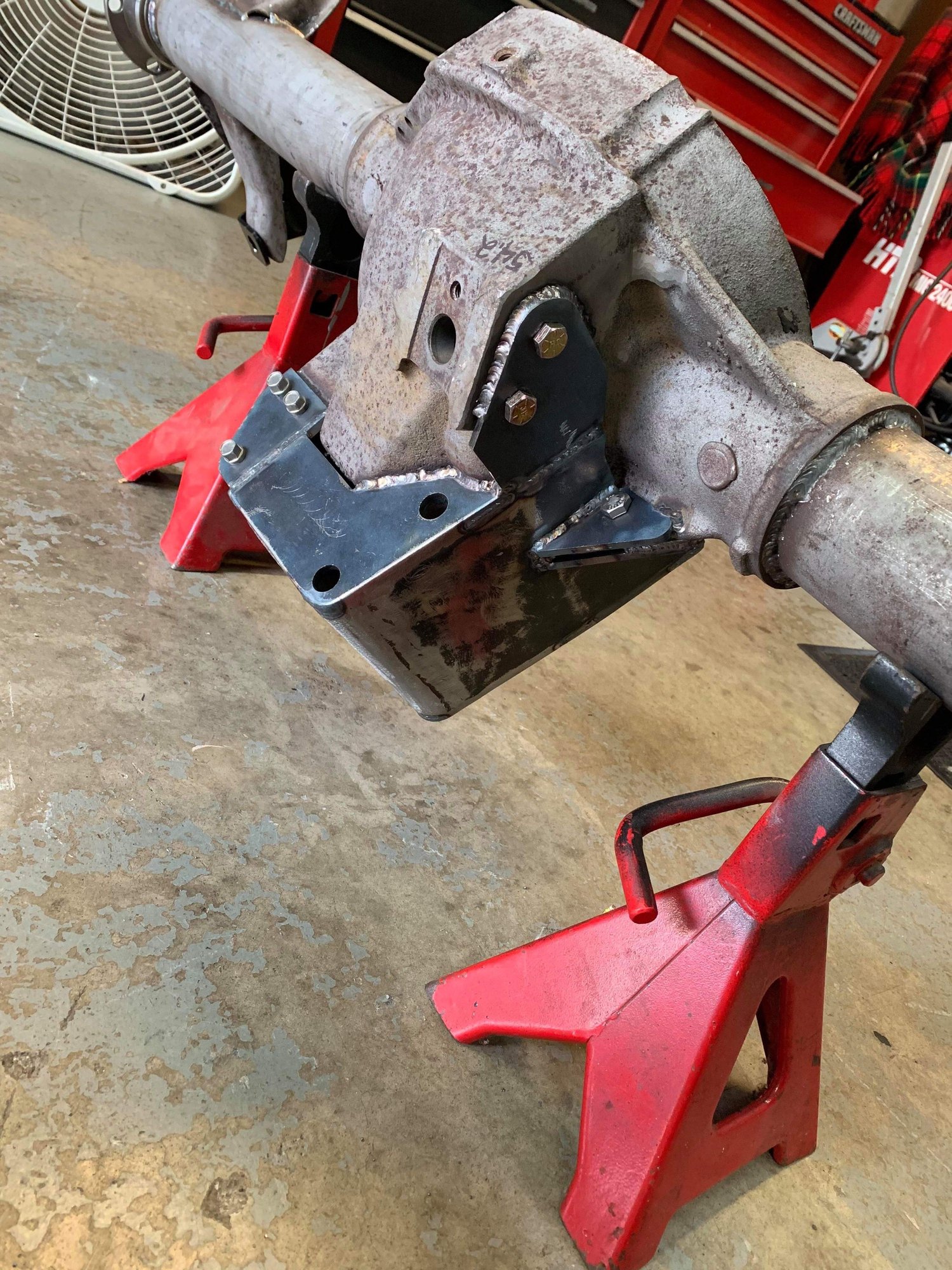

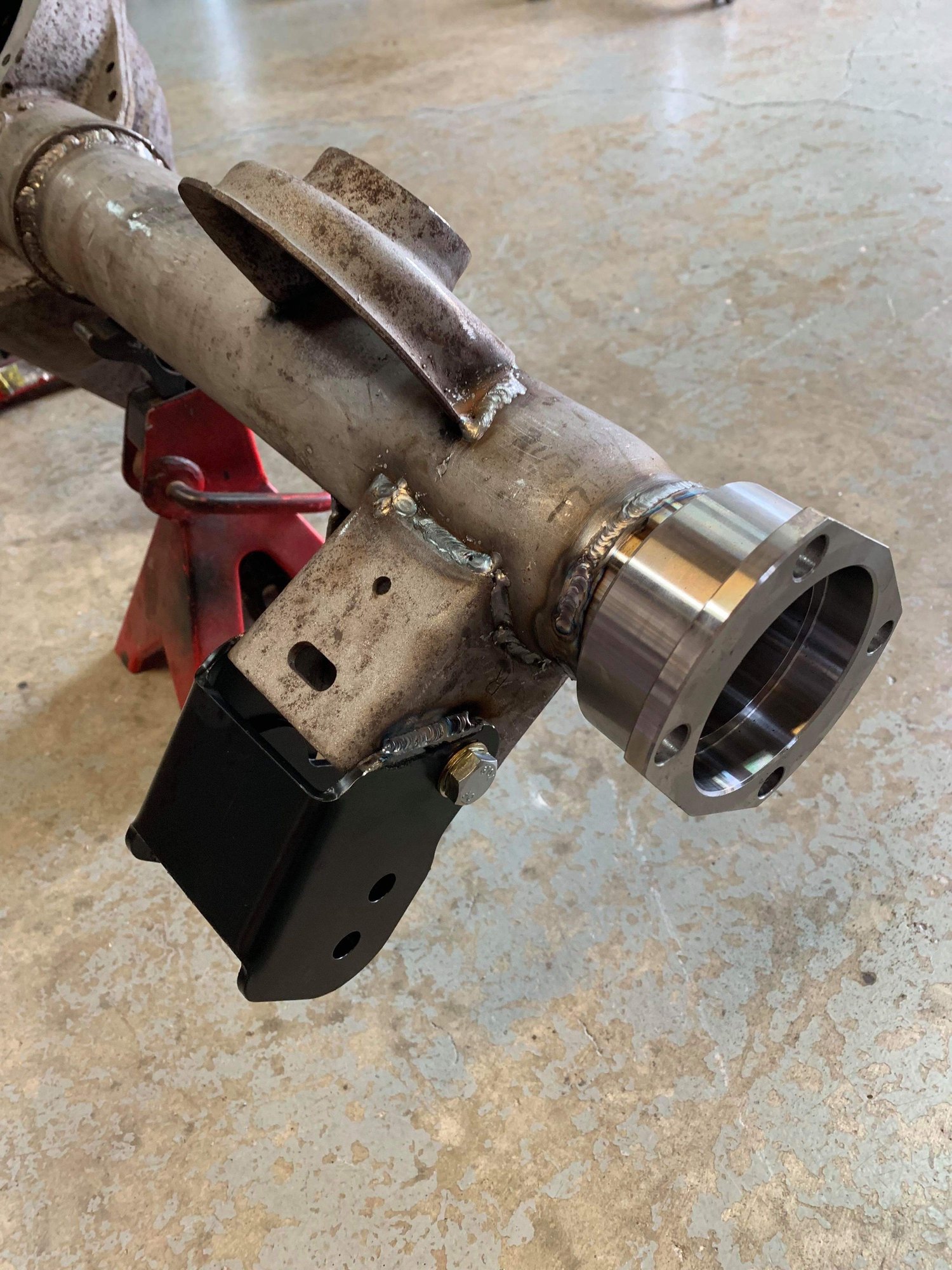

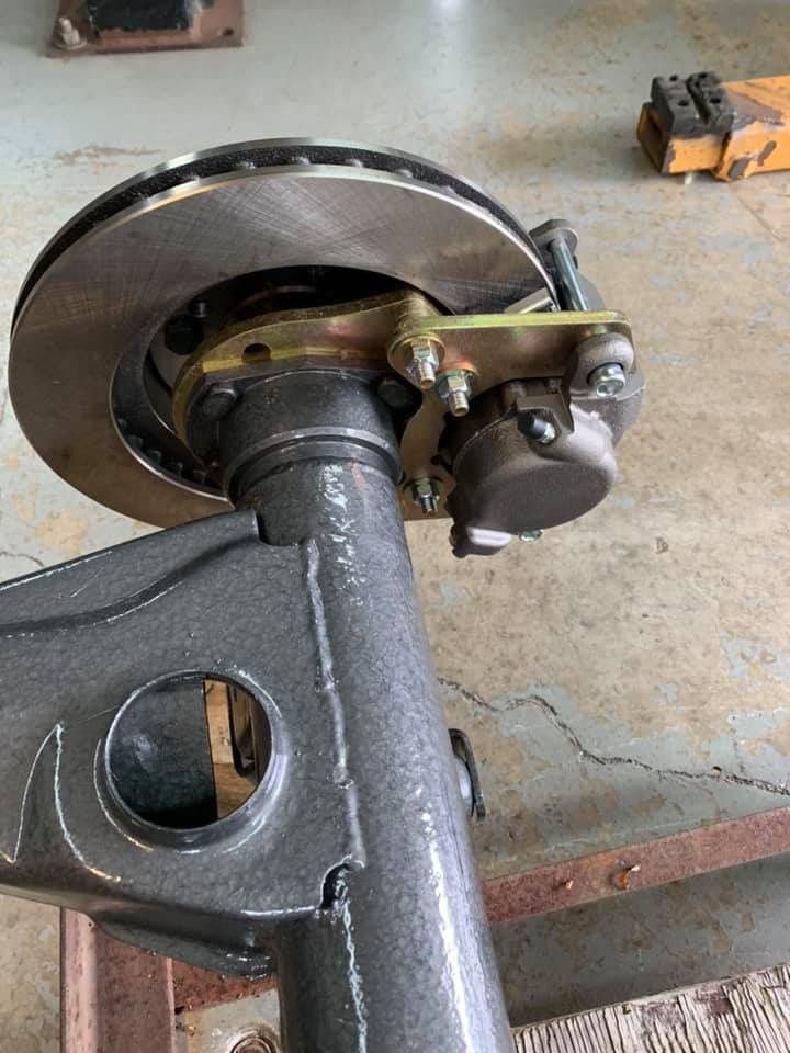

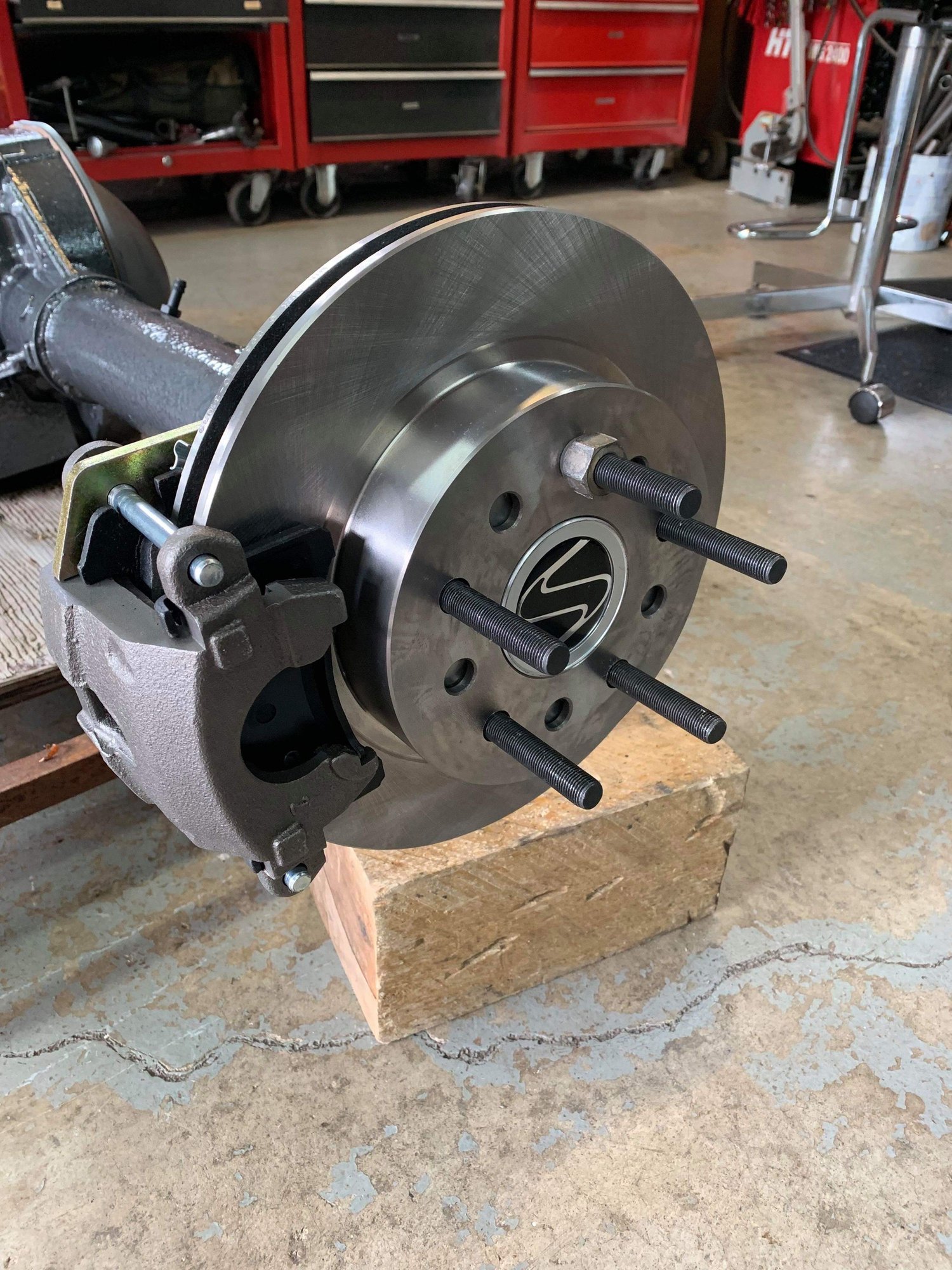

A local guy is building my 8.8 rear. Used a 99 explorer housing, swapped all the brackets and mounts from my stock 10 bolt to it, as well as narrowed it 2.5” per side. New 35 spline axles and lightweight spool from strange, billet ends, hiltsy mount, PEM rear brakes...and I’m still about half the cost of what a 9” with aftermarket brakes would run me. I’m stoked.

Looks good . What wheels / back spacing are you going with ?

Is the housing centered? On mine, I added 3" to the short side and used 2 long 31 spline explorer axles. I was going to narrow and use 2 short axles but then the lca brackets would have been into the end brackets.
Yes it’s centered. I’m using custom length strange axles.

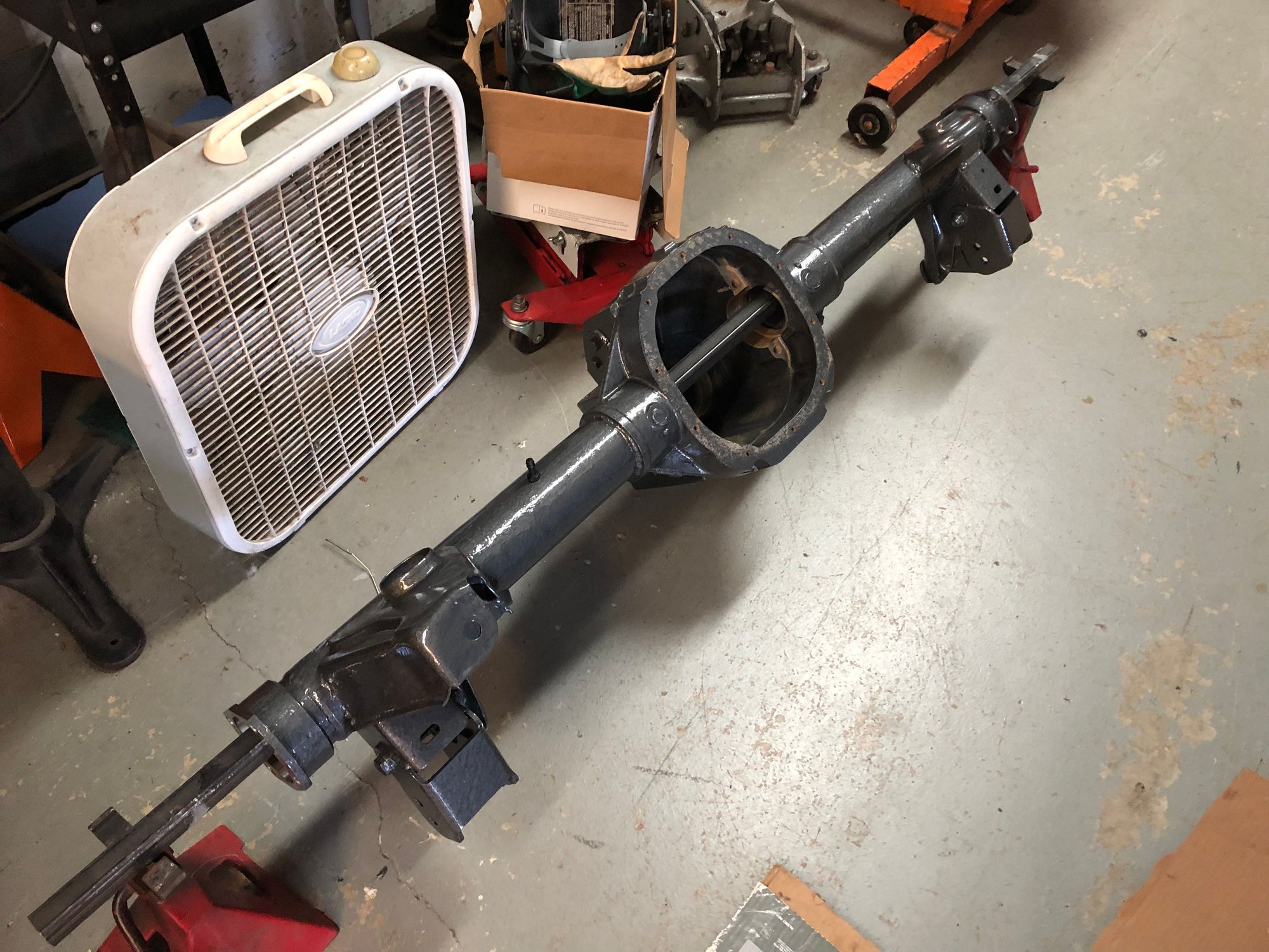

All done.

Looks good but you need more pics!

What housing ends did you use?
You say 2.5" narrow on both sides, was that 2.5" narrower than the stock 10 bolt?
Im planning on a similar build but am torn between using my 10 bolt tubes and running the limited slip or going spool and welding on different housing ends, i want to keep my factory brakes to keep costs down.
It's about 2.75'' narrowed per side from factory 4th gen 10 bolt width...9'' housing ends were welded on from Strange. PEM Brakes were used, their cheap "drag" kit. Fits drag wheels.
