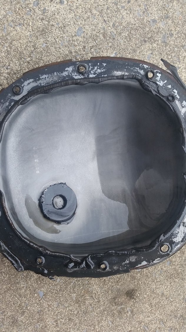

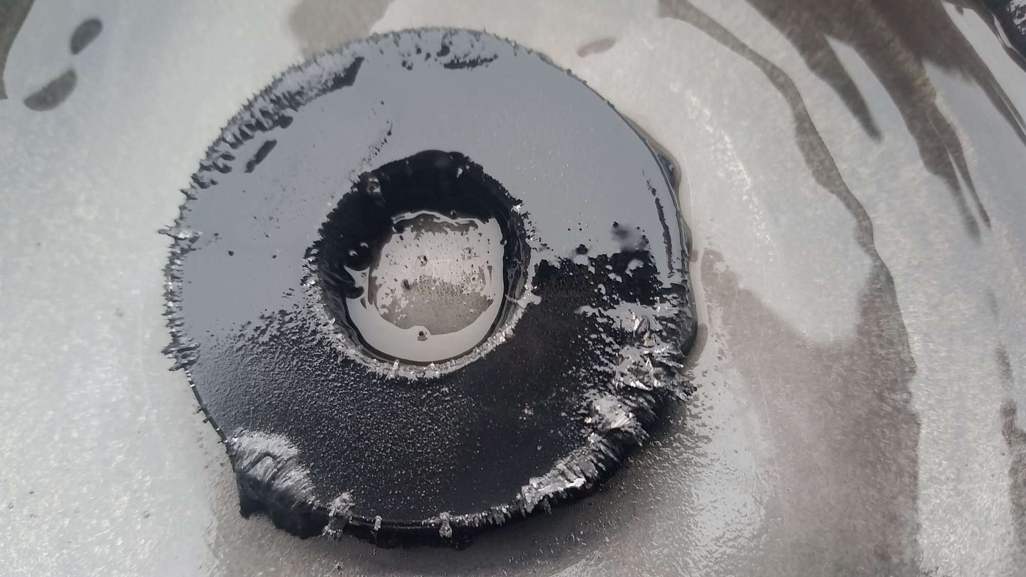

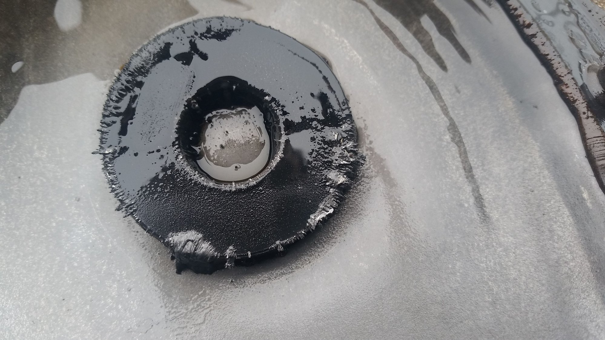

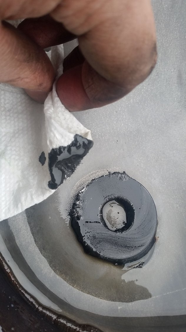

Update, dropped the pan. I don't think the rears gone but rather an axle bearing? There's a tiny bit of play on both sides of the wheel rocking it 6 and 12 but very tiny. Heres a few pics of the magnet

Shot of the pan

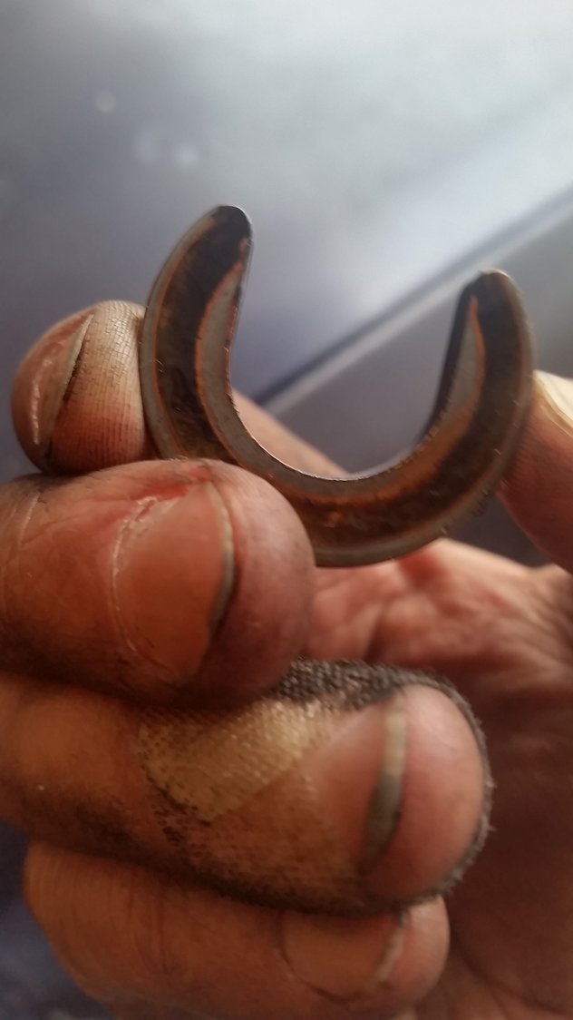

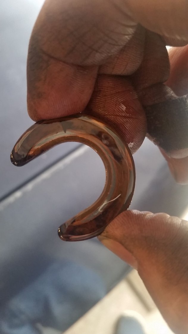

Is the c-clip supposed to look like this coloring?

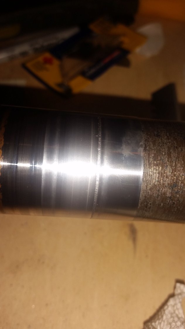

From: lancaster, pa
Driver side axle. Running my finger nail across that grove back and forth it catches.

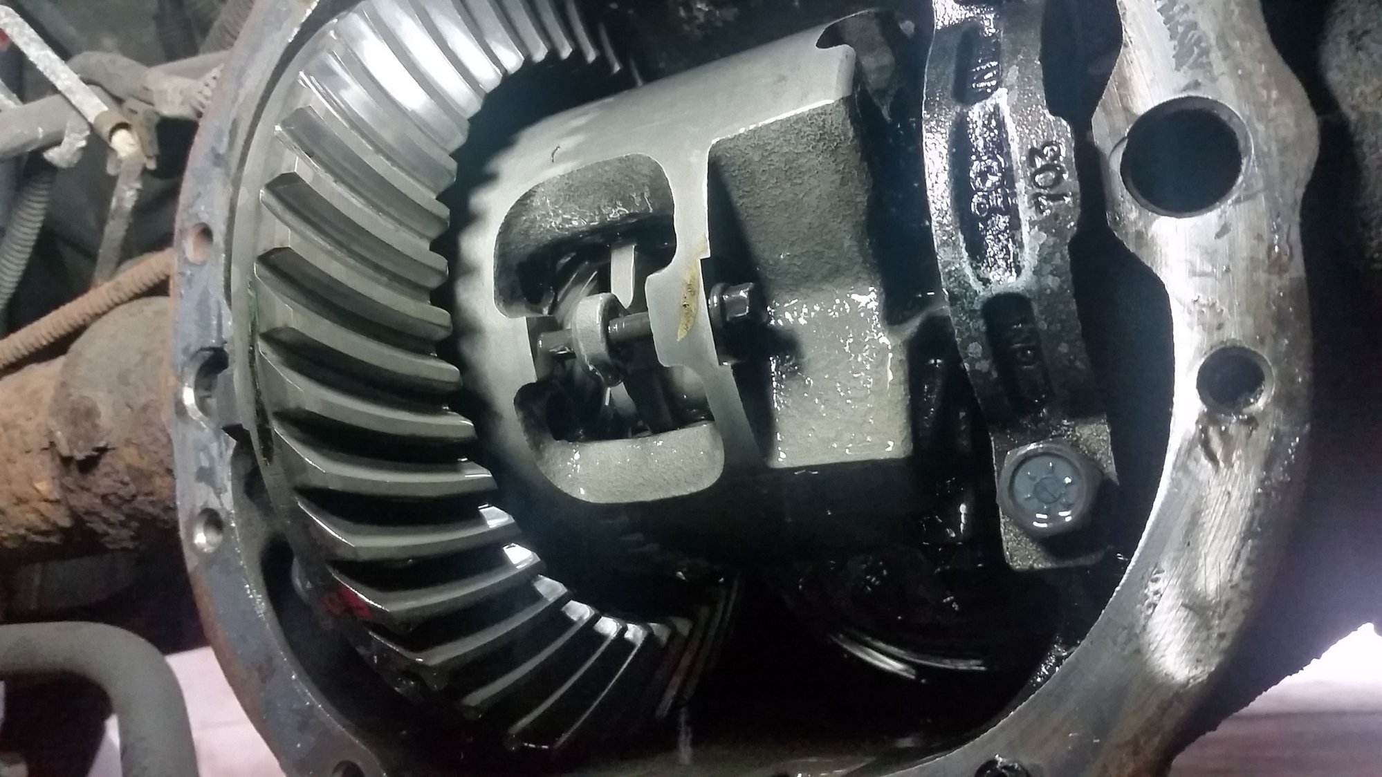

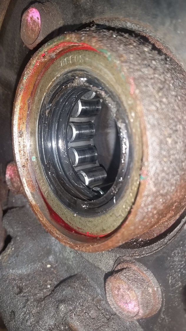

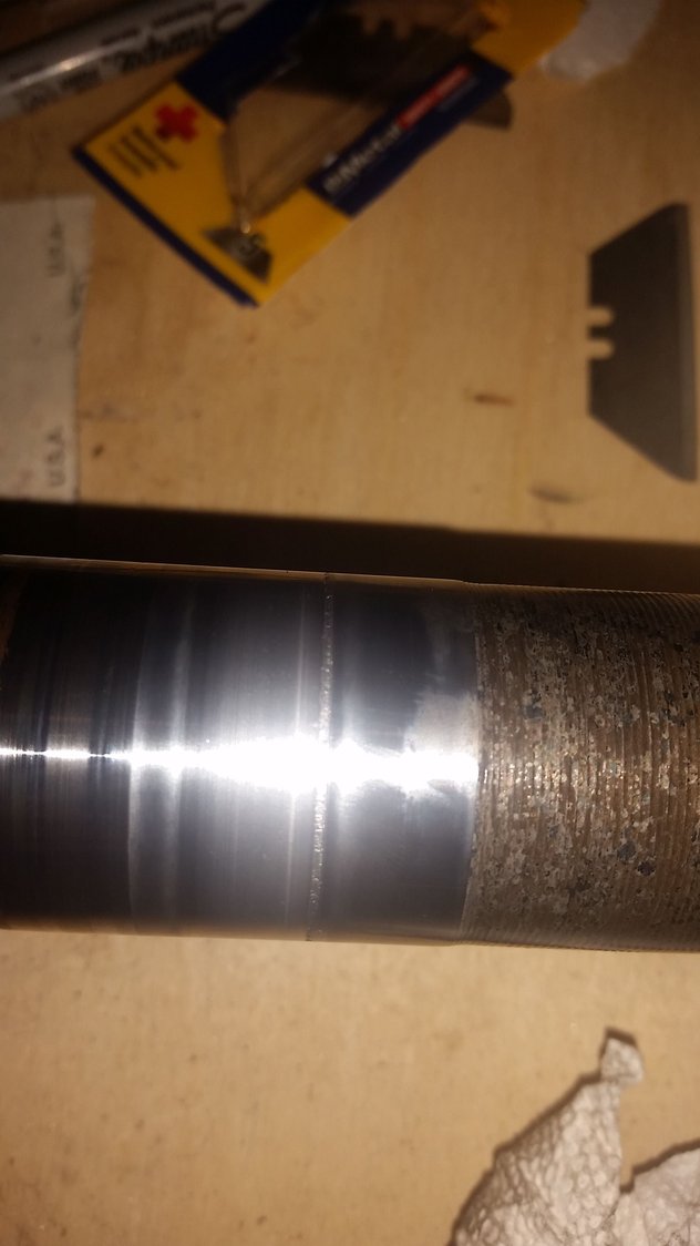

I work on our little 10 bolts. The magnet is very clean, the cover looks good, the ring gear has what appears to be a good wear pattern, the axle bearing surface is not good but I've seen MUCH worse and driven in that much worse condition. More importantly,how are the needle bearings in the cage for that axle. A deteriorated bearing will cause that. I've seen axles with that wear re-installed with new bearings and last a long time. DO NOT USE 'AXLE SAVER' bearing assemblies.
Your 'posi' is a Torsen and sometimes they get noisy.

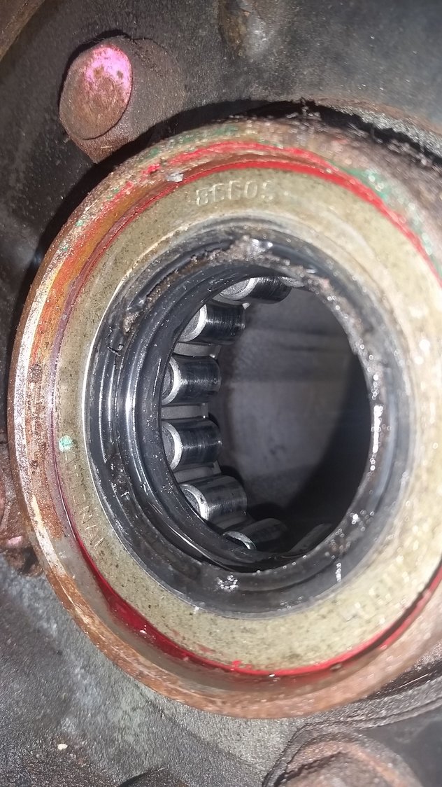

The bearing spun freely and i didnt notice any seized ones spinning it around which is odd. I rented an axle puller and maybe cause i didnt remove the seal first, but the bearing exploded when i was trying to pop it out. Managed to remove it though.
edit: pics before removing the bearing and seal

Being that your picture in post #2 of the posi/ring gear doesn't show a carrier mounted reluctor ring (for 3 channel ABS), you would have a 4 channel system with reluctor rings pressed on the axles behind the wheel flange. 4 channel replacement axles do not come with those rings.

correct its a torsen diff with the 4 channel system. I did use a 3 channel axle a while back that worked even though it didn't have the reluctor wheel rings pressed on it. I only lost traction control/abs but that's nothing new to me. thanks for your response Firstyrls1z. so for the time being, im scouting for a used axle shaft on here and on social media as well as new seal and bearing.
