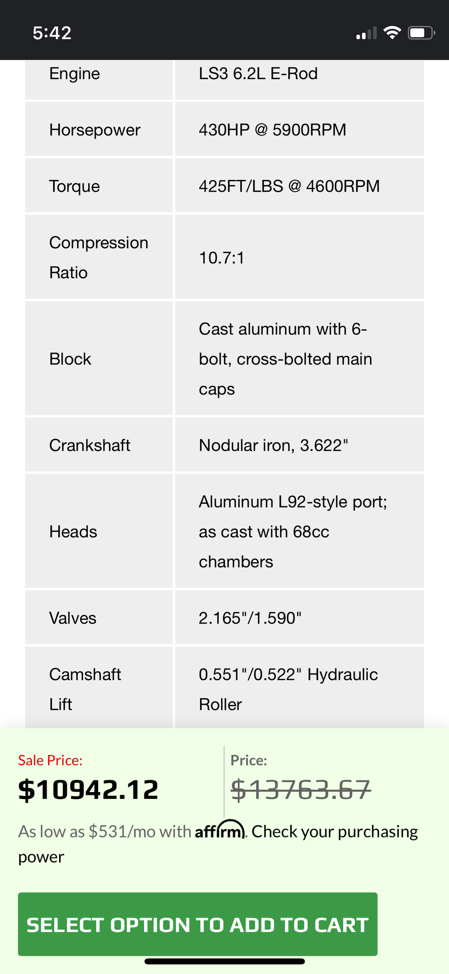

specs are below. Thanks - I’ll make sure to get the 1350 U Joints while I’m at it.

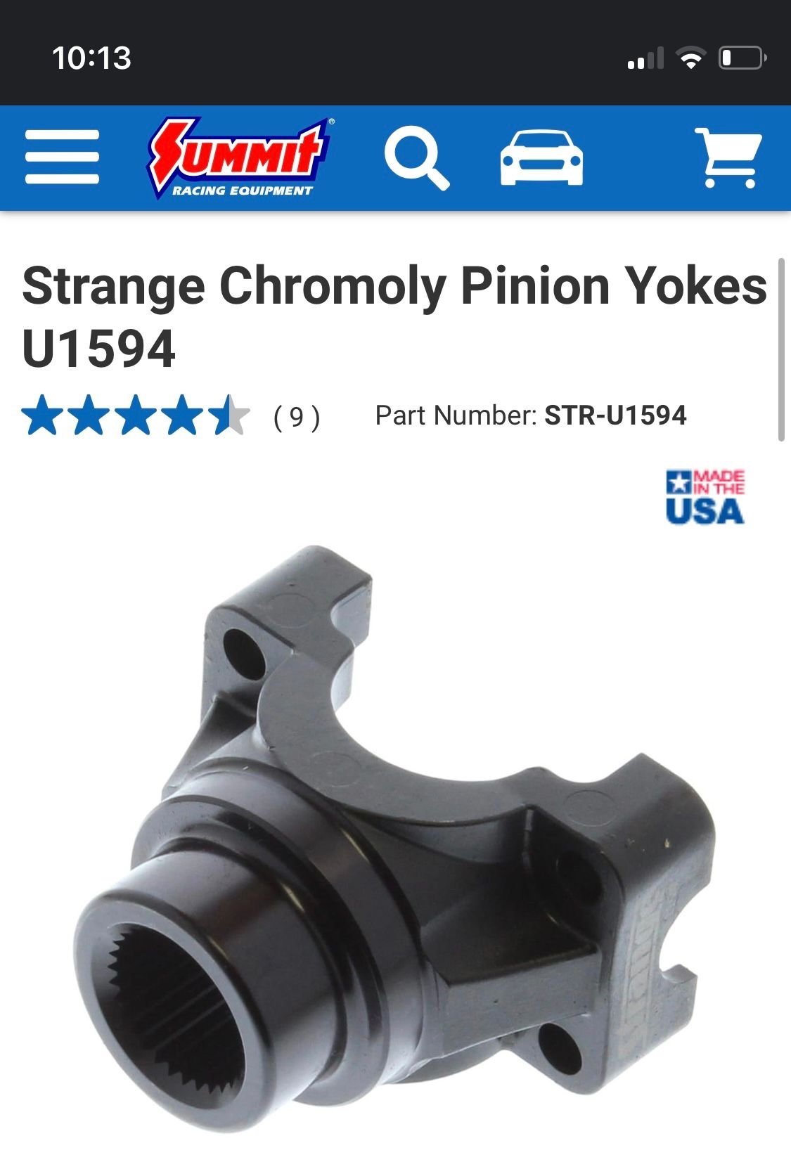

Should I replace the pinion yoke while I’m at it? It looks like the 1350 yoke will fit. I can avoid needing a conversion joint correct if I replace the pinion yoke?

I do both on LS swaps. I can't speak to clearance issue on your fbody but my 80 fbody has zero clearance problems. The 80 is lowered about 1.5 inches.
I don't do the chrome moly just forged.
My current 80 Camaro project with a LS3/4L60E combo I'm running 3.73's. 275/40 18" rear tires. Tachs about 1700-1800 at 60mph.
Don't know if this helps but I supply the trans yoke to the drive shaft shop. You can buy the pinion yoke from places like Summit.
I use a shop in Waite Park MN. I know they do mail order. Your above price seems high for a steel drive shaft.
