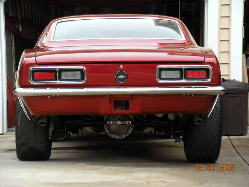

8.5" is nearly as strong as an 8.875" (12-bolt) and can be built to handle 4-digit HP. Excellent rear. I have one in my '71 and '74.
