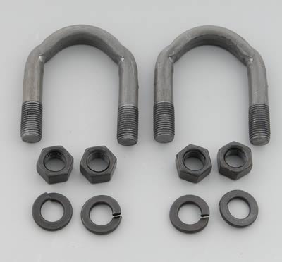

the u bolts that hold the driveshaft to the rear, i got mine from napa, im gonna be launching with n20 soon and was wondering if i should upgrade.
picture one is what i nave now.
picture two is what im thinking about buying

No, I wouldnt think you need to at all. Ive been 1.4 60's on the bottle with the first one's you posted. honestly, the first ones look stronger to me anyway

I've been 1.29 60' with Spicer 3-94-18X 1350 series u-bolts. Car ran 8.93 at 156mph, just wanted to throw that in.

that the same part number for a 9"

i would do the stronger ones just for a piece of mind if they arent outragious that is

the first ones probably are stronger...

A few more options that WILL NOT fail in your application...
http://www.markwilliams.com/drivesha...CategoryID=264
Some are a little pricey though.
