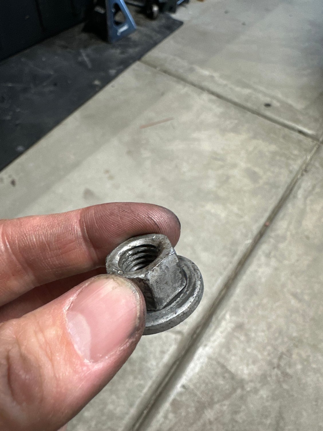

Found this broken bolt with a free spinning flange nut under my 01 Trans Am. Any idea what it could go to? I spent hours under my car searching and no luck. Didn’t see any issues with suspension components. Shocks, panhard bar, control arms etc.

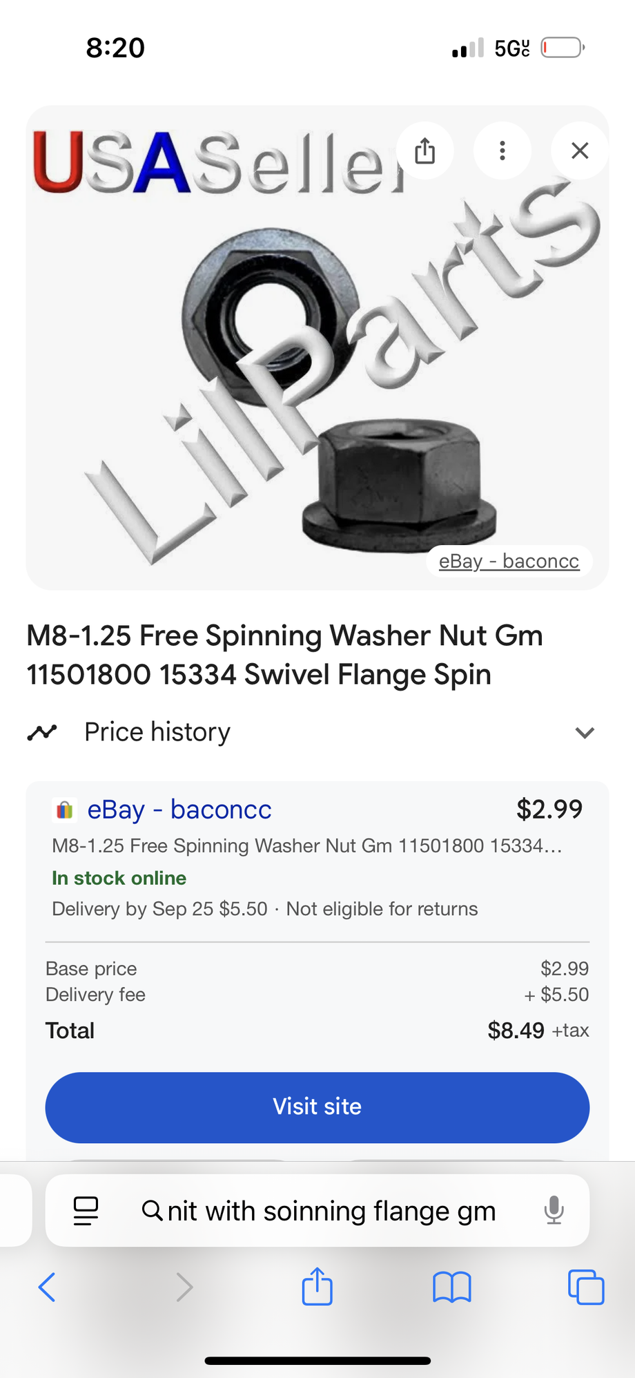

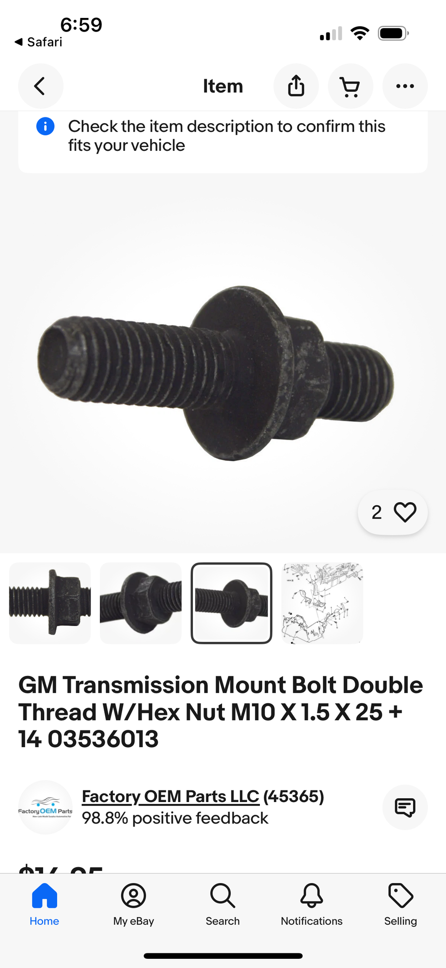

It’s a unique nut. 19mm hex. Anyone familiar with where GM used these on F Body’s? Found a similar example on eBay. See pics. The transmission was swapped by previous owner. Transmission related? Part of the bolt attached. Found in the garage like this where I park my car.  Midway underneath.  Transmission mount related?
It’s very unique and attached swivel washer on it.
Example of type of nut. Mine is 19mm hex
Another example
Another example

off top of my head id look at the tourq arm bolts/ mounts.

That's one of the Nuts that goes on one of the Bolts that secures the K-Member on the front Subframe. Gravity is keeping it there as well as the other 5 at the moment, 6 in total. What makes me wonder is how that snapped, that's a large Bolt..
Could be one that goes on the Lower Control Arm also, they are the same size if I remember right, it's been a while.
