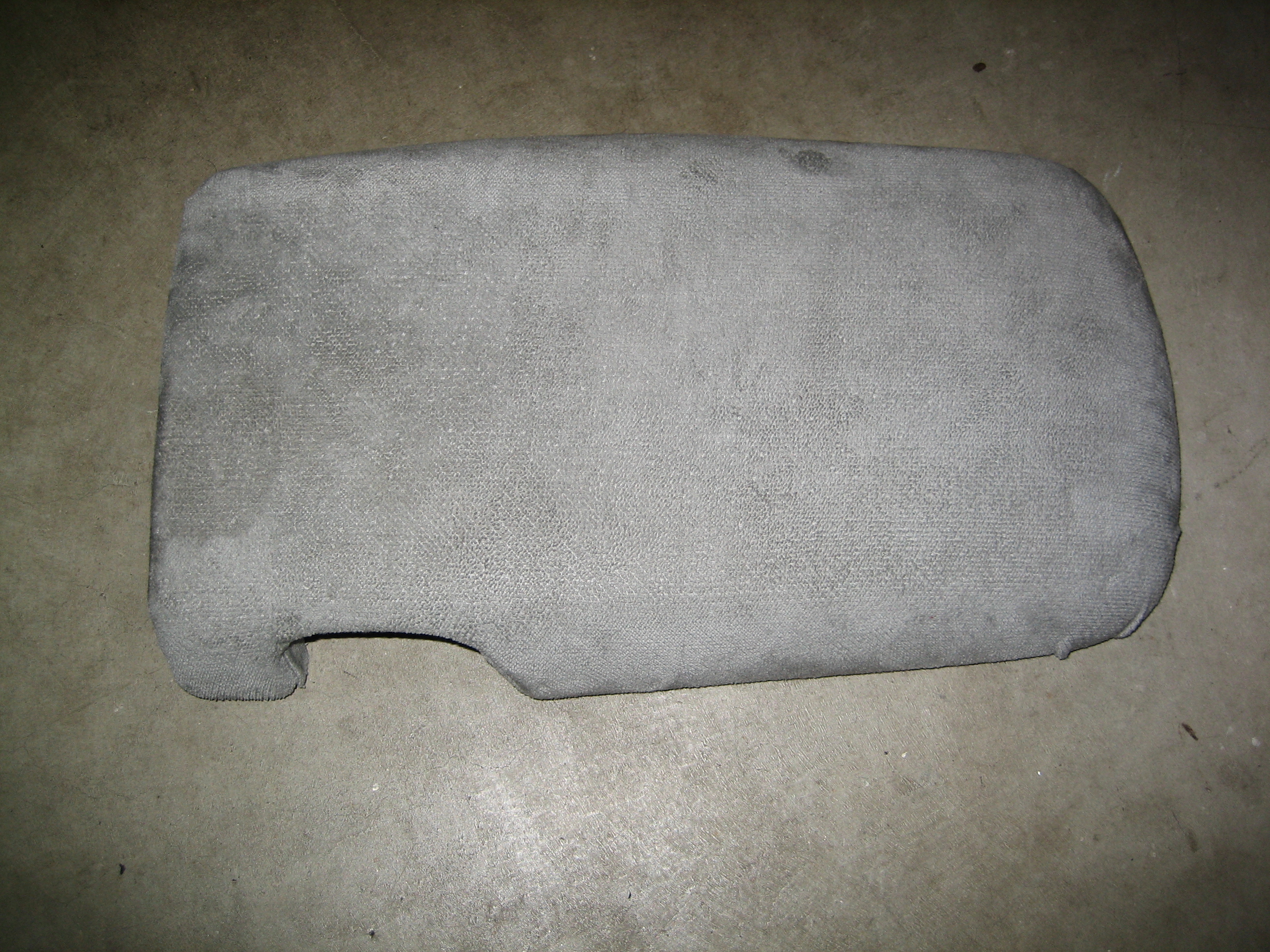

Ever since I got the car the center console compartment door has been funky, well a few days ago it was really excited when I sat in the car and wanted to ride shotgun...so the thing swung open and shot the top part into the passenger seat!
Needless to say, I need to do something about this because what remains is a thin plastic door that is stuck in the open position so everyone can see whats in my compartment. Should I just try to glue the pieces back together or find a replacement?
The part # is 10421355 and they want $140 for it!

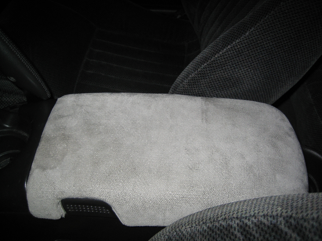

Here are the more in detail pics...

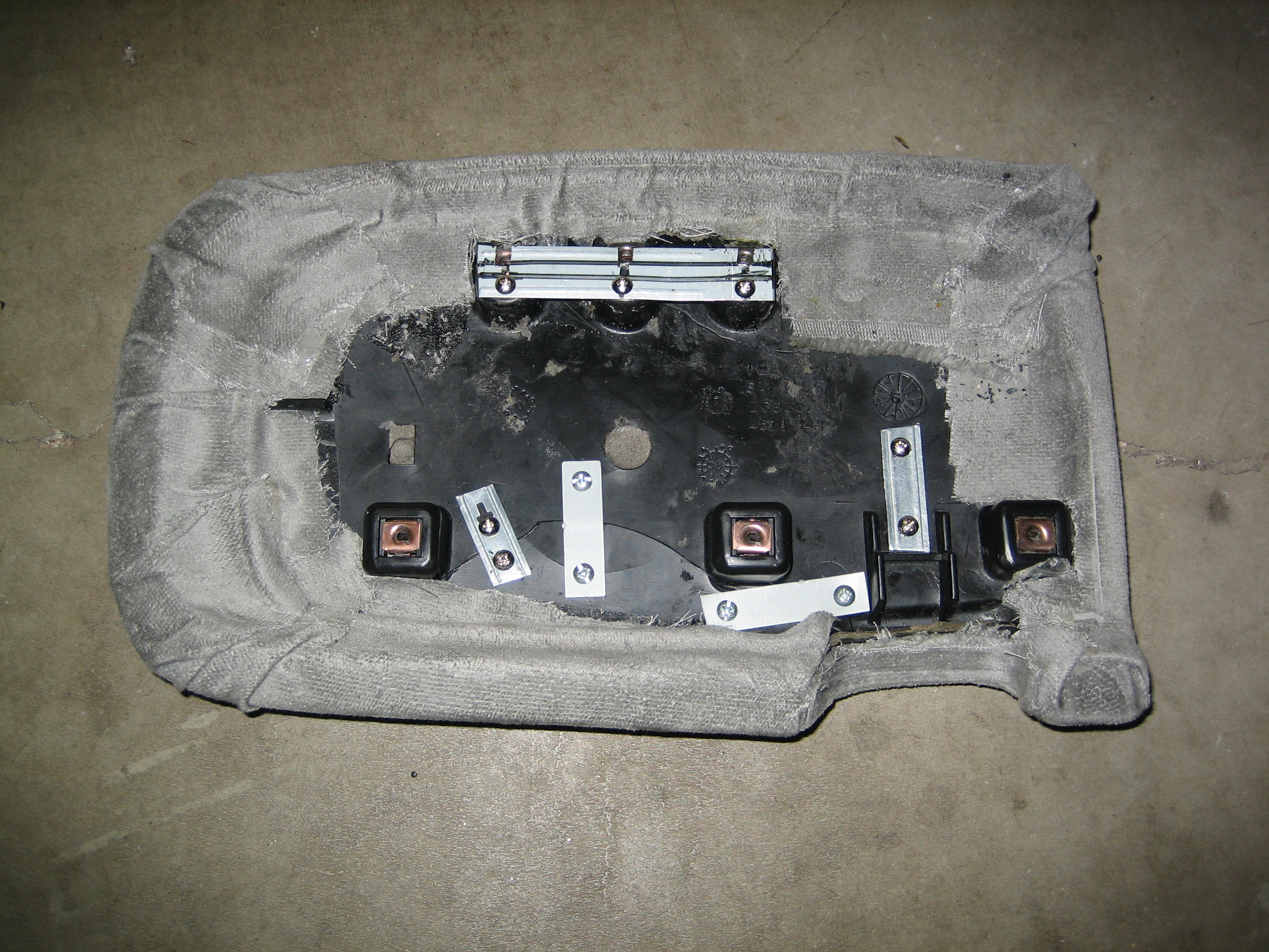

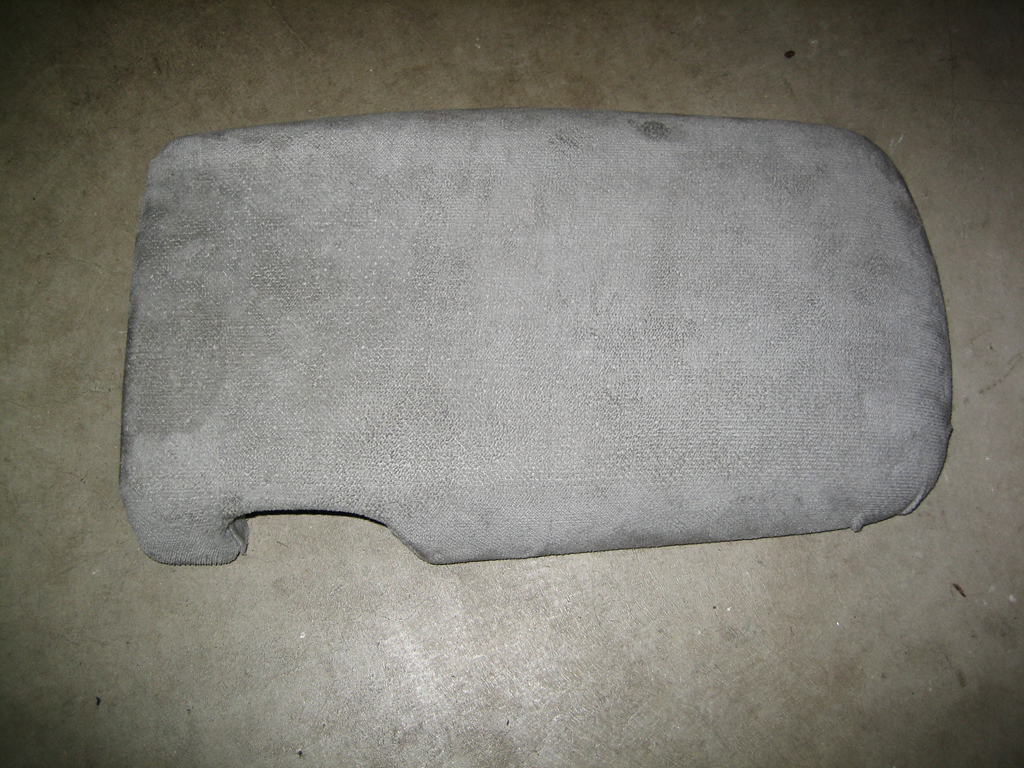

Old Jun 30, 2009 | 09:05 PM
VIP1's Avatar
Copy & Paste Moderator
Joined: Apr 2002
Posts: 9,764
Likes: 208
From: Eastern MA

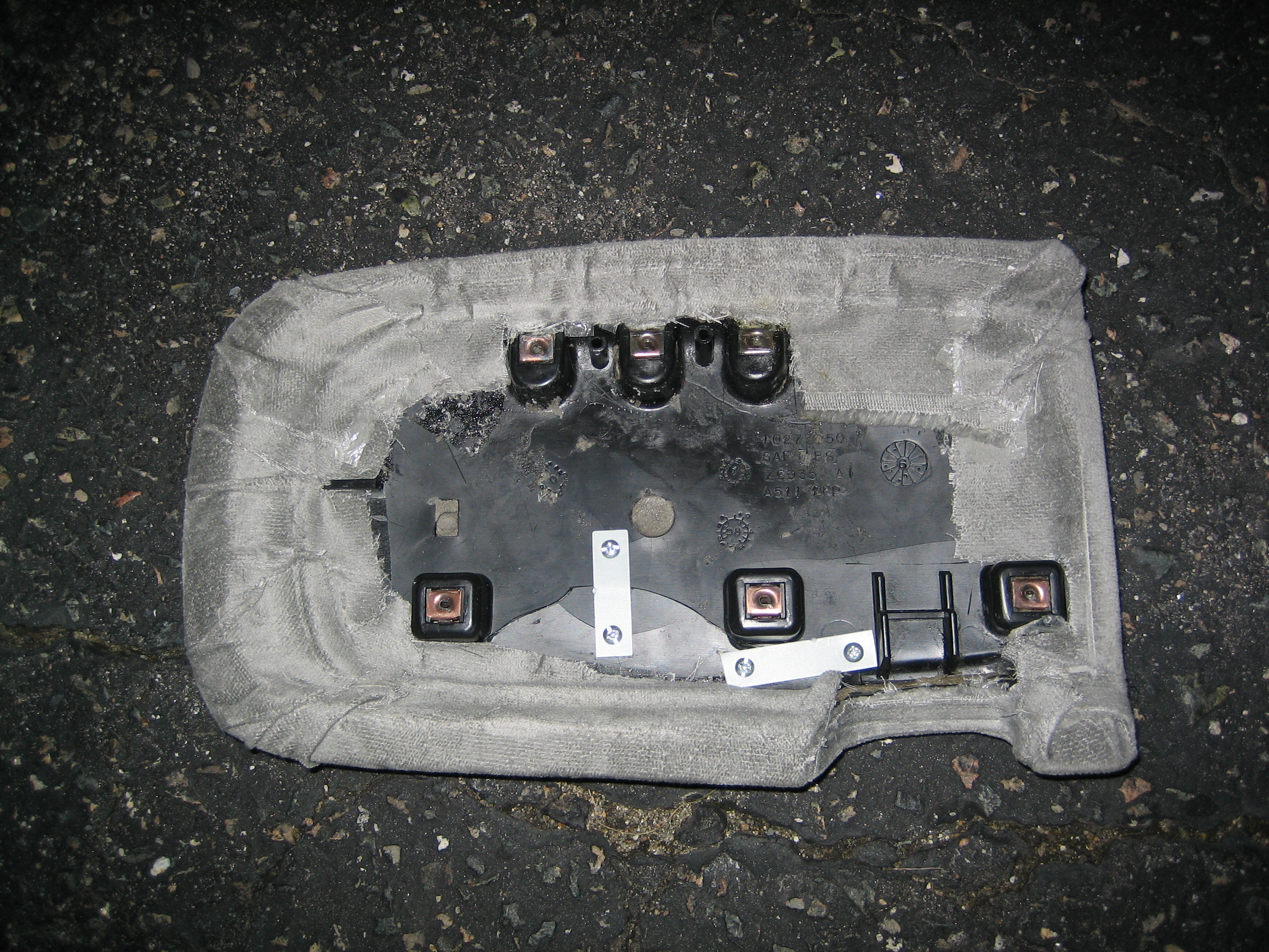

I went to take some pics of the metal reinforcement I added and found more cracks, so I added more reinforcement.
Here are the pics...
(Yes, its wrapped in silver cloth to match the silver cloth in the doors)
Before:
[small]
[medium]
[large]
After:

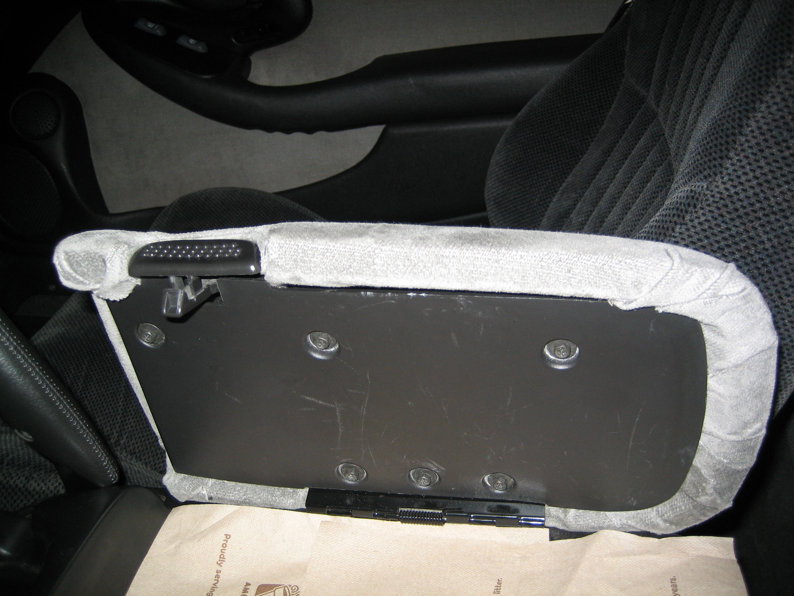

More metal strips, including one across the hinge-side screw mounts. The black lines on the metal strip are marker lines I drew when drilling/cutting. The metal screw mounts are still there under that metal strip. Most of the metal strips are cut up pieces of the metal knock-outs from PCI slots on PC cases. The larger strip is basically the same kind of steel, but from a bracket I had lying around. The short screws are actually from disassembled face plates from PC cases as well. These screws are normal pointed screws (unlike most PC screws, since these are from plastic face plates), but I still predrilled the holes in the plastic.
[small]
[medium]
[large]
[small]
[medium]
[large]

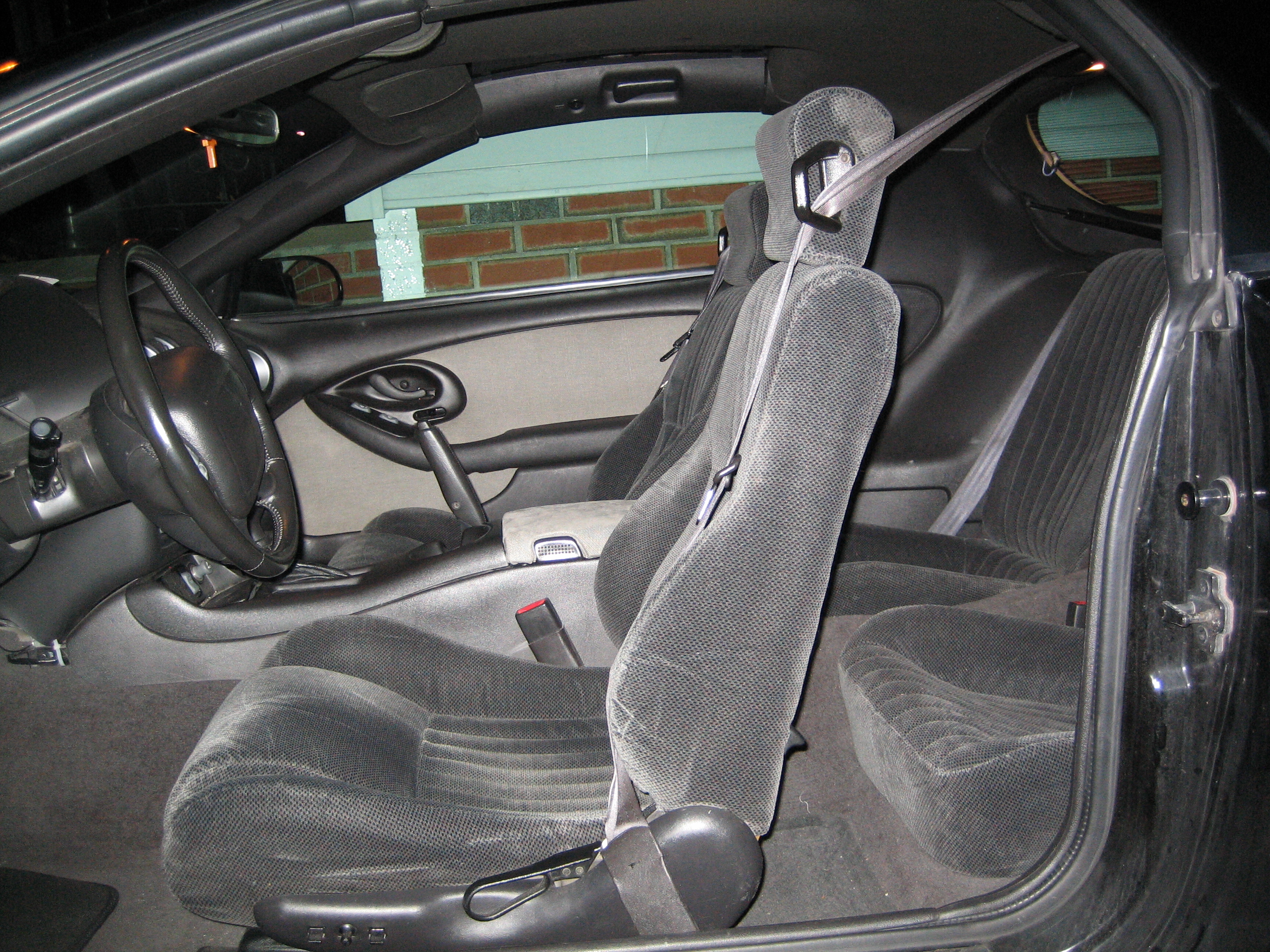

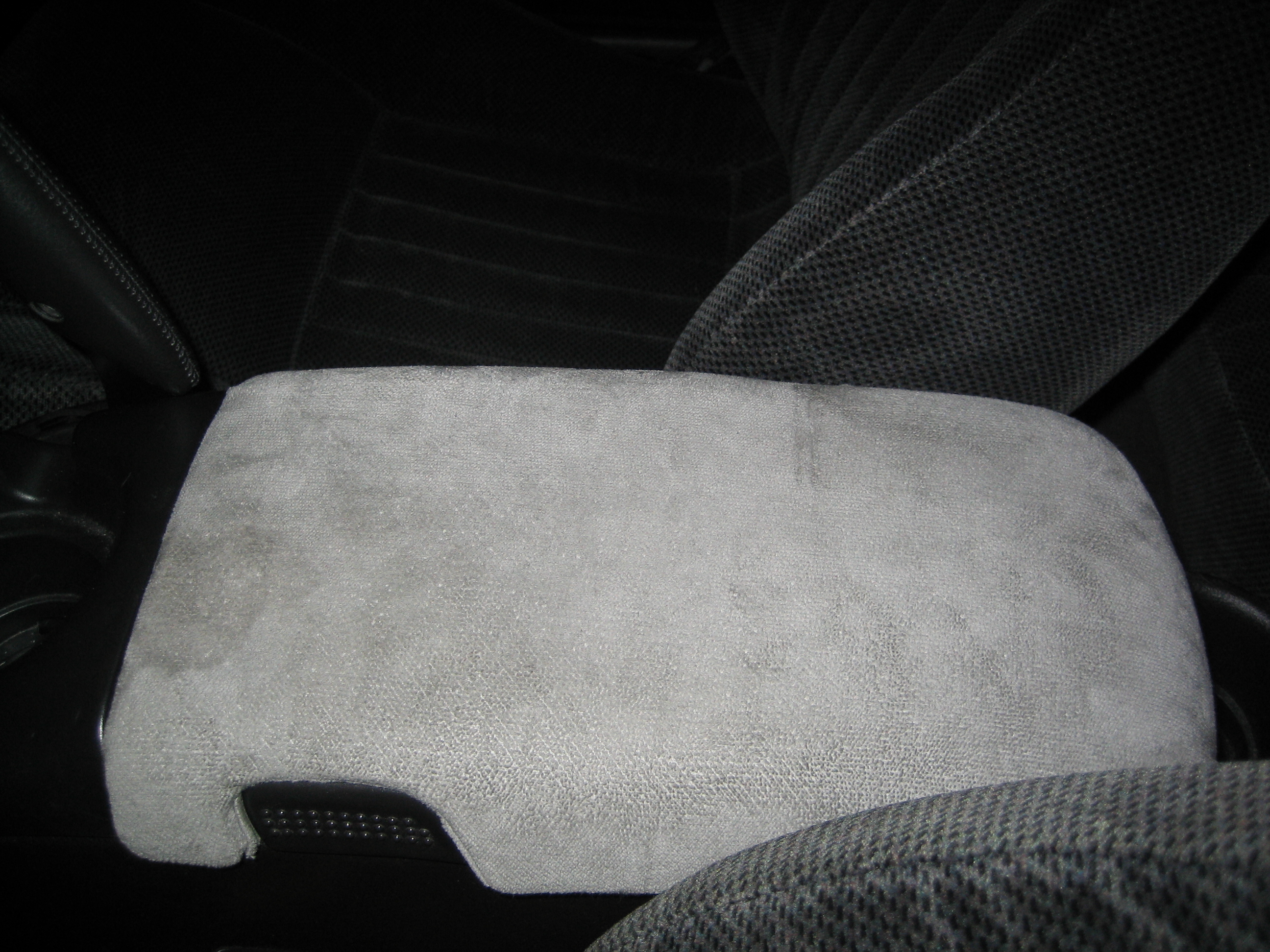

Some pics of it installed
[small]
[medium]
[large]
[small]
[medium]
[large]
[small]
[medium]
[large]
I hope this helps, and isn't seen as a hijack.

Originally Posted by VIP1
I can't quite tell from the pics if part of the plastic is missing or if that is just excess foam that poured over during the manufacturing process. If its just extra foam, you can peel it off and use metal strips with short screws to repair the cracked panel (that's what I did). Then to reattach it, I'd recommend removing the metal clips that pulled out and stayed on the lower panel. Then re-insert those metal clips in those square holes where they are supposed to be, then use 2-part plastic epoxy to secure them and re-build the broken area around them. The Hot glue may work here as well, but the epoxy would be stronger, just rough-up the surface first to ensure a better bond. When the epoxy has hardened, you can then re-install the cover like normal. That's a lot of "ifs", but its something to try.
My only comment is that the epoxy will be more brittle even if slightly stronger. I would definitely stick to the hot glue I suggested.
