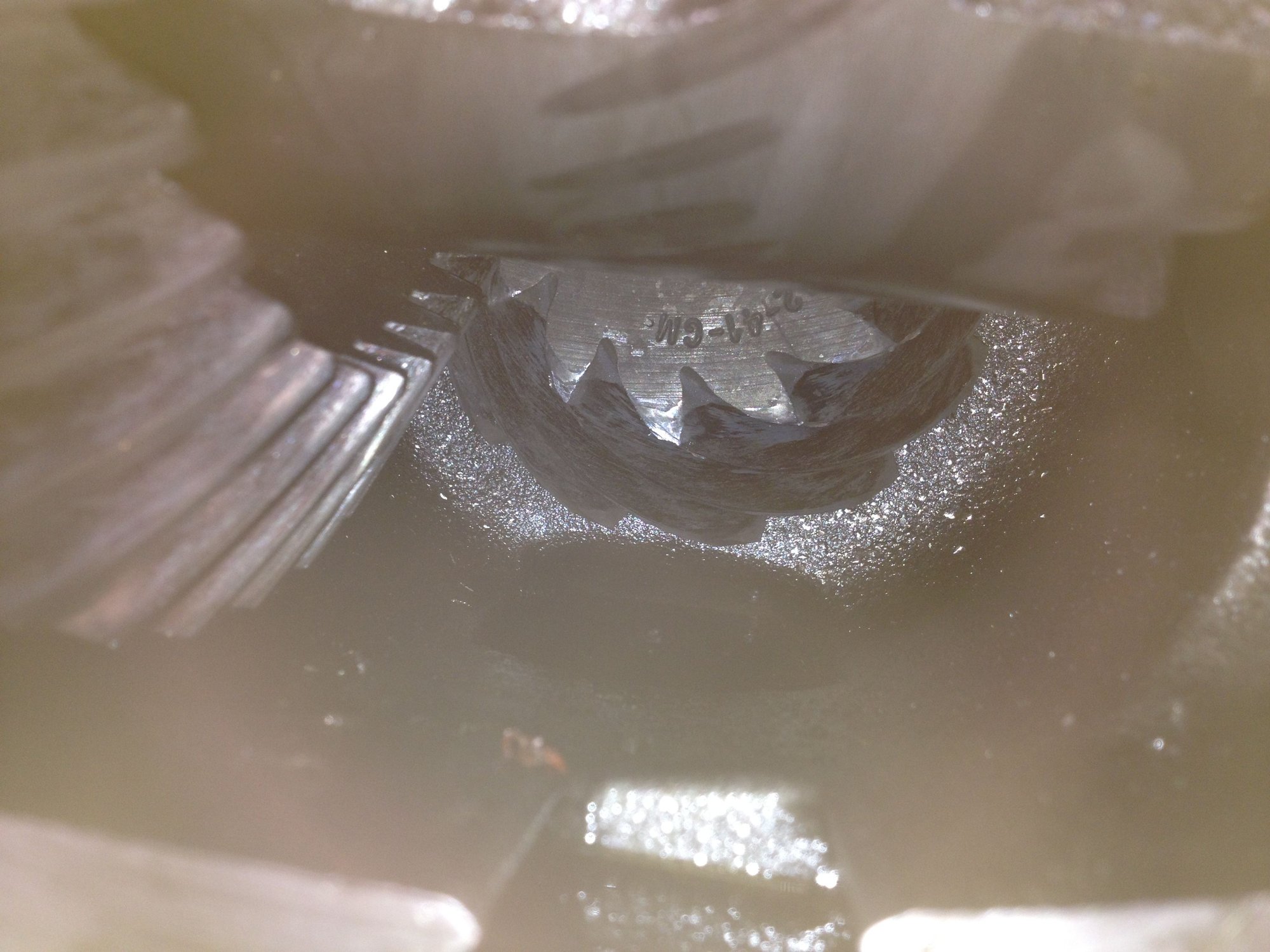

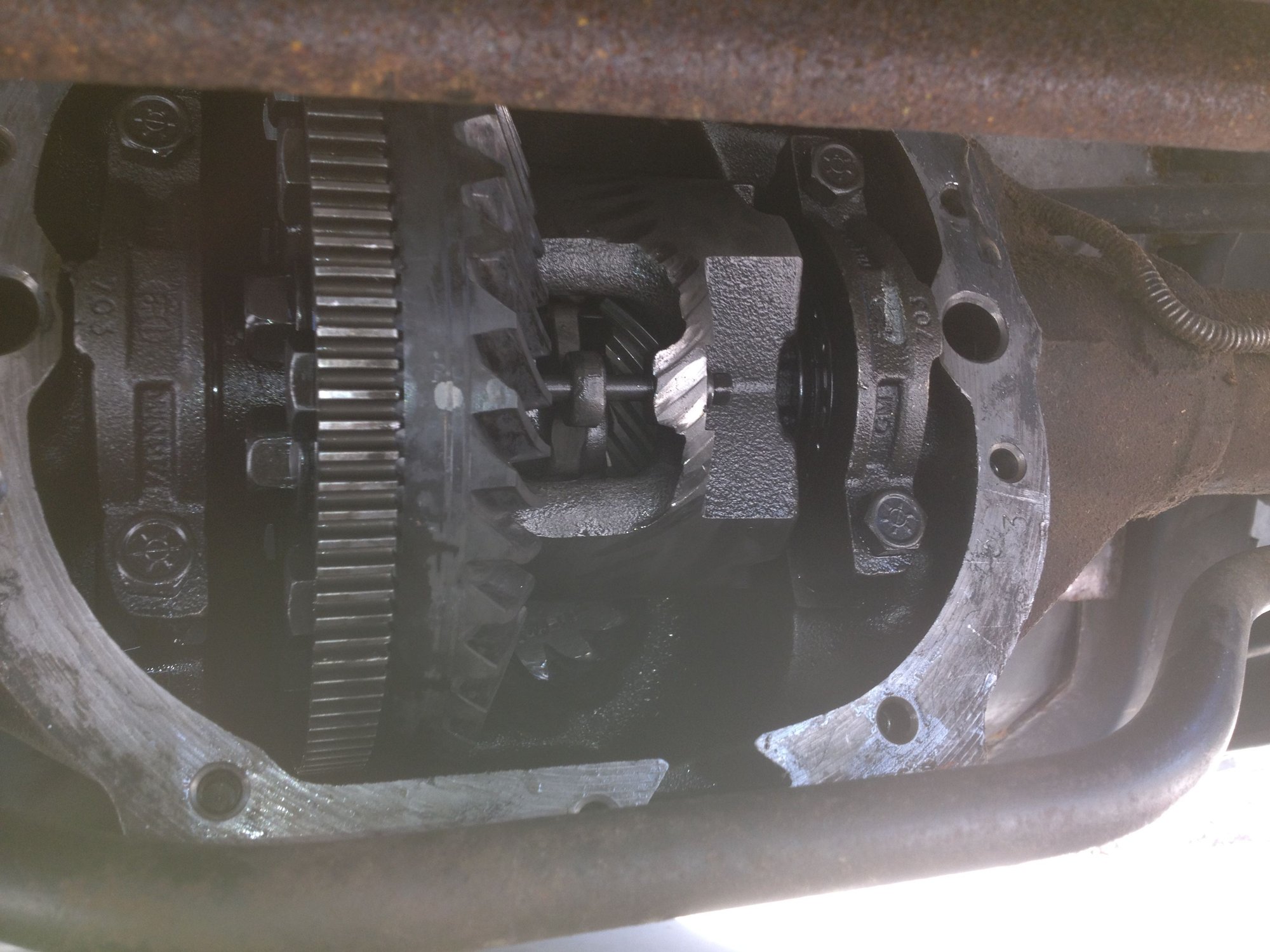

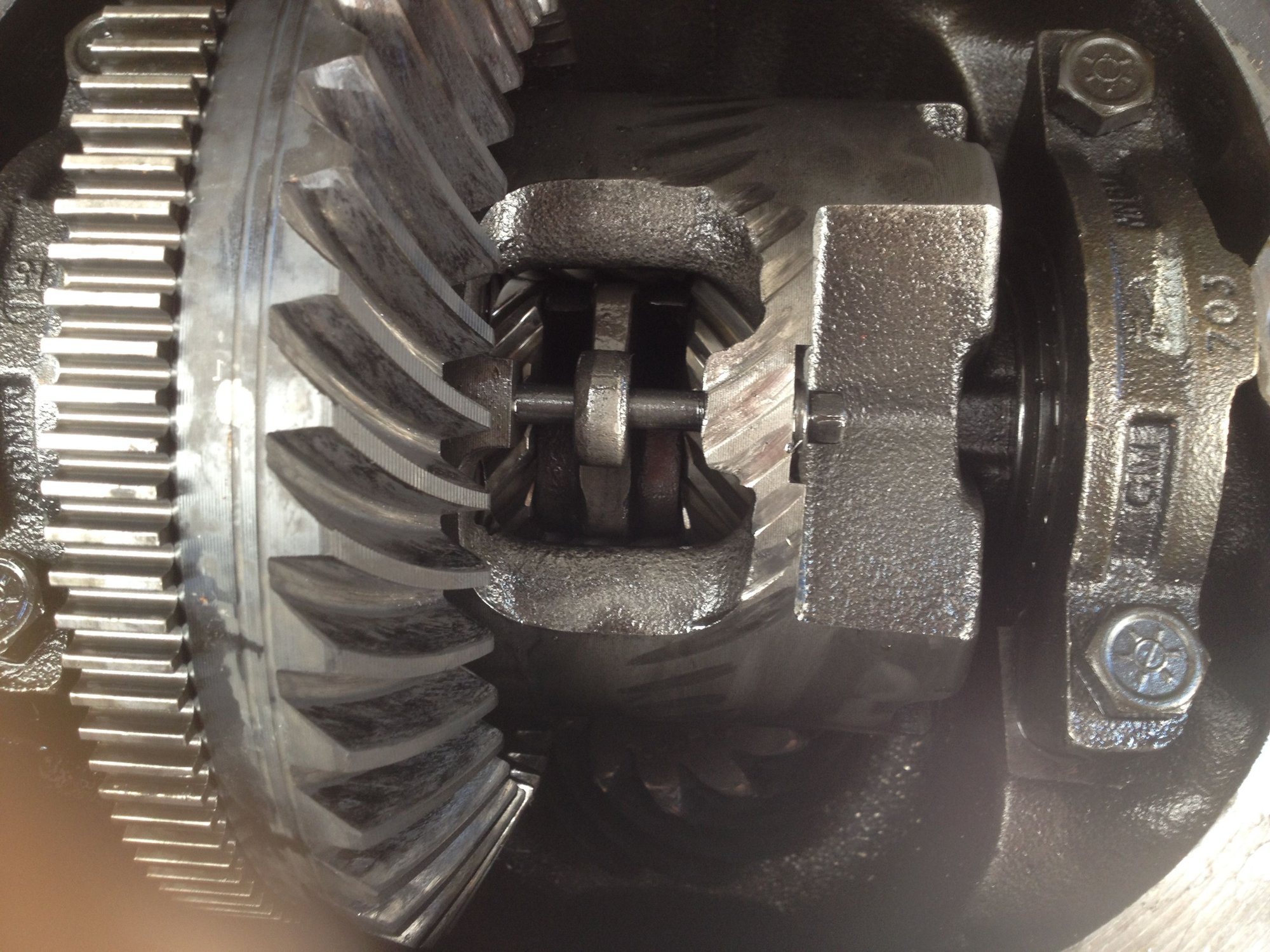

Ok. I've isolated the problem down the the differential. I cracked the bleeders to see if the brakes would free up, but the wheels still bound up. Removed the calipers, still bound up. Popped the differential cover and no gear oil My own dumb fault, it seems. Was too worried about all the stuff I might have messed up in the engine swap to think to check the gear oil. This is what I found:
My first question is: What the Hell gouged up the differential case like that? Second: is this rear-end salvagable? The pinion gear is a little chewed up but, other than that, I can't see anything that would cause it to lock up. There were a few metal shavings on the magnet but no chunks of gear or anything. Anybody got an idea? Did I eat a bearing or something?

The only thing I can think of is the pinion crush sleeve crushed more allowing more play and the pinion is hitting the diff carrier. Or it could be caused by remenance of a broken spider gear, or previous damage and lack of oil cooked the bearings.
In any case, looks like you'll need a new carrier and ring and pinion and a full bearing set. I wouldn't trust anything in there, especially behind a manual.
