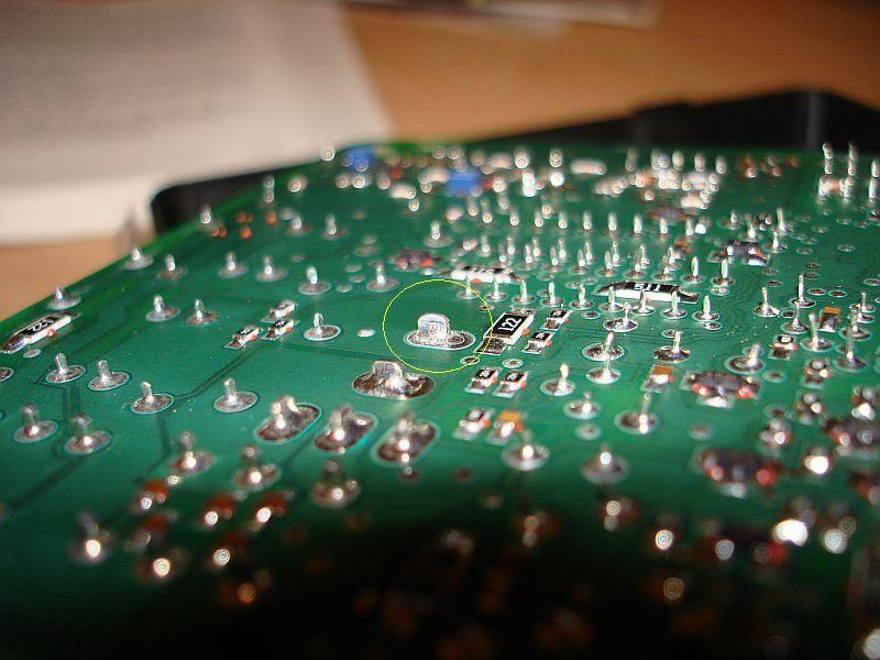

I knew i saved the picture showing where to solder the BCM

I just pulled the BCM & the bottom solder joint of the "T" formation was cracked & discolored. I'm going to get some desolder braid tomorrow and resolder the joint. It's nice spending a couple bucks to fix a problem instead of a couple hundred to replace the entire module.

Very often just re melting the solder and letting it cool will do it

I resoldered the BCM and my window still won't work. I'm starting to wonder if my radio problems were due to the BCM & the window problems were due to a different issue.
When I push the driver side window button down, I can hear the express down relay click. So I'm assuming my switch is okay. I guess my next move is to pull the door panel off and check the motor.
I may try resoldering the BCM again before tearing the door apart. My soldering experience is limited & having a cheap soldering iron doesn't help.

Another thing to note. After resoldering my BCM, not only has my radio stopped turning off & on intermittently, but now all of steering wheel radio control buttons work again. I thought they were worn out and needed to be replaced!
