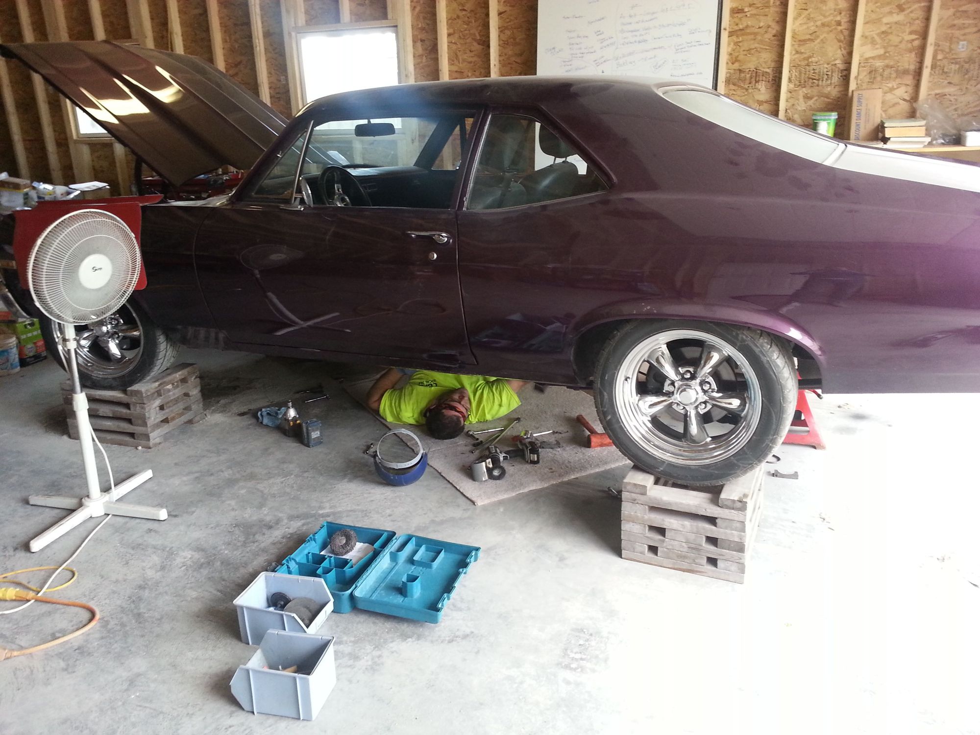

I made a similar wood stand. It gives me much greater comfort underneath vs jackstands. It is relatively light weight and you can easily change the height for your needs. Cheap too.
